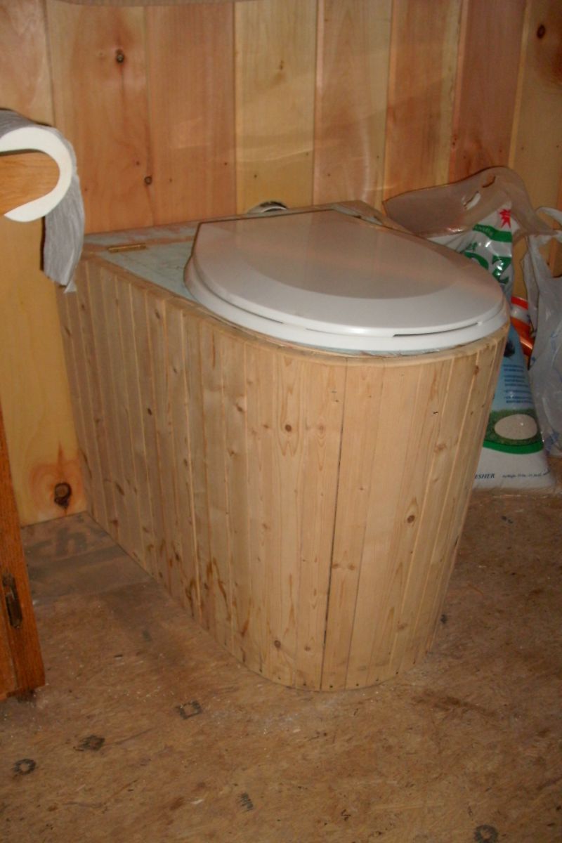

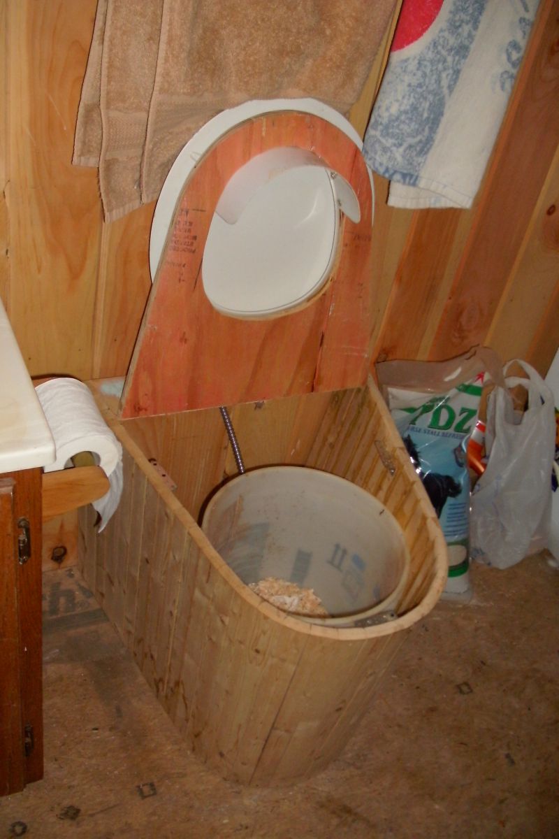

| rayyy Member
 | # Posted: 2 Apr 2012 09:29am Reply
 Don't give up,show him my setup.Work's fine.It's a custom built wooden cabinet that houses the ASB plastic containment vessel within.Let him pick out the seat of his choice at the home/hardware store.Everytime you go you add a 2 inch layer of pine shavings or peet moss to it.You dont see it,you dont smell it,you just know it's there somewhere.Once a week or so you take it outback,close your eyes and dump it into a compost bin.throw a flake of old hay over the top of it and walk away.Now open your eyes and your done!

 I agree, why spend all that money for touchy systems that don't always work as advertised. This Sawdust Potty is ideal and from what I read in the Humanure Book they are not illegal since they do not contribute to ground water problems. My compost pile is about a year old and beginning to "work" by heating up. Even so if it just sits there for a year or two it will decompose fine to spread on lawns or fields or flower beds. The only time you would be concerned about higher compost temperatures is if your planing to use it in the veggie patch.  Even that is safe if done correctly but care must be observed if you go down that path.
 Larry

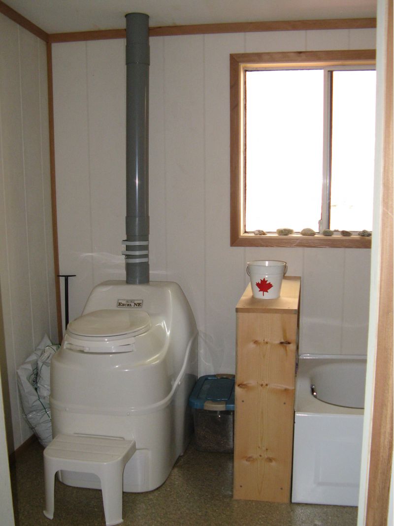

| drmargy Member
 | # Posted: 17 Apr 2012 02:38am - Edited by: drmargy Reply
 We have a small cabin and only two of us.  Guests are rare. We just built a bathroom addition and installed a self contained Sunmar Excel NE (non-electric) since we are off the grid.  A solar panel supplies the energy needed for a small fan in the exhaust pipe.  We have had it in operation since September.  So far, there has not been an odour problem. We are at the cabin most of the time and the amount of supplies needed is minimal. Our temperatures on occasion reach freezing in the winter, but because the unit is inside the cabin, the temperature is moderated.
 You can find more information about our system here.
 Margy

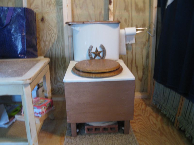

| Purplerules Member
 | # Posted: 14 Feb 2013 12:29am Reply
 We went the humanure system and it works great.
 We copied one someone made over in the gallery at Jenkins site.
 But changed it a bit by painting the base with copper paint to match with the sink that will be in the bathroom. Although it is hard to tell in the picture. The sawdust and scoop are stored in the tank which we purchase at on of the big box stores for $26. I just did not like the idea of the container of sawdust sitting next to the toliet.
 We were hesitant to go with the sun mar or natures head due to all of the complaints.
 Here is a pic of ours:

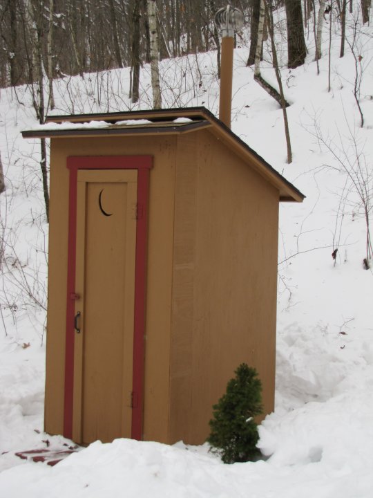

| ClimberKev Member
 | # Posted: 25 Feb 2013 06:34pm Reply
 Eight years ago our outhouse was condemned and I upgraded to a compact composting toilet.  Our cabin is mostly weekend use and I use solar power.  I re-wired the toilet with a separate plug for the fan and heating element and also added a turbine vent fan to the top of the pvc exhaust pipe.  We run the fan when we are there and occationally the heating element.  We use 100% sawdust and things seem to dry-out pretty quick.  We are in Wisconsin do I have to  empty the unit in November before things freeze up.  What we remove from the CT we place in a compost tumbler and mix with everything else.
 We do encourage our (male) guests to use the outdoors whenever possible. I also had to come up with a clever scheme to keep the wrens out of the turbine.
 It works pretty well for our set up.

 | # Posted: 26 Feb 2013 11:51am Reply
 Rayyy,
 I really like the woodwork on your composter.  I may have to imitate it.

 rayyy that is some nice woodwork.

 Rayyy, I like your design too. You recognize that foot placement is important and you rounded the front. I am not being patronizing. Almost every composting toilet is square in the front which means that you have to sit with your feet forward which is unnatural. There are so many over complicated composting toilet designs that the are doomed from the onset and give the entire industry a bad name. Composting your waste is actually very simple. The only complication if you want to call it that is that you need to collect it inside where it is convenient and comfortable and then take it outside to compost it. Regularly, that is at least once a week.
 To make that as easy and pleasant as possible the waste needs to be divided so that the urine can be poured out somewhere useful and the solid waste can be composted. Otherwise you are just pouring out stinky slop. If you keep the two seperated, then the smell is virtually non-existant with the feces as long as it is covered with some kind of medium; peat moss, sawdust or coir. And the urine can be treated easily enough with a small amount of holding tank deodorizer. I prefer peatmoss as a medium for covering the solid waste. You can easily dump the solid waste into a solar dehydrator made from a black plastic garbage can for the winter and then transfer it into the compost pile in the spring. It will look and smell like dirt clods if you use a C-Head. Or you can simply pour it into a 5 gallon bucket, treat it with chlorine bleach, seal it up and throw it in the trash. If that idea seems strange to you, take comfort in the fact that boat curisers are doing just that all over the USA and Canada with the Airhead, C-Head and Nature's head. If you cabin is located far enough into the woods and you don't have a problem with it, you can simply walk back into the brush and dump it out and the insects will make good use of it as nature intended. Ask a bear or a deer or . . .
