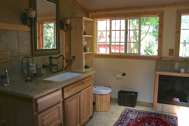

Composting toilets don't have to be complex or expensive to be very functional and beautiful. Here is an example.
scout100
