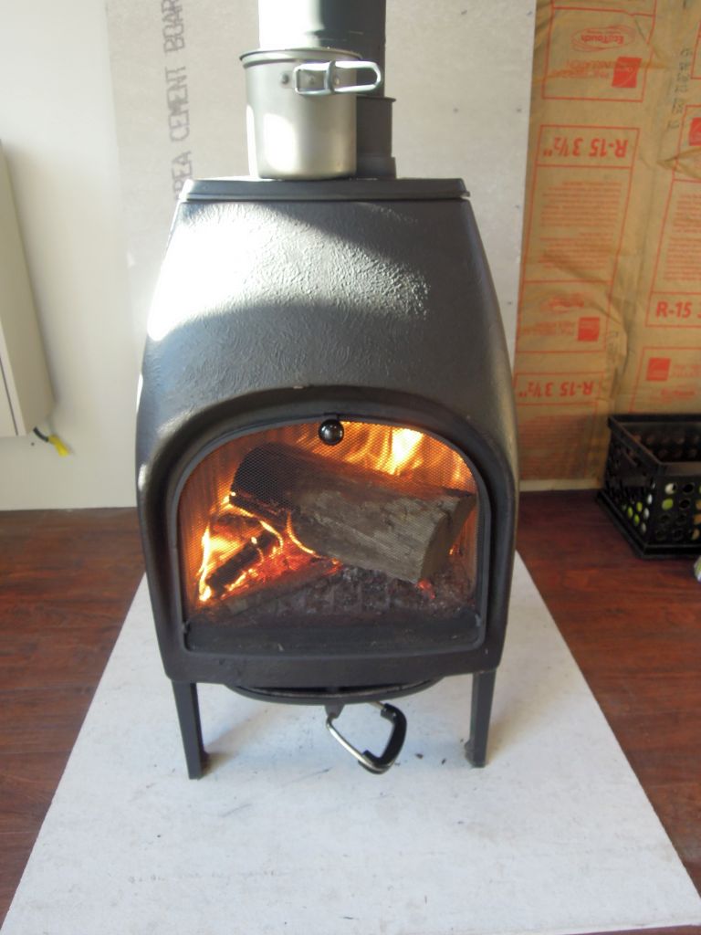

# Posted: 9 May 2013 11:38am
I found a Jotul Combifire #1 on CL last fall that is installed in my 16x12. It will burn you out of there unless you dampen the air way down once it gets warm inside. Not the most ideal (it adds buildup on the stove pipe) but for weekend use, it's fine. With a full load and the air damped down, there are usually just a few coals left in the morning to rekindle a fresh fire. I use a direct vent propane heater to keep the temps inside in the low-mid 60's at night.

# Posted: 16 Jul 2013 11:58am
Dillio187 I posted foto with your stove on my blog. Please, write me if you don't agree. I really like this stove. And my blog is not commercial. I added your name in signarture and this forum website.
To admin: I write my question here because on this forum i'couldn't find messenger system. Please, let me ask Dillio187, and don't delete my post.
Dillio187
# Posted: 16 Jul 2013 12:03pm
no problem FantasManis. I'm glad you enjoyed seeing the old stove in use still.
