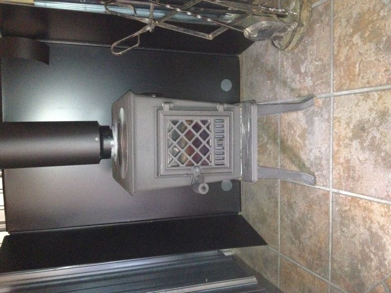

I was worried about getting roasted out of my really small cabin with a woodstove, but needed heat, so maybe you'll find my experience useful. About a month ago I installed a brand new jotul 602 in my 12x16 with a 13:12 pitch and loft. Right now I have r13 in the walls and rafters and just 1.5 of foam in the gable ends of the top. One wall of the cabin has quite a bit of glass, too. I used double-walled stove pipe from the stove to the chimney (almost at the peak) mainly to make code and manufacturer/industry clearance requirements. The dbl-walled has the benefit of not throwing off a lot of heat. I've only been to the cabin twice since the install, but so far it's been perfect. The stove is easy to regulate and it doesn't roast me out. I really think the key is the dbl walled stove pipe. I hope this helps.

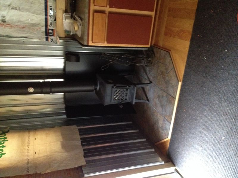

as you may know, the 602 allows you to go out the back or out the top. I went out the top. the top of the 602 extends about 1/2" out from the sides of the stove. the stove tapers in toward the bottom, as well. the distance from the back of the stove top to the back of the stovepipe is only about 1.5". so here's the detail of my setup...

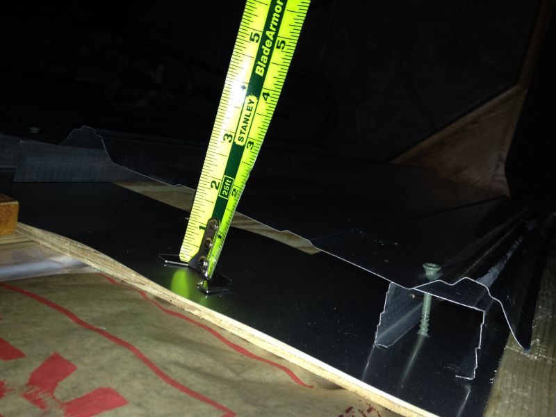

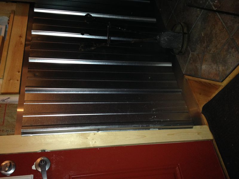

1/2" ply on the walls 6-10" inch aluminum flashing along the bottom of the walls and top of the walls metal studs (from Menards) as spacers running vertically - creating 1.5" airspace galvanized metal roofing screwed to metal studs a woodstove heat shield from northern tool. http://www.northerntool.com/shop/tools/product_200339121_200339121
the distance between the metal roofing "wall" and the top rim of the stove is only about 7 inches. so, about 8.5" from the metal roofing wall to the stovepipe. The day after I got home from installing it all, i found online that galvanized metal can give off some type of toxic gas when is gets above somewhere in the neighborhood of 365F. This made me nervous, so I bought the heatshield and put it in place behind the stove a couple weeks later. I placed it right inbetween the stove and the wall - about 3" clearance to both the stovetop and the metal roof wall. I was there for 5 days and had the stove going nearly non-stop the whole time (it was in the 30's most of the time). A few times when it was really burning hot, I felt the metal roof wall all around my stove area and felt the heat shield. The metal roof wall was never more that barely lukewarm to the touch. in most places it was cool to the touch. the heatshield itself was warm. the area of the shield closest to the stove was hot, but the metal roof wall directly behind it was not - much to my delight/satisfaction.
I think this works for a couple of reasons. rather than just a 1" gap at the bottom, I went with a 3.5" gap. I also think the design of the heat sheild with the very large holes along the bottom help. All that airspace at the bottom really lets air easily flow/move behind the metal.
i sure hope this helps you. feel free to ask any other questions.

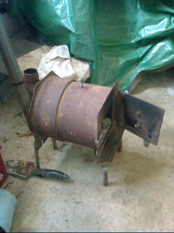

Quoting: neb heat up a small area? I have not seen his work, but I have a home made stove I made even smaller than that and it will heat my camper about 100 SQ. FT.. You would want to protect the back wall and floor from the heat. mine has a 2 IN. muffler pipe for a vent,, a 3 in. would be better .. in my opinion it would do what you want { heat the place up a bit so you can take a break from hunting or fishing, a few times a year .} If you were 2000 mile closer I would make you one it doesn't take long.
