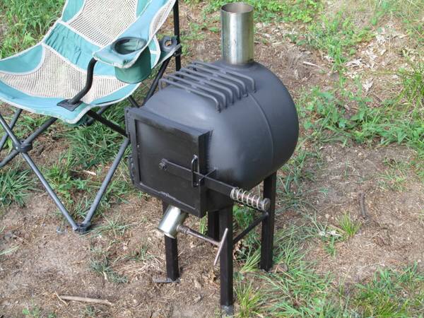

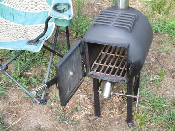

# Posted: 17 Jan 2014 05:31pm
Trying to tag this on to an existing stove thread. Found this stove on craigslist and thought it was a pretty cool DIY stove. Craigslist stove
|  Craigslist stove

Gregjman That looks like a nice stove and a bit bigger then the one I have. What is the price on that stove? I got a picture of the finished stove in my small cabin. Works very well and heats it up nice but need to fuel it more often then a stove that is bigger.
Gregjman
# Posted: 17 Jan 2014 07:25pm - Edited by: Gregjman
It's on craigslist for 200$. Looks like a 20# propane tank to me. I'm not so sure it's all that larger than yours?
Do all the blocks around yours help hold the heat well?

Quoting: Gregjman Found this stove on craigslist and thought it was a pretty cool DIY stove.
That looks like a cute little stove and one I wouldn't mind building some time. But the 4 feet going straight down making for a small footprint would make me nervous of it tipping over. I would put a bottom plate in it, with a air inlet from underneath, then line the bottom and side with some firebrick. I'd probably use some plate steel to make a flat surface on the top.
It would be cool if someone made a kit (door kit, pipe flange etc to make one, less tank.
