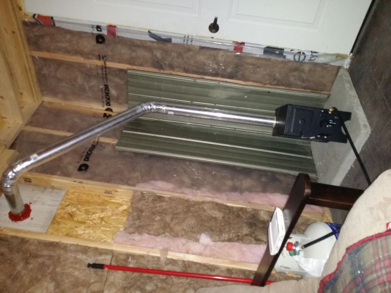

So I managed to get the heater hooked up in much the same fashion as 1300 did. It wasn't a difficult job and worked out great! Now I can work on interior siding, possibly even through the winter while I'm up there. Running the stove for just 10 minutes warmed the cabin quite well. I only had to use it for an hour or so before bed each night and then would turn it off while sleeping, then turn it back on to cut any chill in the morning. It got down to -5c this weekend overnight and it was cozy enough in the insulated cabin that I had to shed blankets. I didn't take any exterior pics but I used an aluminum dryer vent also attached to cement board and sealed with high heat silicone. Thankful for your successful install and post about this stove 1300! Very glad to have made this choice.

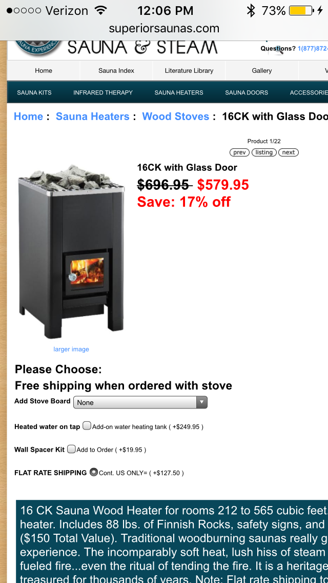

I wonder if this could be an option as a small sauna heater. It's only 26k BTU on high with both burners running? Are you using this to cook on as well? Are there removable round covers on the top similar to a cook stove where you'd place a pot or pan? It's a nifty item. I'd certainly consider surrounding it in slabs of stone or brick for thermal mass. That would cover up the flaking paint and add a bit of decoration to it. It would be nice if you could rig a water reservoir with a valve to it for hot water on tap. They might sell something you could attach to it directly.
I'm building a sauna soon on my deck. Plans to use a small wood stove though designed for saunas allowing water to be sprinkled on rocks which they supply with it. It could be used as a small cabin heater too, with the sauna rocks providing some thermal mass. Here's the stove... http://superiorsaunas.com/store/index.php?main_page=product_info&cPath=69_73&products _id=302&zenid=kmtig8830l9q1inra2btcuse13
