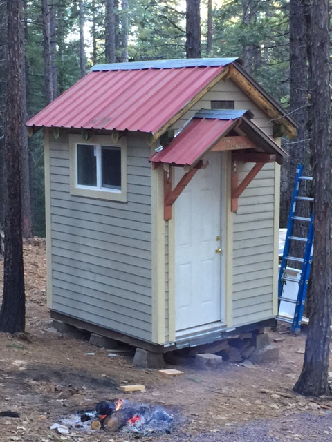

The L10 is 75000 btus, L7 41000, L5 37000. That's a big jump for the L10. I'm sure the L7 will do fine, but I may have to slow the water rate just a bit to get the heat up.
I've been thinking about using air tool connect couplings to connect the water heater on the back of my little shower house. I'll need to remove the heater at the end of each season and store it away, so I figured these would make it easier and would avoid potential problems with re-tightening threaded fittings year after year. Did a little reading and apparently air couplings are rated for liquid use and psi is not an issue. I just wonder if they can handle the heat, but it's not much. I also wonder if it's a good idea to use such a coupling to connect gas. Probably not to code, and if the building inspector sees that....
thanks Biscuits and Schmitty for your input. Schmitty- what is the valve or switch you had to deal with inside? Was it just stuck? Easy to fix?
thank you Pookie for the nice comment.
Gary O- I was afraid someone would point out that I (and Pookie) are really just arm-chair quarterbacks at this point, not having actually set the thing up. I resemble that remark.
Little shower house in the woods.
