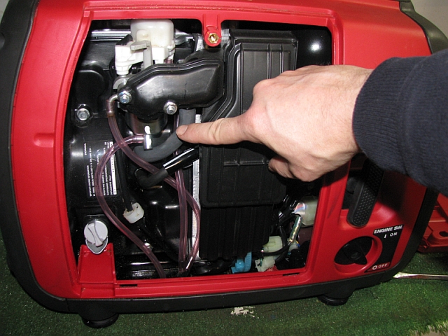

Be aware that in very cold weather, -15f and lower, the breather hose on these can cause carburetor icing. When it happens, the engine will begin to surge. If it is bad, eventually the engine dies. Honda sells a kit (heater) that prevents this. However, you can simply disconnect the hose from the intake and plug the intake to solve the problem. In the photo below I'm pointing to the hose.

Quoting: NorthRick Be aware that in very cold weather, -15f and lower, the breather hose on these can cause carburetor icing. When it happens, the engine will begin to surge. If it is bad, eventually the engine dies. Honda sells a kit (heater) that prevents this. However, you can simply disconnect the hose from the intake and plug the intake to solve the problem. In the photo below I'm pointing to the hose. Well.....this seems rather important
Quoting: NorthRick However, you can simply disconnect the hose from the intake and plug the intake with what?
# Posted: 30 Nov 2015 02:29pm
Quoting: Gary O plug the intake with what?
I have a vacuum test kit from the local auto parts store that has various fittings, hoses, and rubber caps. I used a rubber cap that fit snuggly on the nipple the hose was attached to.
I imagine you could take a short piece of hose the same diameter as the existing one and somehow pinch off one end and stick that on to the intake nipple to seal it off.

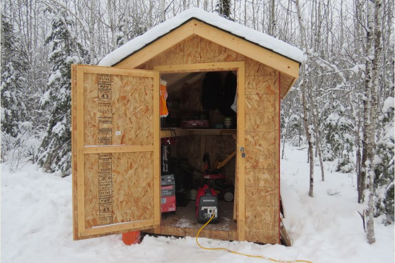

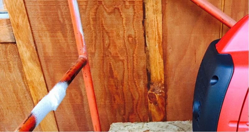

Had the audacity to take my baby EUI down to the well pump. The Ryobi 2200 strained, went to high rev, and shut down. Baby didn't even go to high rev
One alarming thing, we have gone from perking coffee on the stove to using an elect auto perk. When we turn it on, baby goes into high rev. This is OK, of course, but sends me into a brief dither every time. So I try to be the one to flip the switch so my mind can be prepared for it....
The Ryobi is still in Phoenix AZ warranty repair, gonna be another 3-4 wks I've been told. If...baby ever needs medical attention, the local hrdwr store is the certified repair outlet.
Bottom line; Honda just makes living off grid that much more doable.
I'll update later down the line, but imagine it'll be rather uneventful
