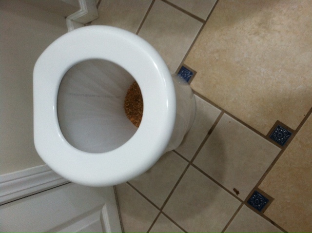

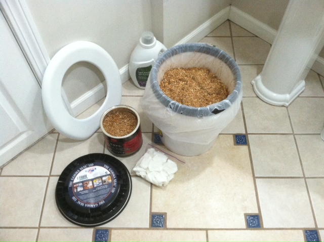

I had used the bucket in the past for camping but now i'm using it for an 18 month test I'm doing to see if it will extend the cleaning of my septic system. My septic is used by a family of 4 and needs to be pumped every 18 months and for whatever reason if I could not have it cleaned, or it failed this would be the system I would use until I could repair or to use this system at an off grid location. I'm the only one using this system and the solids and liquids are separated, tp is disposed of in the trash and urine is disposed of in a mulch pit.
The inside part of the system consists of a $6 Home D toilet seat, a dozen or so free five gallon buckets (one shown with about 3 weeks of contents), gamma lid seal (7 or 8 bucks), reused laundry detergent bottle for urine, recycled zip-loc baggy for tp and coffee can with saw dust. I considerer this part a portable system.
I use the gamma lid to seal the bucket because I'm using a minimal amount of sawdust to cover the deposit. I use one handful of sawdust, probably about a third or forth of what you would need without the gamma lid so there is some odor when uncovered but not that bad at least not to me. Sawdust takes up a lot of storage and is not always available to me and I like to see how small I can go with something or how little I can use while still being comfortable. Water use, solar the smaller the better to me.
I line the bucket with a plastic bag so I don't have to wash the bucket after emptying i just give it a quick rinse with water and a couple of drops of bleach and let it sit in the sun for the day. I start the bucket off with 3 or 4 handfuls of sawdust to cover the bottom.
I removed the hinges from the seat and repositioned the bumpers so it fits nicely on the bucket with no movement.
When done I lift the bag up from the sides and twist it up and place it just inside tot top of the bucket and twist on the cover. My inside system

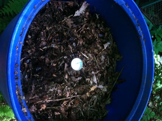

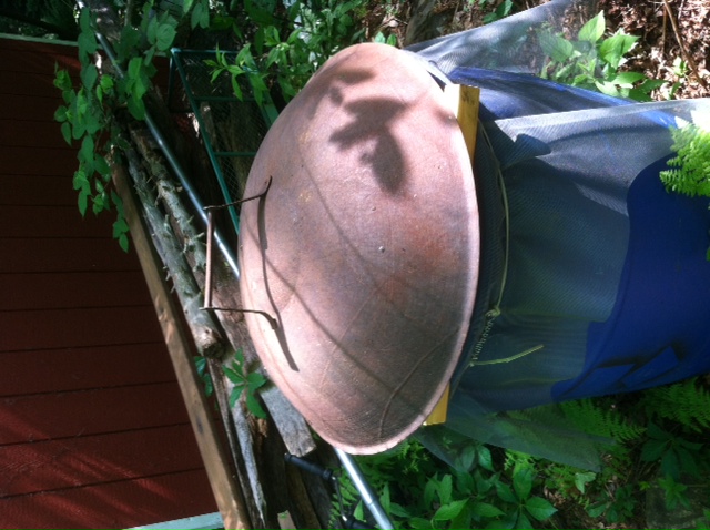

The outside composting consists of a two free 55 gal barrels (one not used yet) that does NOT have any holes in it. This is a self contained closed system and nothing leaches out of it (I have a regular compost pile about 15' away), window screen picked up at a garage sale, old telephone wire attached to a spring, an 18" composting thermometer ($30), compost crank aerator ($55) and a heavy metal cover from an outside fire pit that I had that sits on a couple of 2x2's for air and ventilation. The cover is a perfect fit extending an inch or so beyond the barrel. Very important to keep it covered to keep rain out. Contents should be damp, never wet. cold weather storage
|  Covered outside 55 gal barrel
|  Screen covered
|  Contents June 1, before aerating

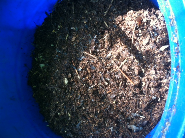

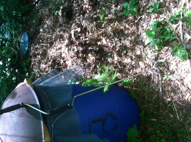

after being thoroughly aerated a depression is made in the center with the crank aerator and the new bucket dumped in
covered with 6 or so inches of new shredded leaf material. I shredded last falls leaves and will last me to this fall. Inside I use sawdust outside I use leaves for the carbon ingredients.
The hand crank is shown as well as the shredded leave pile. Takes about 15 minutes start to finish once every three weeks. I don't share this crank with my regular compost pile.
No odor at all. Several weeks ago I noticed an ammonia smell when I was aerating...this will happen if there is not enough carbon (leaves and sawdust), if its too wet, or not enough oxygen. It wasn't wet just damp so I added more leaves and aerated it well and covered with more leaves. When I added the latest bucket it was a nice earthy smell, no ammonia when I aerated.
The temperature has not exceeded 100 degrees...I was hoping for 120-130 degrees. The barrel sits in a wooded shaded area...next I'll cover the barrel in black plastic and move it to a sunny location to see if it'll heat up more. It's breaking down but not getting as hot as I'd like. If that doesn't happen that means not enough nitrogen, I believe. after being thoroughly aerated
