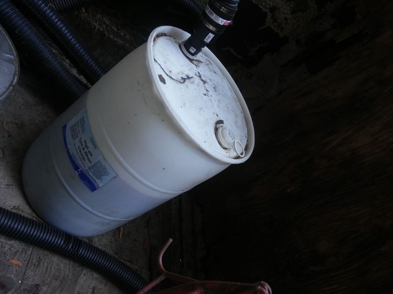

I thought I'd update about the bucket to barrel system I use since I commented about it earlier in the thread.
I still use the 5 gallon bucket to 55 gallon barrel system. Barrel 1 was filled by November and I started Barrel 2. I'm the only one in the family using this.
I brought the barrels into my under house garage in November so composting would continue throughout the winter...Too many months of lost composting time if I didn't.
Barrel 1 contained only my solid waste and sawdust and took about 21 days to fill the 5g pale and about a year to fill the 55g barrel.
In barrel 2 along with my waste I add about a half gallon to a gallon of kitchen waste per day and use leaves instead of sawdust for the carbon. I fill the 5gal in 9 days. I used a small mulching mower that I have to chop up the leaves.
Sawdust vs. leaves...I like leaves better but it is more work chopping the leaves but I don't have a good source for the sawdust and I can use what I have and I like that. I also like adding the kitchen waste daily. I had a separate outside compost for kitchen waste only but was a pain to go out there especially in the winter and it was also visited by animals often. I think the temp gets hotter with the added kitchen waste. I haven't had to add any water to the process.
I hadn't been paying attention to the temperature in the garage until recently. 39F inside 11F outside. In barrel 2 the temp was 134F in layer of recently deposited bucket. 110f about 18" down in barrel. Barrel 2 is about 3/4 filled.
Barrel 1 is aerated occasionally and will sit 1 more year before it is used and the contents look and smell great.

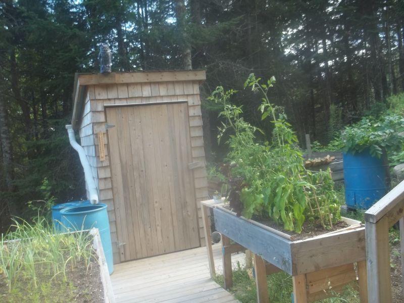

# Posted: 24 Apr 2017 03:05pm
Amazing as you watch this site and people's experiences, how your own can get better. I to have been doing humanure and wouldn't change to any other system. No odour from any of the three throne rooms - one in the main camp and two outside with views. I use a double bin compost and use leaves as my main brown material. They are to the right of the shed in the pic - which keeps the cover material dry and is storage for garden. Two raised beds, a potato barrel, cukes in a raised box and strawberry, black berry and raspberry patch to the left. I found last year that one 45 gal barrel doesn't meet my needs so will put another in tandem - using roof drainage off the small shed. I plan on using the compost mostly on the raspberries and blackberries but likely will also use for the rest of the garden. Nice and simple and many parts of this set up came from this site. Great everyone sharing their successes and lesson learned.
Jim in NB
# Posted: 24 Apr 2017 03:06pm
Forgot to put the picture in
# Posted: 25 Apr 2017 12:33am
Quoting: Jim in NB
gorgeous

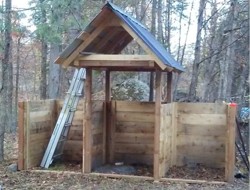

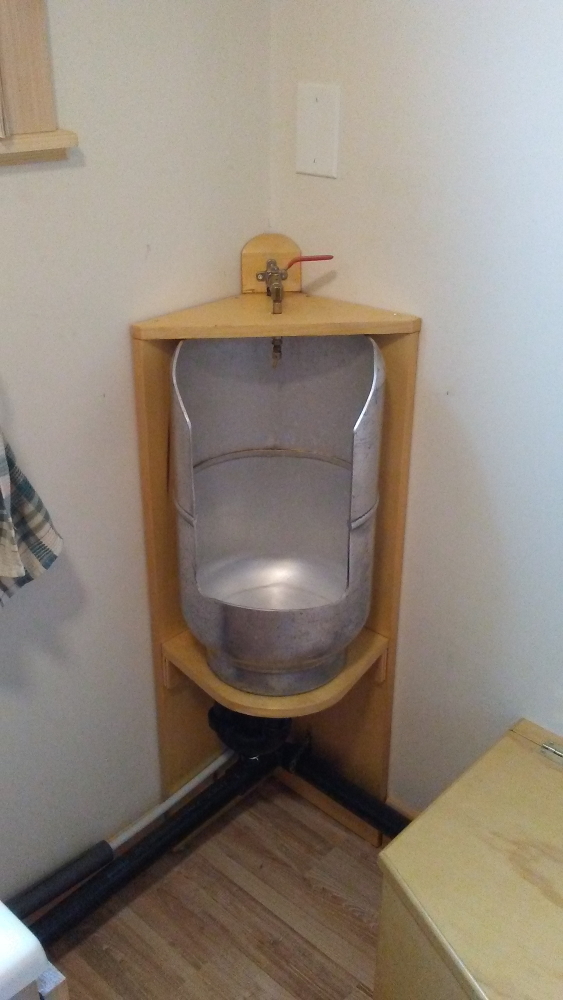

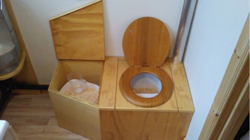

Dry Sawdust Composting here, based off the Humanure Handbook. Urine diversion in compost toilet accomplished by using a "We Pee Urine Diverter" and HepVo Waterless P-Trap. The Urine Diversion goes into the Grey Water system, which takes the water from the tub/shower & sinks as well.
We-Pee Diverter:
We-Pee
We-Pee Site
HepVo Waterless P-Trap:
HepVo
HepVo Site
ATTACHED:
The Compost Toilet, using only Pine & Softwood sawdust & chips, NO CEDAR ! Never use cedar Other organics like coffee grounds, veggie bits (no meat/bones - animal prevention) get added separately to the compost pile.
The Urinal, made from a 30 Lbs Aluminium Propane Tank - type used for Forklifts.
Composting Bin. Built with Pressure Treated 4x4 posts and 1" thick White Cedar Planks. Each section is 4'x4' with the centre covered section for the Straw which is used as cover. NB Straw, NOT "Hay".
TIP: When I add my "deposit" I also add one shovel full of black topsoil on top and then cover. This accelerates the composting process and helps break stuff down. Was suggested by another Humanure person in the region and it really makes a difference.
Been using this for a couple of years now and it's simple, easy, minimal fuss and no problems at all.

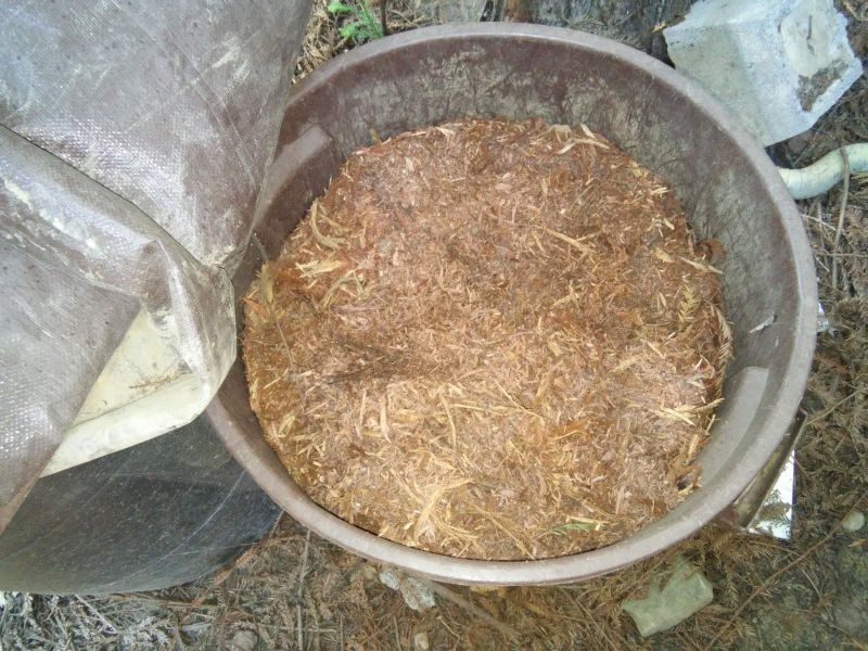

# Posted: 6 Apr 2021 05:13pm - Edited by: gcrank1
So, Im 'inspired'....
My version will be simple and cheap. What a surprise...
well, I want to not be heavily invested in the digestive apparatus.
A posthole about 3' deep (already there in the existing pit toilet)
A large garden center hd plastic plant pot c/w large drain holes already in the bottom will be set onto/into the hole. I did elongate the drain holes down completely to the pot bottom. These will be covered with a good layer of pine needles of which we have in abundance. The 'solids' will collect on the needles, the liquid will run through, out and down into the pit to leech in. No diverter required.
After each use the deposit will be covered with a trowel scoop of dirt.
It is only the 2 of us and a very rare guest maybe. After it is about 1/2 full and thus still manageable for a 'Sr' I will pull it out to dump into a 20ish gal black plastic compost bin somewhere more remote and in mostly sun to stir and decompose more.
Whadayathink?
# Posted: 6 Apr 2021 05:42pm
I'm sure that will work fine gcrank, but the big value in urine separating is you avoid the odour that comes from having them mixed. If you find it smells more than you care for, diverting the liquid is the solution to that problem.
# Posted: 6 Apr 2021 07:04pm - Edited by: gcrank1
The 'hole deal' is topped by a box pedestal with a proper seat and lid.
The plant pot is beneath and over the hole.
The urine is 'automatically diverted' by gravity straight down into the pit with its own lime/sand soil and pine needles. It has been an in use pit privy with no odor, no bugs, etc. even as a 'dual use' facility. Our regimen has been to toss a trowel of winter wood ashes on top once a day. We used this method successfully at our last cabin since 1983.
With this planned repurposed plant pot as an (pun intended) upgrade the pit should last forever (I am not fond of the idea of digging a 4' deep hole with a post hole digger every 5-6 years at my age.
The urine will be gone the solids will dry out, mixed with the soil and dumped in the compost bin it will be digested, no odor, no contamination.
