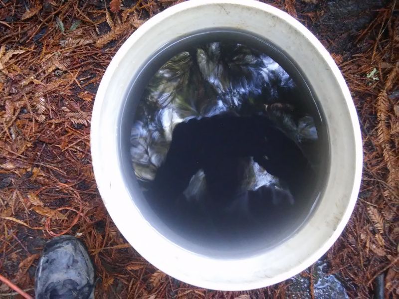

Now that I have hot and cold running water it's time to start using the well. It was there when I bought the property, housed in a small shed. Measured about 50 ft. deep, water was at about 10' yesterday. Took a gander inside, yuck. The pipe goes down some distance, don't know how far. I did get one of those home test kits a year ago and it tested clean except for high minerals, and water I have pumped out before was brownish.
How do I proceed? Does it need to be scrubbed or otherwise cleaned? Bleach? I have pumped out of it before for watering, it empties out pretty quick but fills back up in a day.

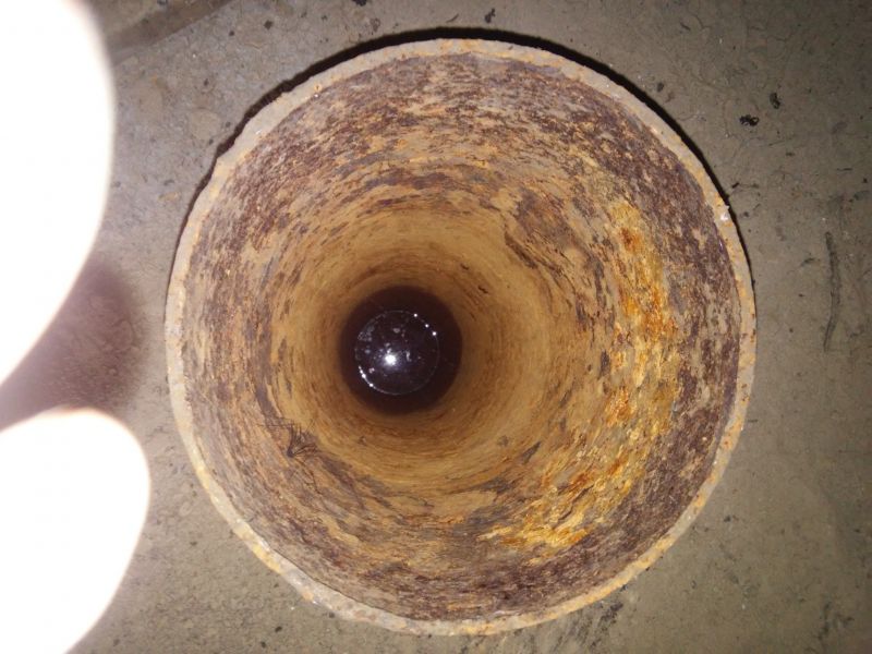

Bleach in wells is controversial. I recently had a pump installed in my new well, I asked the well contractor if I should put in bleach, he said no. "There's nothing down there that will hurt you" he said. Which is true, but whenever you put something into the well like a pump or pipe you stand the possibility of introducing bacteria. Any health department will tell you to use bleach because that is "standard procedure" and they have to recommend it. With my well I flushed it til it was clear, no bleach, and began drinking it. No problems.
With a shallow well such as yours, there is greater possibility of contaminated surface water getting in. But this, if it happens, will be a persistent thing and a one time application of bleach won't change that.
I would consider flushing it repeatedly with no bleach. Use bleach to be on the safe side, and if you do, flush the bleached water through the entire plumbing system to clean it all out, then continue flushing til the bleach is gone.
The rust on the steel casing looks bad but is not a health hazard. I suggest you leave it alone and just flush the well. If you are getting a lot of rust particles in the water you can put on a filter. I'm getting a few rust particles in my water from my new well casing, or it might just be leftovers from the manufacturing process, anyway not enough to matter.

Yesterday I started the cleaning process. Used my submersible pump (23ft head lift, doubt it will reach my tank)
http://www.harborfreight.com/16-hp-submersible-utility-pump-1350-gph-68422.html

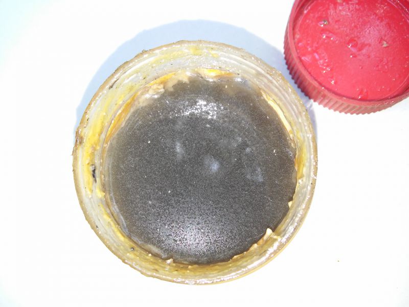

to pump 150 gallons out of the well into 50 gallon barrels. Water level started at about 10ft., got down to about 40 and stayed there with still a decent flow out of the garden hose. So I was unable to pump it dry. Poured a gallon of bleach down and capped it for now.
Water got a bit cleaner but still black (ignore the peanut butter). Going back out in a few days and I guess pump it down again. On the bright side I am going to use the 150 gallons to wet down my dirt road .

# Posted: 20 Oct 2016 10:52am - Edited by: paulz
Update on this and a quandary:
My well has sat capped since shocking it and pumping out about 1,000 gallons back in July. The water looked pretty good after that and I thought I was ready to use it when I got a pump system in place...
So this week I pumped out about 200 gallons and was surprised to find the water again very black. When I started pumping the water was about 10' below ground and dropped as I pumped about another 10-15'. The well is 40' deep and I pumped from just below the water level, nowhere near the bottom. In a white 5 gallon bucket full you cannot see the bottom. Don't know what it is, just dirt I suppose. The ground in this are is dense forest valley floor, not rocky, looks like dark planting soil. As in the photo below.
Does a well have to be pumped more frequently than every few months to get clean water?

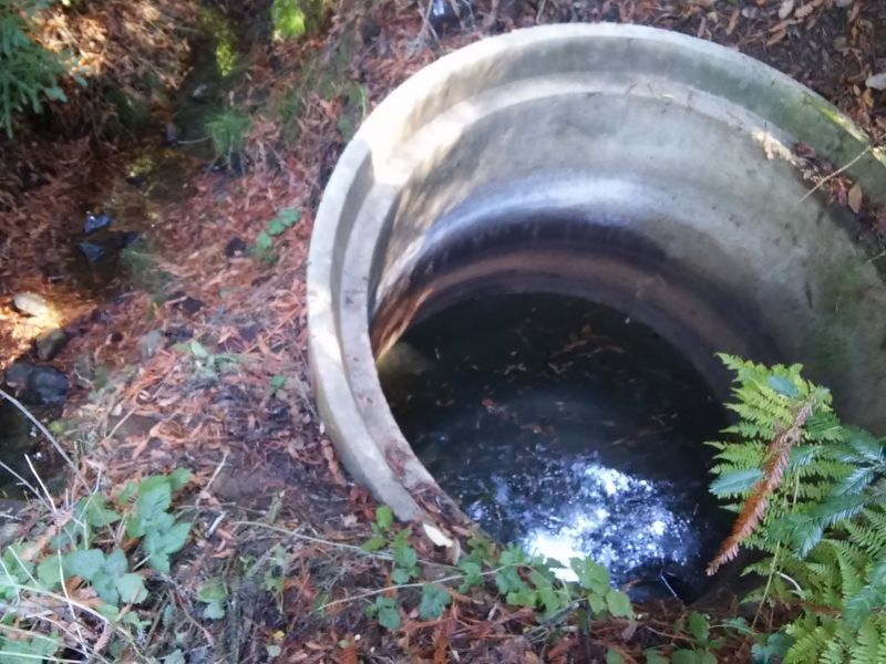

Disappointed, I decided to take a look at another option on my property another 50' further away from my cabin. This thing (cauldron?) has been there who knows how many years, probably 60 years when a house occupied the property. It's about 6' in diameter and goes down 20', which looks to be a bit below the creek floor off to the left. The creek is dry now (but will soon be flowing for the winter) but this thing always has water in it. It has sat uncapped. I pumped 300 gallons out of it and the water was a lot more clear.
Would this be a viable option for a water source?
# Posted: 20 Oct 2016 04:24pm
The water from it may be cleaner but because of its size it's more likely to get contaminated from above. You'd need a good cover that keeps insects out.
Your well may produce cleaner water if used more frequently. I have the same issue with my new well, the water is cloudy at first after not pumping for weeks, then it clears up. I think water comes into it from two directions, above where there is clay, and the bottom which is in bedrock. The water from the clay is cloudy but seeps in slowly. The bedrock water flows at a high rate and is crystal clear. When sitting for weeks, I guess enough of the clay water gets in to cloud it. Once I get there and flush it for 1/2 hour the water is very clean, coming from the bedrock below. The next day, after the flush, the water is still clean. It's only after it sits that its cloudy.
As well, because your well sat for a long time unused, perhaps it collected sediment in the well and in the surrounding soil. Daily use keeps this flushed. I'd say keep flushing. Consider a lower flow rate pump to guarantee you don't ever empty the well, and you can leave it flushing without worrying. I bet it will clean up

Paul, I believe that shallow well (The Cauldron) is Ground Water and I would not consider that potable and certainly would not drink from it... Watering flowers or bushes sure but not food crops !
It's not unusual to have a well get foggy, if it isn't used regularly but that usually takes a while. Once pumped it should clear up again and be safe to use. I would flush & shock again before full use and then keep using it. Some silt in a low use well is not unexpected and sediment filters can cope with that nicely... Like the Rainfresh Cartridge Units.

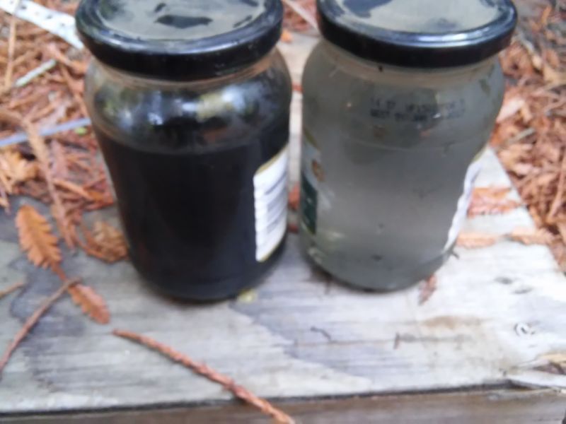

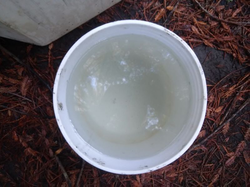

Thanks guys, good ideas. Ok, back to the well. Today I started by pumping from just under the water level, about 10 feet down. Water came out very clear. Then I went to 20 feet and it got darker. Here it is from 30 feet. Went to the bottom, 40 feet, even worse. I collected some in pickle jars to perform the tests you suggested. I then continued to pump out 30 gallons from 30 feet and it remained dark. If I continue pumping it may clear up some like back in July but we don't use that much as part time cabin dwellers and I'm afraid it will just darken up again.
# Posted: 22 Oct 2016 01:55am
That's interesting that it's almost perfectly clear at the top and so dirty not so far down. I agree with the idea of trying to determine what the black is and where it's coming from, but ultimately you need professional analysis done, or at least advice from a local person with experience in local wells. Call the local health department and see if you can bring samples to one of their inspectors, he probably knows cause he's seen it all. Alternatively, take it to a local well driller.
I bought a one gallon clear glass bottle to test the clarity of my water. Looking through it at the blue sky seems to be the best indicator of clarity (or 'turbidity',as they call it). But what I found was that I was, as much, observing the clarity of the glass itself which is not perfectly clear, it seems to have a slight tint. The clear water from the well seems to be clearer than the glass.
# Posted: 22 Oct 2016 06:44am
Paul, I am concerned with that water. Clear on top, but not as you go deeper and that looks black from the pictures.
The black is often caused by the mineral manganese, a naturally occurring metal that can cause health problems if ingested in large enough amounts over a long period of time. Especially at risk are babies and people with liver problems.
An odorless black tint to water is usually due to manganese. Manganese behaves a lot like iron does except it oxidizes a lot slower. Water stored for a couple days or more will turn black if there are high levels of manganese in the water. Manganese is more often found in groundwater than in surface water. Sometimes it wont be noticeable in the water. It will however be noticeable as a black stain on appliances and reservoir walls.

# Posted: 22 Oct 2016 05:45pm - Edited by: paulz

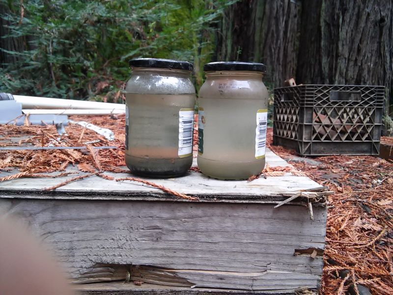

Thanks again guys. Lots to digest but just wanted to add these two photos. The two jars were clear and clean, the dark one came from the dark bucket and the other the clear bucket. First photo was right after filling them yesterday. Second photo from today, already the dark jar has settled quite a bit. I will try more of the testing suggested.
Oh, on the smell, smells like sulfur.
# Posted: 22 Oct 2016 06:45pm - Edited by: DaveBell
1. Your well hit a coal seam.
2. Your well hit oil. (the black stuff isn't floating so not likely)
3. Someone dumped something in the well.
Dump most of the water out then dump the black stuff into something and let it dry out. Then you might be able to tell what it is.
What state and county is this located?
# Posted: 22 Oct 2016 07:12pm - Edited by: DaveBell
Maybe someone dumped activated charcoal (or plain charcoal) down the well to get rid of the sulfur smell?
