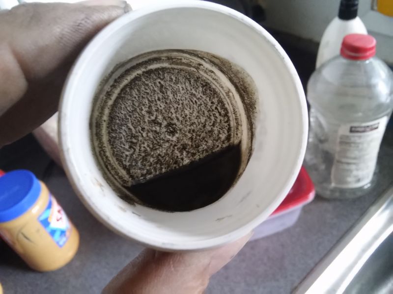

I bought the place in 2009 I think, never put anything but bleach down it. Before that it had not been habitated since 1966 when the old house was demolished. A developer and possibly some pot growers might have done something with it. When I got it there was 6" white perforated PVC pipe inside the iron casing (top photo of this thread) that went all the way down to the bottom. I took it out because the sump pump I had at the time did not fit inside it. Maybe that's a clue to something?
I will let some dry as you suggested and try and see what it is. Thanks.
# Posted: 28 Oct 2016 06:31pm

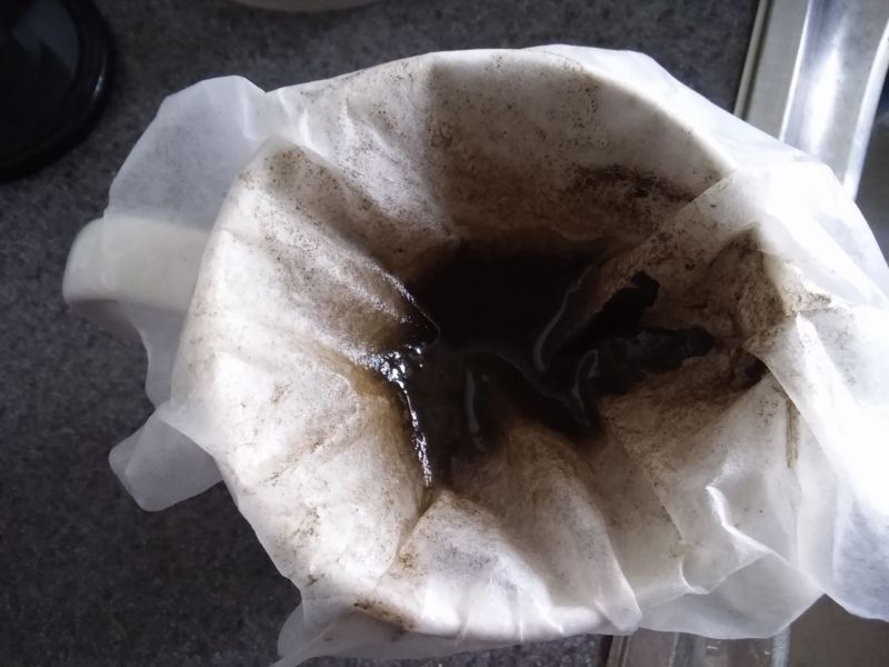

OK I have let the black stuff settle, then ran it through a coffee filter which captured most of it. Poured bleach in some, no affect. Put a pencil magnet in it and got a small wet blob but maybe no more than mud would do. Think I tried everything you guys suggested short of taking a sample in to be tested.
