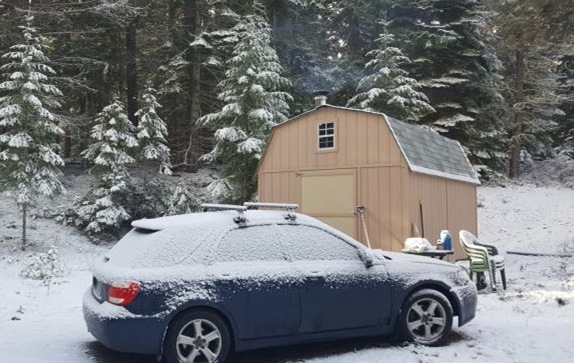

Yeah, that photo was taken before the insulation went in. Now, I have insulation and interior walls up. It was kinda neat -- when I was in process with the ceiling insulation, we got snow and you could literally tell from the outside what part I had finished and what part remained to be done from the snow on the roof. Or lack thereof. So it's working. I put Roxul rock wool in the walls, too.
I came through our first big snow -- a foot of it from one storm -- just fine. Single-digit temos OK, too. There's been a learning curve but you can never fully know how to live the life until you are actually living it.
As Toyota said, I've made friends and we all help each other. No one has this alone. It's a really neat little community. I've helped out, too, giving rides to town to folks having car trouble.
And a neighbor plows out my driveway just because.
I wish the shabin and mive could have been done earlier but that wasn't possible. So I've just dealt with reality.
I really can't wait for the main cabin to be built and NOT have to be off-grid but I'm fine for now. Sheltered, fed, warm. I have everything I need.
