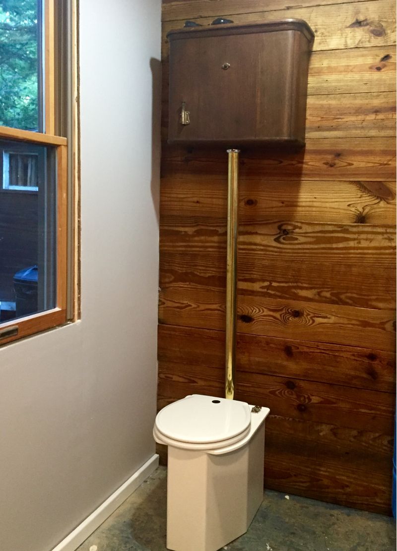

We went with the BoonJon C-head composting toilet and its work out great for us. We're at the cabin just about every week end. At first we dumped it in the composter after a weekend of use but now leave it to every other. It's been fine, no mess and no smell. We use a combination of petemoss and cedar chips as cover. We have about 1/2 dozen coffee cans on a shelf with instructions right next to the toilet.. The wooden tank a pipe are just for "effect" and serves no real purpose...This was during last years remodel/ construction. It's more finished now
