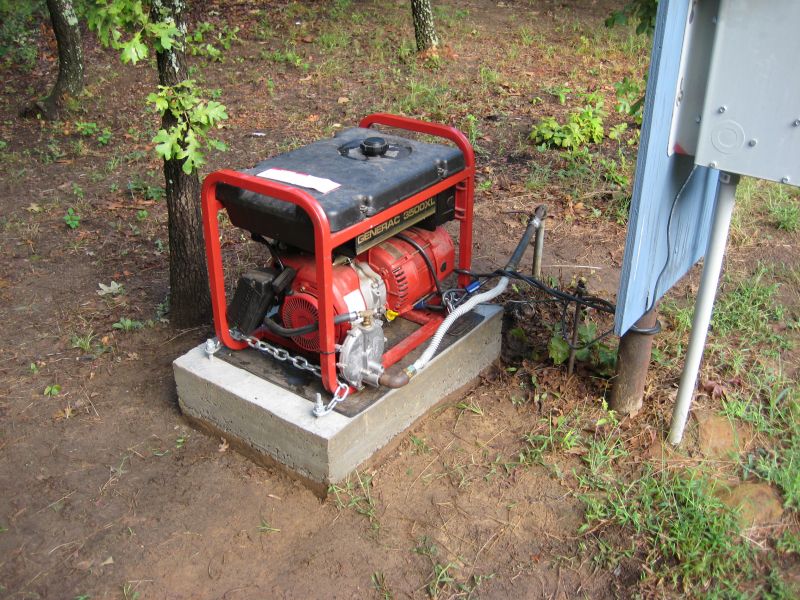

drb777
# Posted: 9 May 2018 02:09pm
Quoting: Wilbour
How sweet is that! Can you run a ng genny?
Yep, see photo. 'Only use it as a back-up, just can't beat the quiet of the grid. Still nice to have a secondary & reliable power and heating source.
NG fuel back-up genny
