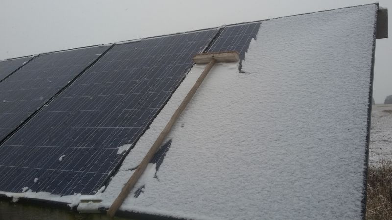

  Greybeard's experience with solar production is the main reason I suggest folks do ground mount and tiltable solar panels. You must be able to sweep your panels in the winter. Being able to squeeze out a few more watts with a better solar angle for winter. Worth it.

  Greybeard. We just went through heavy snow but very cold. The snow just didn't stick. Blew off. I wonder if our sticky warm then cold climate doesn't make things worse. I get freezing rain. Snow. That stays on for days if you don't sweep.
  Just a note: Yesterday at the farm. 2" of snow on one set of panels. 4" on the other.  Making 64wh. at 10 a.m. Cleared panel set 1: 164wh. Cleared panel set 2. 264wh. x 5 hours of bright cloud. Extra kw of power.
