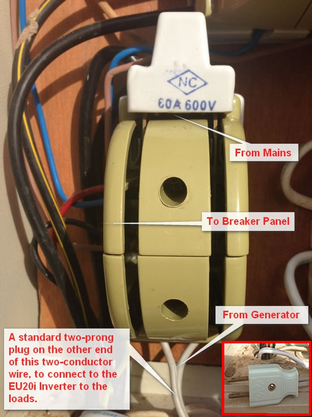

Quoting: hamish I have never seen the need to ever run a suicide plug on anything anywhere. I take it you have never resided in Southeast Asia? You wouldn't believe some of the wiring that is done here. I'm surprised more people don't get electrocuted in this part of the world.
Quoting: redwolfguild I just went "Suicide" with mine as there is no power in the cabin unless the generator is plugged in. Just follow the correct steps plugging in and out.
That's what I did, even though we do have mains power here. But, the way it is wired, it is impossible for both the mains and generator to provide power simultaneously.
The only way the "suicide plug" is powered, is if the generator is connected to it and running.
I just wired a double pole, double throw switch, connecting mains or generator, to a 32 ampere breaker panel. (230vac, 50hz, power here.)
