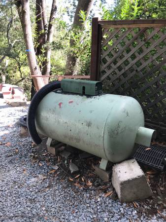

Free tank down the road from me, about 5x3' round. Don't know the age or if it could be used.

Most large propane tanks like the above depending upon where you live if they are 10 years old either need recertification or replaced. There will be a date stamped onto the above tank.
The company I was going with before we were denied service had a rental program. $100 per year rental with a replacement tank every 10 years. They don't want to risk using older tanks. The tank had a sensor on it that would let the company know when a refill was needed.
