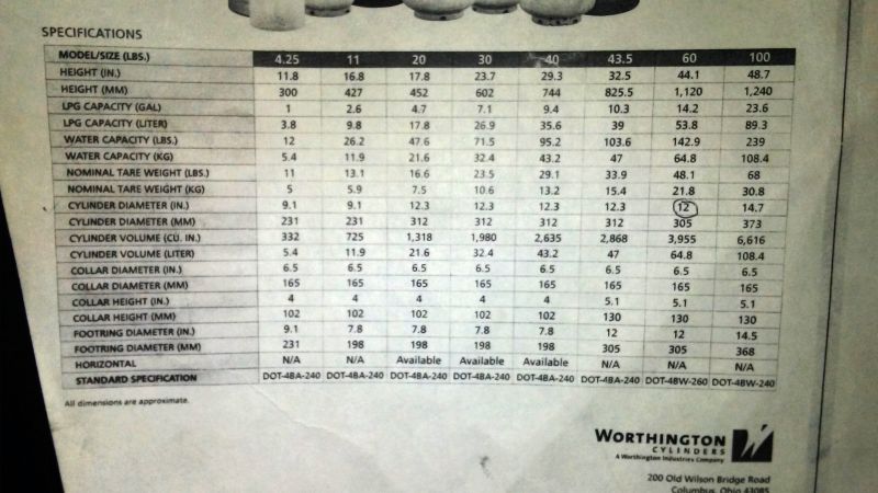

# Posted: 19 Nov 2018 10:18pm
Here's a chart that might be helpful.

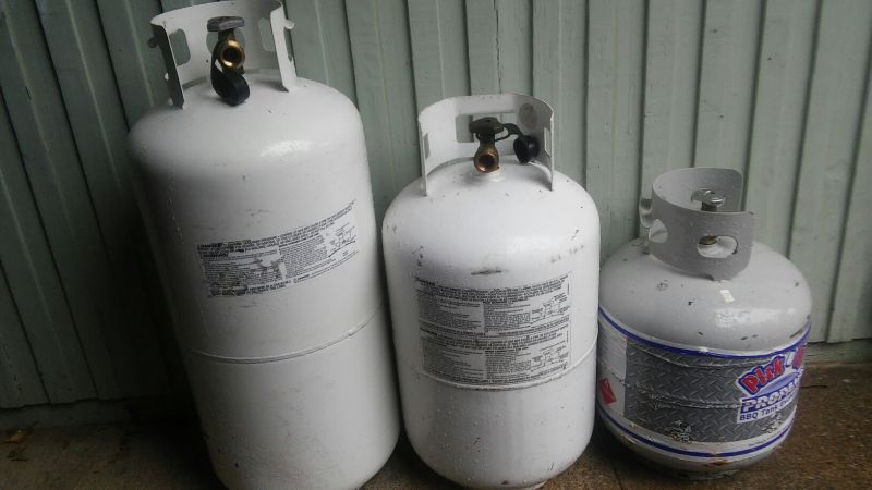

# Posted: 23 Nov 2018 05:35pm
More propane tank hodge podge. Earlier this week I scored this 40 pounder, dated 7/17, for $25. Earlier than that, a friend had told me he gets his propane at the cheapo Beacon gas station down by Home Depot, and they never check the dates.
I had to get some 2x4s, so I took 3 tanks with me. The pump jockey filled the empty 20 pounder, 4.5 on the meter. Hooked up the 40 pounder, without resetting the meter. Stopped at 10 gallons, so only 5.5 went in. Then he hooked up one of the expired, empty 30 pounders I had brought, nothing would go in. He unhooked it and banged it on the ground 2 or 3 times, still nothing. So I paid for the 10 gallons, $35, and headed off to Home Depot.
Got home and weighed the 40 pounder. I had weight it empty, 30 pounds like it's stamped. Now it weighs 50, so it does only have about 5 gallons in it.
I'm just wondering if the pump stops at 10 gallons and has to be reset? Anyone come across this?
# Posted: 23 Nov 2018 08:02pm
If the pump guy did not check dates he is probably a doofus and has not got a clue as to how the equipment works. I sometimes buy propane at a place in a small town in the middle of nowhere, UT where his brother works.
# Posted: 23 Nov 2018 08:16pm
Quoting: ICC
At least he wasn't smoking a cigarette!!! LOL 😲🚬 💥🔥
# Posted: 23 Nov 2018 09:05pm
He no hablod ingles but he looked like he'd done it before. I called my friend, the one who told me about the place, he's bought more that 10 gallons at a time so it's not that. He asked me if the guy opened the valve with a screwdriver to let the gas out? Well he didn't do that, was he supposed to? I don't remember the other place doing that.
