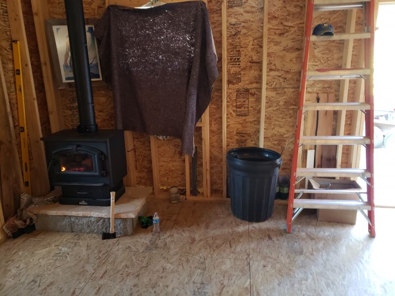

Quoting: justinbowser We are trying to decide what wood stove to get for our 288 sq ft cabin. About the smallest one I've seen says good for 900 sq ft (but made in China) and the good ones I like the looks of are for well over 1000 sq ft. Is there any problem putting in a bigger than needed stove? I have a pretty big 'dozed pile of Oak to feed whatever we wind up with. Also, the cabin floor is vinyl over wood so I will need to put down something to put the stove on. Would 1 1/4" concrete squares do the trick? I see high-tech sounding hearth kits for sale but at over $500 that seems a bit out of line... Thanks... Yes, I ran into the same deal. As for hearth, I just bought one, set it in place, done. They have straight or corner ones. Spendy, but meets fire code. As for woodstove, ended up making my own. You can try to get a Jotul 602 (pronounced yodel)![left_side_view.jpg left_side_view.jpg](https://www.small-cabin.com/forum/shared_files/uploaded/8612/120983_1.jpg) left_side_view.jpg
| ![woodstove10.jpg woodstove10.jpg](https://www.small-cabin.com/forum/shared_files/uploaded/8612/120983_2.jpg) woodstove10.jpg
| ![woodstove20.jpg woodstove20.jpg](https://www.small-cabin.com/forum/shared_files/uploaded/8612/120983_3.jpg) woodstove20.jpg
| ![woodstove19.jpg woodstove19.jpg](https://www.small-cabin.com/forum/shared_files/uploaded/8612/120983_4.jpg) woodstove19.jpg

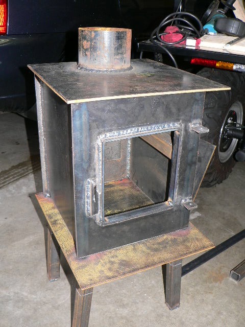

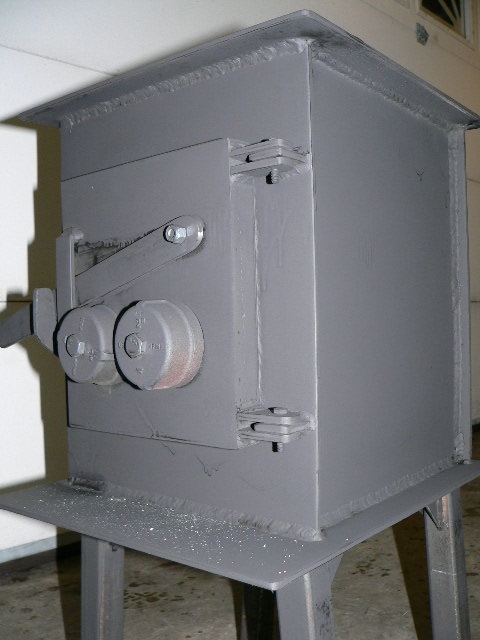

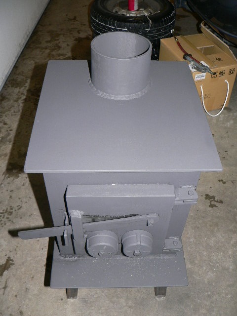

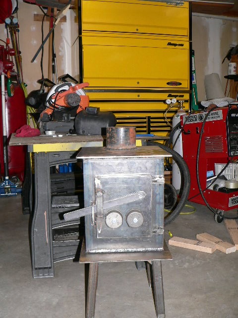

So after studying wood stoves for a few months, I've decided to build my own like Toyota_mdt out of a piece of 12"x12" 3/8" wall square tube bought for scrap from my local steel supplier. I have high temp glass, plate for the door, and stainless 4" insulated pipe for the flue. Will probably start building it in December when things slow down at work.

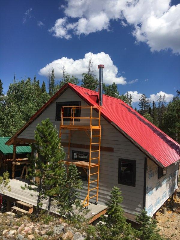

Here is the size, just for reference.![1544.jpeg 1544.jpeg](https://www.small-cabin.com/forum/shared_files/uploaded/8612/121034_1.jpg) 1544.jpeg
| ![20180901_085551.jpg 20180901_085551.jpg](https://www.small-cabin.com/forum/shared_files/uploaded/8612/121034_2.jpg) 20180901_085551.jpg
| ![2024.jpeg 2024.jpeg](https://www.small-cabin.com/forum/shared_files/uploaded/8612/121034_3.jpg) 2024.jpeg
