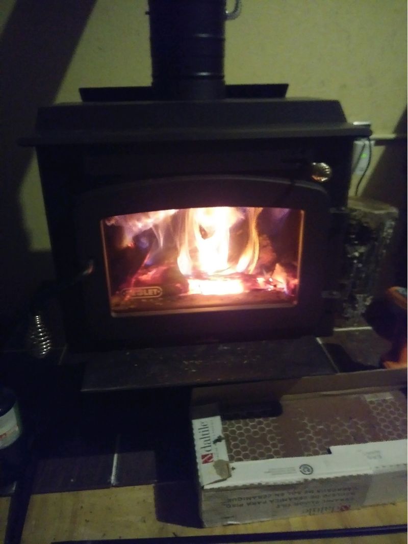

Just got back from spending 8 days at our cabin and really feel refreshed! It rained half the time but there was finally enough decent weather to cut a hole in the wall and install the DuraLast Thru-Wall flue kit and a little piece of stack. Glad to get that job out of the way!
Saturday morning it got down into the high 20s and the Drolet stove worked great. About 8:00 PM Friday evening I started a fire and after getting a decent coal bed I put on an 8" log and after getting it flaming throttled the stove down and went to bed. Saturday morning all that was left was ash but the stove was still warm and the inside temp was about 68 degrees.
I am very pleased with the way it performed and once I get the hang of getting a hot fire started quickly I think the amount of interior smoke will be manageable. I think I will get a propane "blowtorch" like I use to fire off the wood in my smoker and use it to start the stove. I think that will introduce enough heat to get a good draw started.

# Posted: 18 Mar 2019 09:02pm
Sorry, can't edit the above but the Flue kit and stacks were "Duravent" and seemed to be very good quality.
Here's a pic of the first fire...
# Posted: 20 Mar 2019 11:46am
If your having trouble getting a draft going..get your fire built but not lit. Stuff a piece of news paper in the chimney hole at the back of the stove. Light the paper and fire at the same time, close the door. Through the wall chimneys are notorious for bad drafts and alot of cresote build up.
justinbowser
# Posted: 20 Mar 2019 01:38pm
The fire started quickly and a good draft started almost immediately but I still got a little smoke in the room. Once I get the hang of it I think all will be OK. I use one of the propane blowtorches to light my smoker so I am think I will do the same for the stove.
On my through wall installation I used two 45 degree elbows and 2' of pipe instead of a 90 degree elbow.
# Posted: 20 Mar 2019 02:29pm
Two 45* is prob the best way to go through the wall.
