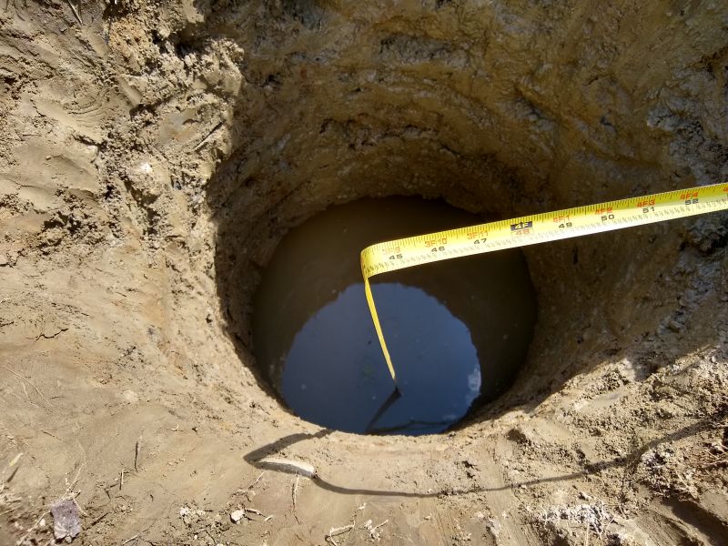

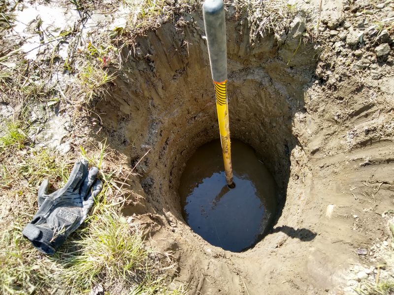

So at just over 4' I hit water, a lot of water, it flowed it. I scooped it all out and it filled right back up. I then left to go to the hardware store to get a post-hole digger since it was getting too deep for my shovel. came back and the water level is higher then when I first hit water. threes a good foot or so of water and it seems to flow in as soon as I remove any.
Is it possible I hit a vein of a spring? I'm wondering If this were to be a spring how do I proceeded if i want to collect water from it, and obviously move my outhouse to another area.

Looks like you have only 1 foot of water, but nice self dug well. I see sandy soil, not much clay. Pump the water out and keep digging. You want to install a black culvert pipe with lockable cap. My guess about 8 feet long, with about 1-2 feet exposed above ground.
Diameter depends on how much water you need and the refill rate. Come up with a design before you proceed. Congrats, water on a property is good. Also find out the distance the outhouse needs to be from the well. Maybe 20+ feet and downhill from the well.

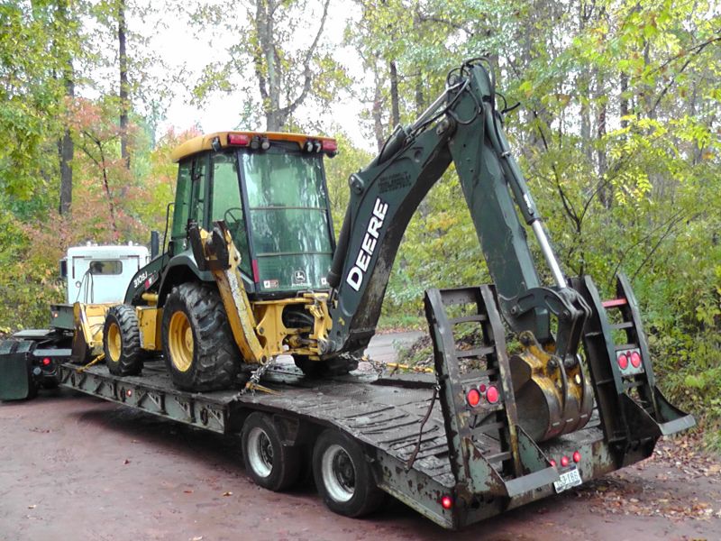

I rented a Deere 310 backhoe after studying youtube videos and the user manual online. I needed to both dig and move dirt. From now on I'm renting the excavator. Lower center of gravity. I almost tipped it over moving a monster stump.
They are fun to use but can be very dangerous if you are not careful. What is the most important part of a heavy machine? The Seat Belt. I was working on the side of a mountain.
Look up Andrew Camarata on Youtube and watch all his videos on using and maintaining heavy equipment. There are others like LetsDig but they don't explain chit.

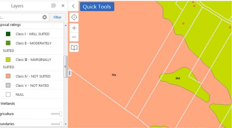

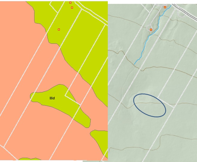

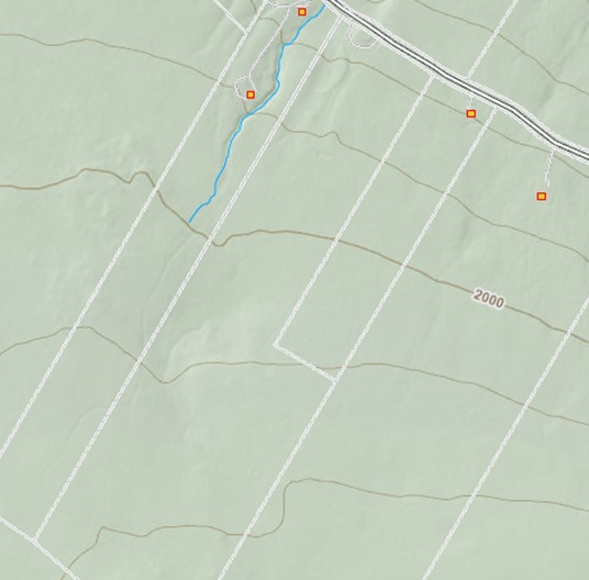

# Posted: 14 Jul 2019 11:16pm - Edited by: DaveBell
Topo Map from Vermont Interactive Map Viewer.
Where did you find water? Where is your cabin site? The green areas are possible out house locations. I placed a circle where you could be way back in but don't know if you can drive that far. (yet)

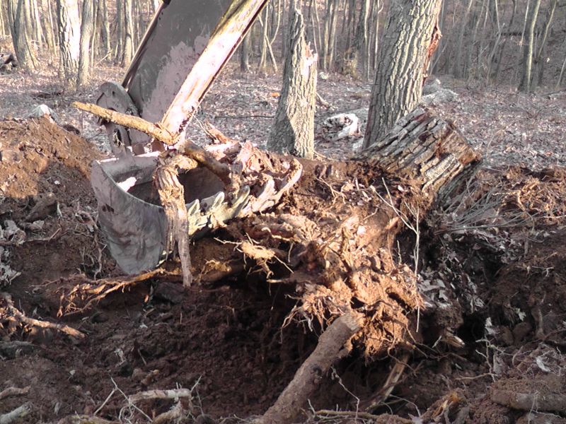

Thats hardly a monster. I have dug out and removed stumps big enough i could only push them around with my 3500lb machine. The good thing about an excavator is you have an arm that can act as a kick stand if used properly. I have used it as such.
Seat belt is very inportant!. You grab a hold of something with the bucket that dosnt want to move you can hit the windshield or get thrown out of the seat. I alwaye wear mine, always.
A 5000lb machine should beable to dig roughlt 8ft and costs about $400 to remt for the day here. You can do a whole lot of digging in 8hrs with one of these machines.

Looking at the topo map, you have options for placing the outhouse in relation to the well and your cabin. What would really be nice is to have the well 20' to the left of the cabin and the outhouse 20' to the right of the cabin to get good separation and also have the outhouse at a lower elevation. Or vice versa. Then separation of well to waste would be 40' plus cabin width. 20' buried pipe or water fetch distance, 20' walk to the outhouse.
It's always a good idea to visit your local health department to discuss your ideas to see what they think. Getting permits is better than a nasty visit from the sheriff.
Since you are planning to get an excavator to deepen the well, you could use it in other spots to check for better well locations and spots for the outhouse to check for the absence of water for the outhouse.

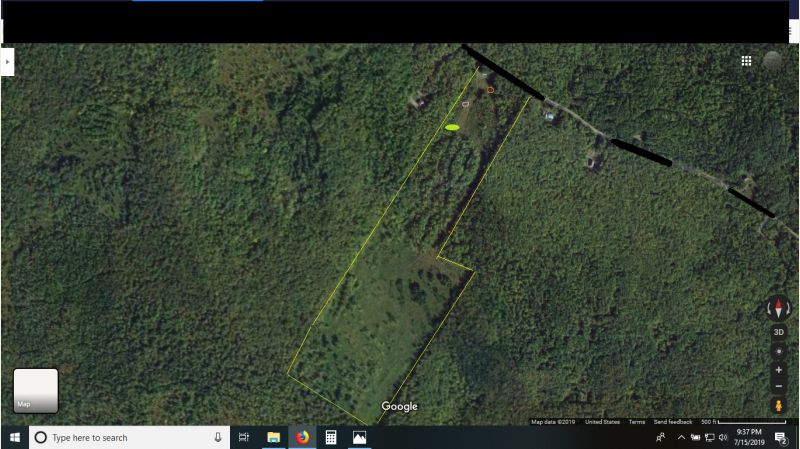

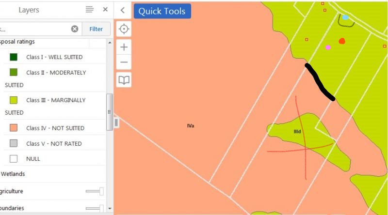

Quoting: DaveBell
I Drew the driveway thin black and my camper i'm living in blue.
Orange is cabin site and pink is where the well hole is.

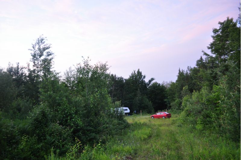

Where the thick black line is, there is thick trees after that, going past there is kind of out of the question for now, as moving supplies there and walking around is a pain all in itself. It's 40 acres so just walking from the front of the property to the black line is close to 2000 feet, slightly uphill.

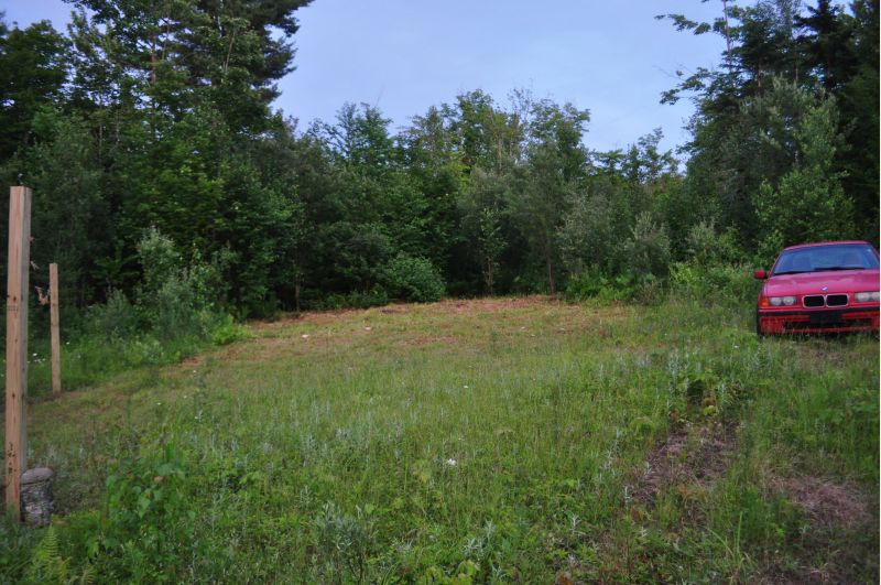

In one pic you can see the red car and camper at a distance, there I'm somewhat close to the hole, its about 40 feet behind me and to my left.
In the picture where the car is up close, you can see the building site as the weeds are cut shorter.
Building Site

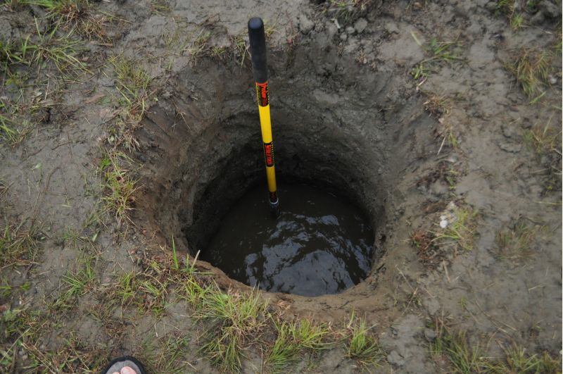

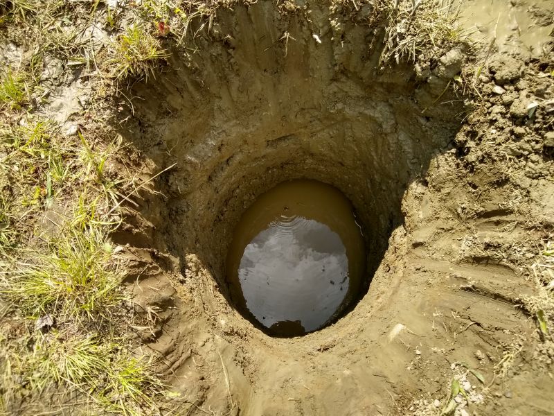

Near the hole
Near the hole
I drain, she fill right back up

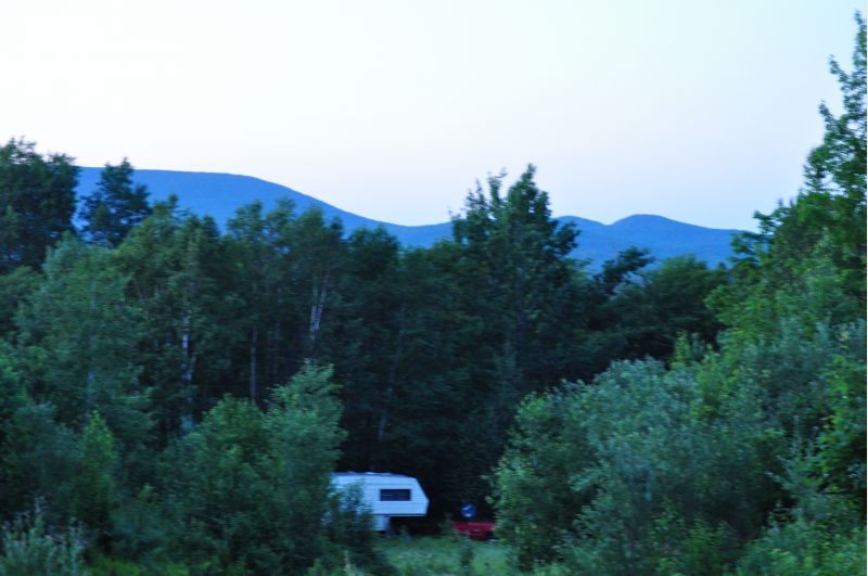

Maybe this will make more sense. The camper and driveway can be seen from the picture, Orange is building site, pink is well and the lime green is a spot im reserving for some years down the road building full time living cabin in, this spot I've been told is the best building site on the lot due to the soil and dryness. Also the views from here are wonderful.
View from the lime green spot
# Posted: 15 Jul 2019 10:02pm
Quoting: turkeyboyslim
Good to go!! Well to the left and uphill of the cabin. Do some test holes to the direct right of your cabin for an out house. Hopefully you can find a dry spot.

12" diameter pipe filled to 12" = 5.88 gals
18" diameter pipe filled to 12" = 13.22 gals
If you dug a 11' hole for a 12' long pipe (need 12" exposed above grade) you would have 8' of water.
(based on the picture showing water starting 3')
8x5.88= 47 gals.
Then you could drill a hole in the pipe cover for 1/2 or 3/4 PVC pipe. Install PVC down to 11 feet from cover to keep intake off the bottom. Install garden hose adapter with screw-on cover on the top of the PVC.
