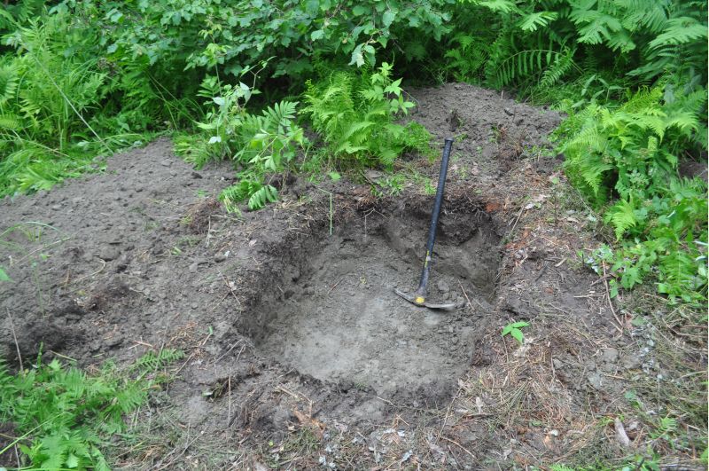

Yeah that's exactly what I had in mind. I started this today, but I'm done for the day I think my body doesn't want to continue. (pictures attached)
I think the holes too big...

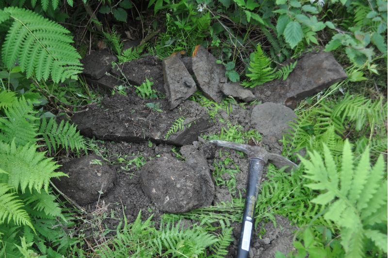

Lot of big rocks to haul out

There are a few issues here you should think about. You (obviously) have very shallow groundwater. Be careful on how close together your outhouse and well are. The outhouse is going to contaminate the groundwater around it.
Even if you site your well a good distance away, groundwater that shallow shouldn't be considered potable without treatment.
As for digging very far below the groundwater table - you're most likely screwed there. The sides of the hole will start collapsing and it will only get worse as you go deeper.

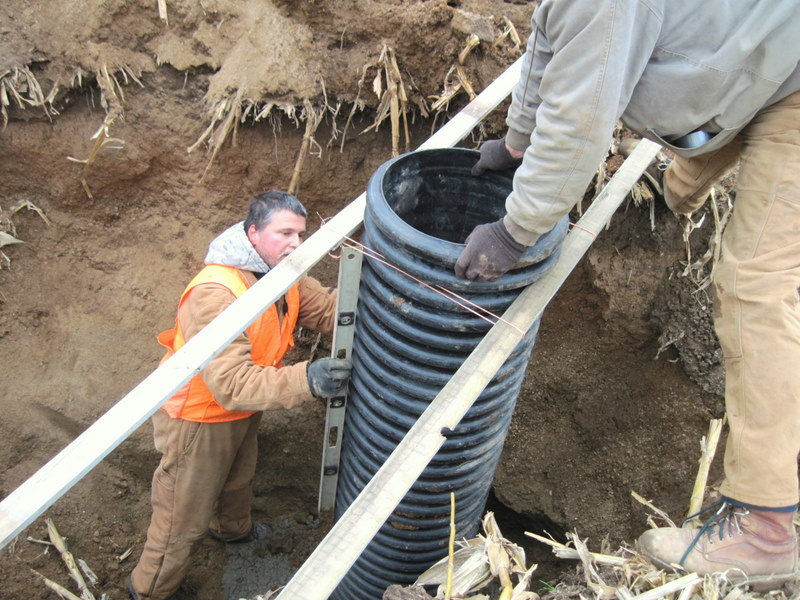

# Posted: 5 Aug 2019 03:47pm
Found a picture of that guy using culvert pipe for well.
# Posted: 6 Aug 2019 03:43pm
I think the OPs problem is there is no way you can dig a hole that deep with such shallow groundwater. The guy in the hole would be swimming.
You can try pumping the water out as you dig. That can work but sometimes not depending on conditions.
