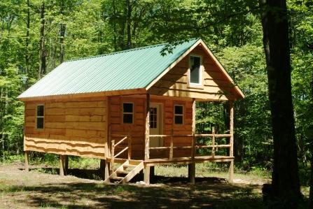

Building a cabin this summer. Just wanted to get some ideas on the best way to vent the wood stove. Was going to go through the rear wall and up along the exterior back wall to the ridge and up an extra 3' above the ridge. I'm not a fan of going through the roof unless I really have too. Any help be greatly appreciated.
I attached a pic of what the cabin is going to look like.

I’m also building this year. It’s going to look very similar to your picture 16x24. I’m putting my stove pipe through the roof, towards the peak. I believe I’ll get the best draft this way. I also have to worry about snow sliding. I thought about redesigning my interior layout but this option works best for me. Good luck with your build.

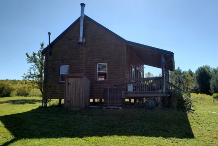

Yes.. thats what my chimney pipe is like in NY...out the back wall because of snow etc.

So like I've said my last camp exited in the rear single wall all the way up then triple through the wall and a rise of 6 feet on the exterior with double wall if I remember correctly. Was 3 feet above the ridge in the end. It had 2 90s. Never had an issue starting and it seemed like I had plenty of draft. I didn't install this but liked how it looked since the stove was centered in the room. Was easy to clean in my opinion. Seems like most are against the rear wall exit. Is it really that bad of a setup?

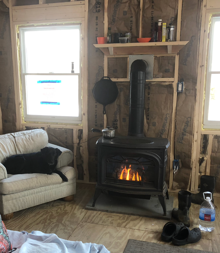

Just a food for thought here. I was all set to put in a wood stove in my cabin but opted for a propane “wood stoveâ€. I did this for several reasons which some may agree with some may not. The clearances on a wood stove are pretty large like 18-24 inches from combustibles, gas stove was 6†so I saved a lot ove floor space in a small cabin. Venting can go right out the wall with no chimney. And when I arrive at the cabin at night like I did an hour ago all I had to do was turn on the gas and had heat in 5 minutes controlled by a thermostat. I use bbq tanks. In 20 degree weather I get a weekend out of a single tank.

Just to be clear I wasn’t talking about a wall type propane heater. I love the look of the wood stove so I compromised. It works for me but I know everyone is different.

Quoting: Irrigation Guy # Posted: 12 Jan 2020 18:28 Reply Quote Just to be clear I wasn’t talking about a wall type propane heater. I love the look of the wood stove so I compromised. It works for me but I know everyone is different. 4DEA346EFED24EE7A.jpeg
Looks good. How much that end up running you? Cheapest I could find was $1800 for just the stove.

Quoting: AdkAlpi Looks good. How much that end up running you? Cheapest I could find was $1800 for just the stove.
I found it on Craigslist or LetGo, can’t remember which for $800 came with most of the venting. I had to order a thimble and a cap which I think was $200
