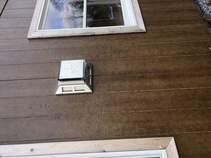

# Posted: 14 Jan 2020 07:48am
Any chance I can get a pic of the exterior where it exits? I may throw this in on the opposite side of the cabin.
Irrigation Guy
# Posted: 14 Jan 2020 01:14pm
Yes it is a gas stove designed to look like wood burner, I guess they did a good job because you were fooled lol. It is installed to spec with clearances to combustibles and floor protection. That is why I used this type because of the small clearances.

# Posted: 16 Jan 2020 02:27pm
Wow I like the look of that. Any issues with moisture?
# Posted: 16 Jan 2020 02:39pm
Quoting: AdkAlpi Wow I like the look of that. Any issues with moisture?
There should not be. The fuel burns in an enclosed firebox; uses outside air for combustion and sends all the exhaust outside. There are clearance limts on the outside for distances to doors, windows, etc, just as inside there are clearances to windows and combustibles. A very good way to heat with NG or propane when a full sized furnace is not necessary or possible. I have used direct vent propane heaters in conjunction with wood stoves and think they work very well.
