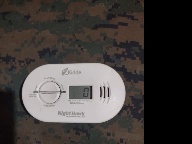

-izzy
# Posted: 17 Nov 2023 11:13pm
This is a battery only CO monitor that we use. Batteries get changed once a year.
platinumphoenixpdx
# Posted: 17 Nov 2023 11:54pm
So. I crack the door an inch and run the heater full blast for an hour, then turn it off and shut the door? And seriously does an inch really do any good? I wish I knew more science. I mean how does one separates co from the air? It seems impossible. I mean with smoke you can separate it by a vent on the upper part of a wall pulling the air out. Because smoke tends to rise. With cold air you can circulate it, or pull it down through a vent or heat sink. So how does cracking a window or door even help with co distribution? I recall fire dept use strong air flow to remove co from a building. I mean cracking a window is nowhere near the effect of a few industrial fans. So it seems that there isn't enough co to even be a threat?
Obviously this all assumes common usage and co detectors. Although I have no intention of turning on the heater full blast all day. I imagine running it for an hour twice a day would be standard for my little cabin with the new insulation. And i refuse to run it at night while sleeping. I hate noise at night while I'm sleeping anyway.
platinumphoenixpdx
# Posted: 18 Nov 2023 12:08am
Thank you for the tip. I won't mind buying that detector.
