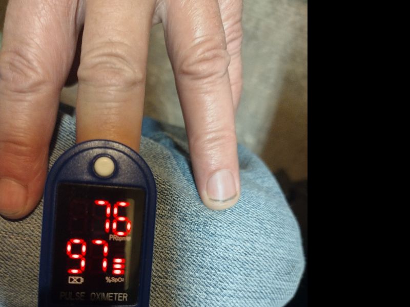

# Posted: 18 Nov 2023 12:48am - Edited by: darz5150
I was really trying not to get too deep into this discussion. I can only talk about our Real world experience.
We have a 600 sq. ft cabin. We have one blue flame heater in one room, and ceramic one in another. Also wood stove.
The highest CO reading ever, was 24 . Well below acceptible levels.
I originally had a Trane XE 90 furnace. It didn't regulate the temp as well as we liked. Even with a programmable thermostat.
People have talked about too much moisture and mold. Right NOW, I am sitting 4 feet away from a blue flame heater. It is 32° outside. It is 74 ° inside, and 31% humidity. Actually not
enough. We often have to use a humidifier or put a pan of water in the woodstove when it's really cold.
If you are worried about lack of oxygen. The O2 cutoff is very sensitive. Very. If it gets too much dust. It will shut the heater down.
After reading this resurrection thread. I went outside and smoked a cigarette. I have smoked for over 40 years. ( My bad for sure) then came in and checked my oxygen levels, sitting close to the ventless heater. If my O2 level is 97%, then I would think that there is enough oxygen to survive another day.
I will state again, I am not saying yay or nay, to a ventless heater. But in real life since 2006, using the heaters. They have not killed me yet. Lol
Pulse/ oxymeter
Pulse/ oxymeter
