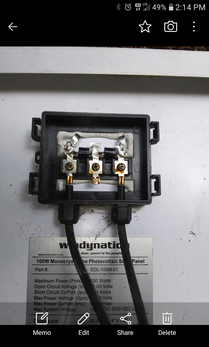

# Posted: 12 Aug 2021 05:12pm - Edited by: paulz

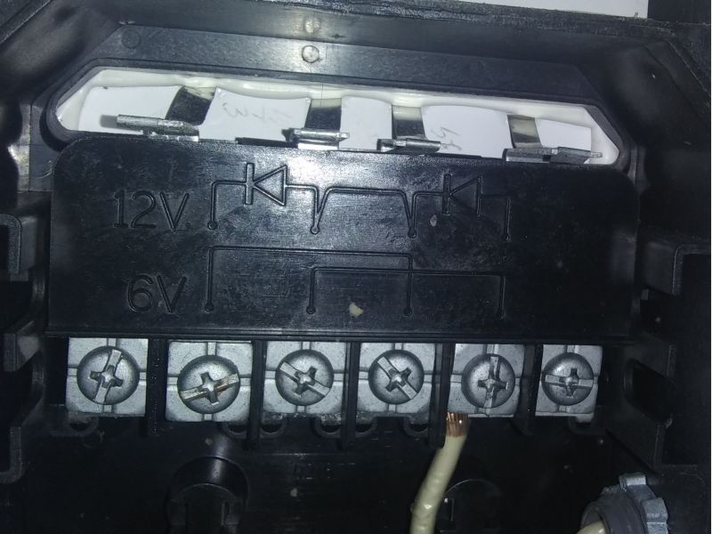

Was walking by today and flipped one over. Covers pop right off,has diodes. Now if someone can tell me how to test with a VOA meter...

So I tested these diodes today. My VOM has a diode setting, the triangle icon. For some reason these two panels have two diodes each, connected to a center tap that isn't used. See photo above.
When I tested them independently I got the correct results; .5v in one direction and open in the other. But when I test both together (at the two end terminals) I got open in both direction for some reason.

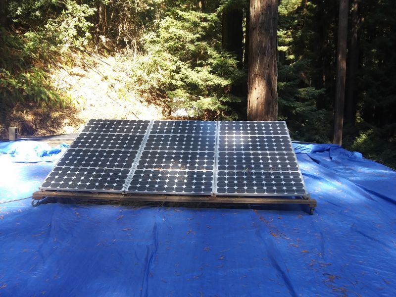

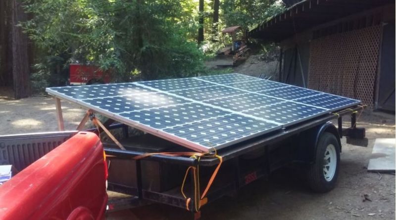

I finally put in use the array I bought to start my solar, it had been sitting stagnant as not a week later I was given the 30 panels I've been using. I have this 900w array on the shop roof now (the blue tarp is covering the PVC membrane until I find something to put over it), freeing up 12 panels I can now use up at the cabin.
It's 6 series panels x 2, puts out a bit over 100v, feeding the 150v SCC. Less juice than the other panels but I'm only working down there every few days. We'll see how it goes over winter.
I mounted casters to it, I can wheel it around for max charging but have to walk up onto the roof. Maybe with some ropes and pulleys.. Also need to lash it down if it ever gets windy here.
# Posted: 13 Sep 2021 03:32pm
Ropes and pulleys, I love it!
My wife makes fun of me when I haul out ropes and pulleys......

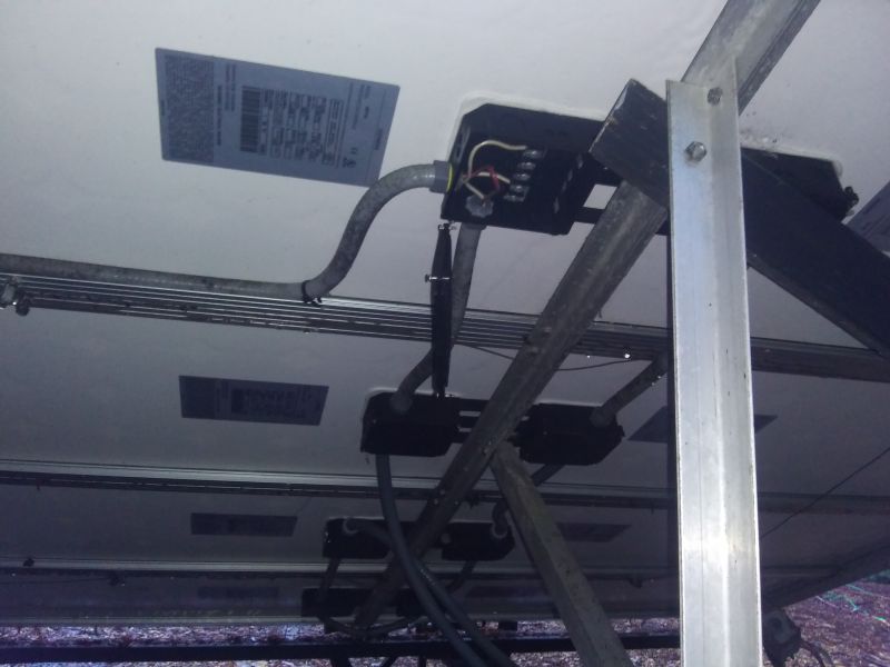

Thanks Trav. Good videos, I love it when ladies talk tech. I would have done more testing this morning but my wife was anxious to get back to urbanville.
This array was my first venture into solar. I had gone to buy an inverter off Craigslist and the guy offered it to me for $300, so I impulse bought it. That same weekend I was bragging about it to friend whose friend bought a house and wanted the solar system gone, 30 panels. So that's what I'm using at the cabin and this array has been mostly sitting.
Anyway this is how it's wired up, 2 strings in parallel, 6 panels per. No MC4, this thing is old, probably predates it. Also might be why it's not putting out.
I should take it apart and maybe spread the panels around in parallel, but it's nicely put together and wired, and it does put out juice when it gets good sun.

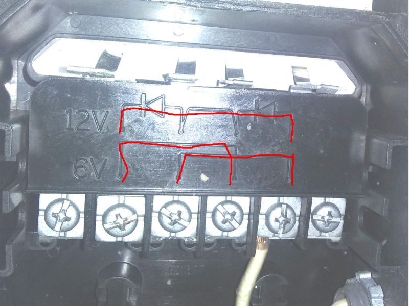

Checked this array today. No sunshine. 115 volts but only .16 amps, .08 per string. I disconnected one panel, it was putting out about .012, so with 12 panels the .16 amps. Don't know what should be expected on a cloud covered day, with tree shade to boot. This was with the ammeter connected straight to the panels, no battery.
I noticed this 6/12 volt diagram for the wiring, why would you use one over the other?

Only 18W on a cloudy day with the panels not angled perfect.. That is realistic..
The fact that those panels have a 12 and 6 volt config, seem to verify they are pretty old.
Old panels like that usually perform pretty poor in series... but cloudy conditions really kill production anyway!
