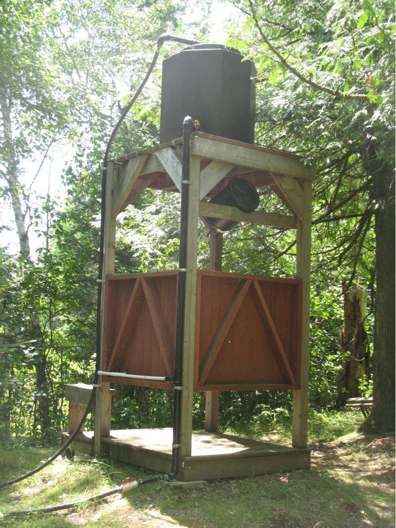

Thanks Daaaaaaaan, this is actually where my thinking has been going. I have an outdoor shower that I love. It is a short distance slightly above the cabin in a private cedar grove. It is a wooden shower stall with a 375 L black poly agricultural grade water tank. I fill it when needed using my generator and a 1/2 HP utility pump. I put a little chlorine in it and have never had an algae problem. This was for our first gravity water system to the cabin. My brother who is a scrounger picked up a Shurflo pump for $25 at a thrift store in Calgary and also a spare pump head for $5 and gave them to me for my birthday. I was keeping them on hand for a spare. A small solar panel and an old battery with some life would do the trick. I'll just have to make sure the tank doesn't run dry while the girls are showering.
outdoor shower
outdoor shower
