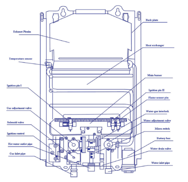

L5 Temp sensor, flame sensor

Computer board and fan? We are clearing talking two different versions
I have no idea what that version is but it sure isn’t my battery operated ignition propane unit
There sure isn’t those things in mine
Anyway I’m glad your method and system works for you. That is what is important
And mine with no computer boards fans or sensors works great for me.
This is the dumb version I have.
I didn’t realize they made smart versions
Sorry for the confusion

I still don't know what unit you have, but the battery pack gave me a better clue.
https://support.eccotemp.com/hc/en-us/articles/115012771707-L5-Diagram-of-Parts
