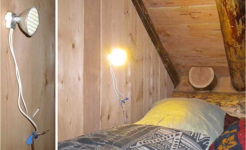

 Here is a picture of it temporarily mounted on the wall surface.  I'm going to drill a 3/4" hole in the board and screw the socket to the backside. Then just poke the bulb thru the 3/4 hole (to get to the socket pins).
 This light is a 3-watt (the picture below), and (at ~30 inches from a book) is very bright for reading.  It's so bright that I will figure out some kind of sconce-like cover for it.  If used as a reading light, at 30 inches, a bare 1watt is easily enough light.  Also this light is a "2900K" color-temp bulb, and the pattern is "120degree flood".

 |  2.85-watt MR16-WW48SMD Warm White bulb and SC-110-1 socket

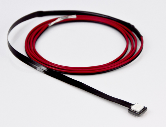

 Glad to help.  Here's another useful 12v LED, it uses only 1/5th of a watt.  Its so tiny but almost too bright to look at.  It's on a ribbon cable so I was able to snake it outside onto the porch as a nightlight.  One of these (night-)lights my entire (7x16) deck, and I can see the woodpile next to the door.
 I'd estimate it's about as bright as 2 candles (did not test).  I bought a few "Yellow" LittleDots to see if they more closely resembled the color of flame, but they're way too yellow, and produce maybe 25% of the light or less.  I did not test the "natural white" color, which is probably a little brighter than "warm white".  I'm happy with "warm white".
 At .2w, a basic 40Ah 12v car battery could run this little LED for (40Ah/(.2w/12v) = 2400 hours = 100 days!
 Another way to look at it, you could run it for 24 hours, and a 5watt solar panel can replenish 24 hours of light with one hour of sunlight.
 Part#: LD1-WW (warm white color) $1.99  http://www.superbrightleds.com

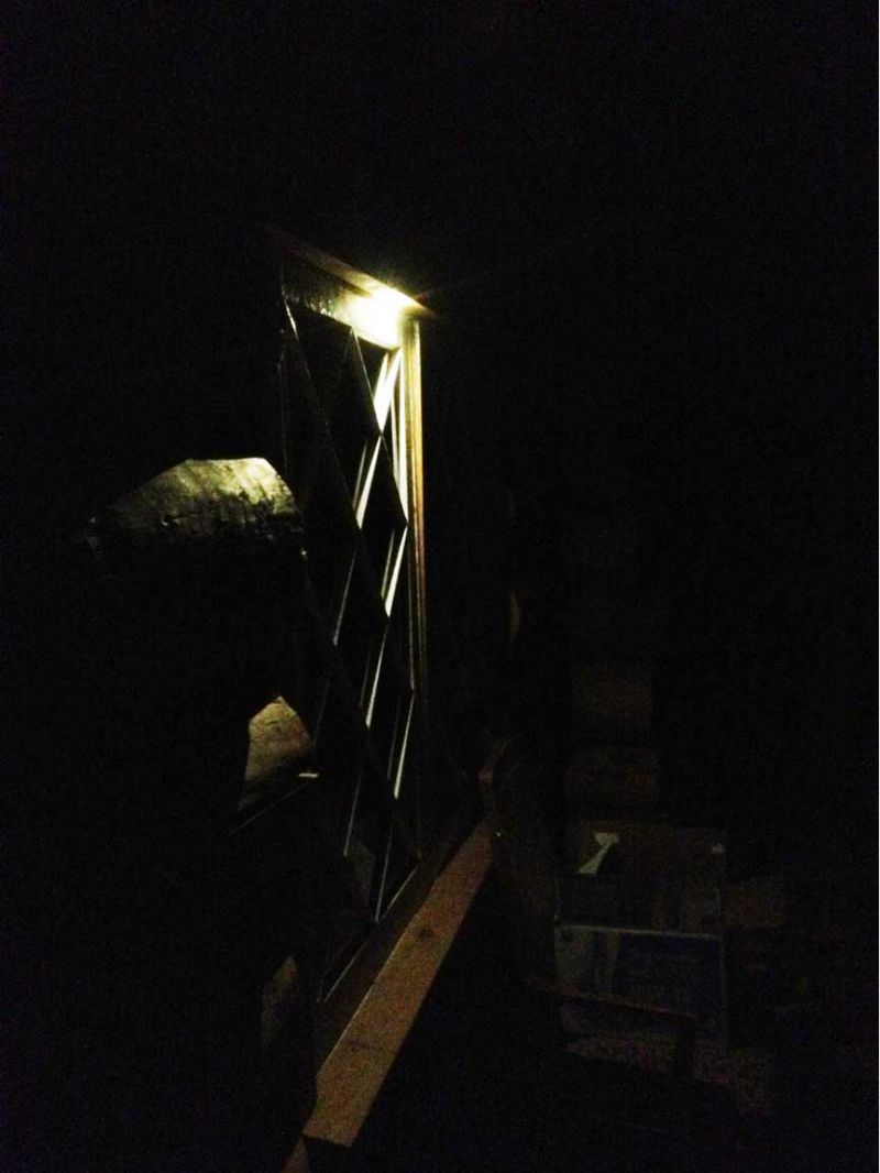

 One thing I enjoy about the cabin is that when it's dark, you can't see your hand in front of your face - but sometimes that's a hassle.  Basically once you get a light like this, you're back in the city,,,,, "the dark" is gone and takes away a little of the charm too.  But on the other hand, you're not tripping over stuff, and it doesn't spoil your night-vision.
 |  Little Dot 12v LED 1/5watt
 |  Tiny!
 |  Front window 'closed' onto LED ribbon cable. Can see everything on the deck.

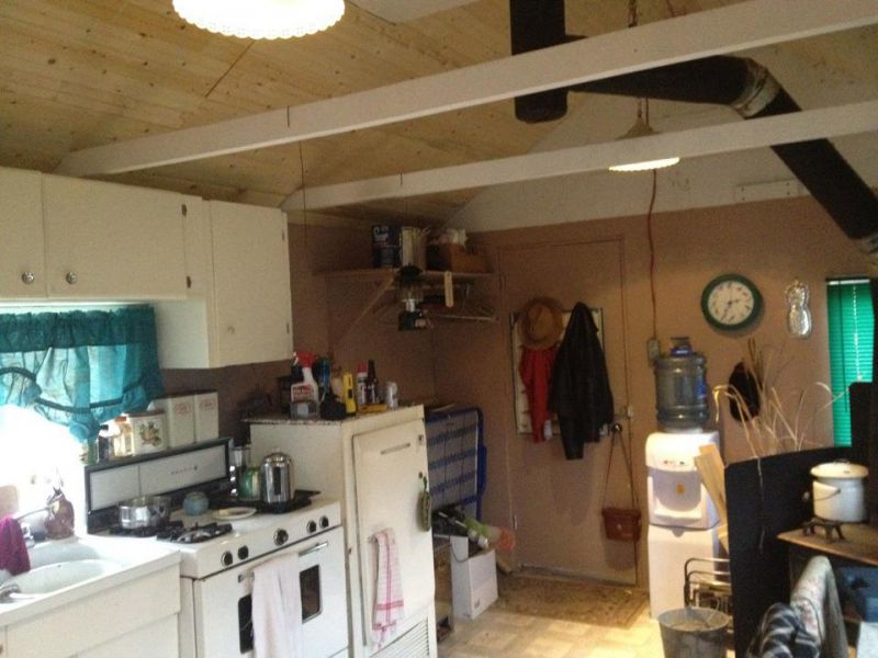

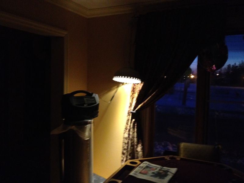

 Here's a quick shot of the lamp I made using your instructions.  The holder was from home hardware (less than $5) and the bulb came from Canadian tire($20).  The bulb is a 3 LED 4W bulb which claims to be 20W.
 Two of these in the cabin kitchen ought to do nicely!  Thanks again!

 Just thought I'd post an update, the lights are up and give more than enough lighting inside the kitchen!  Together they use about 8 Watts.
