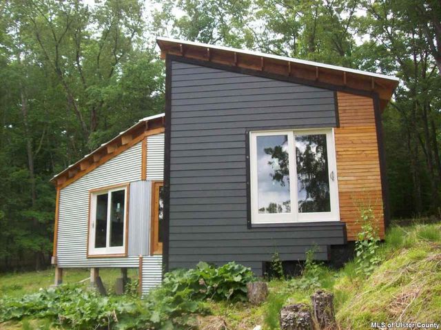

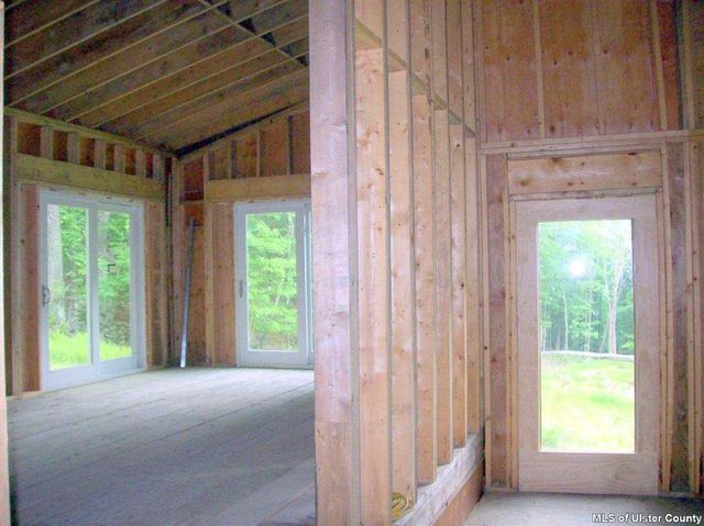

Hello! So glad to run across this Small Cabin website, there's so much helpful information here! Here's my question : is it worthwhile to invest in land & an incomplete cabin?
I'm looking at a 3 acre property in Stone Ridge, NY with a partially-built modern cabin in place. There are architectural plans and framework in place, but it needs quite a bit of work to finish it - all interior work, electric, plumbing, new dug well, replaced septic. We love the style of the cabin and the property itself!
I'm wondering if anyone has experience buying a partially-finished cabin? I've attached a PDF of the existing architectural plan and a couple photos of the current build to get a sense of the progress. My husband and I have no building experience, so we would definitely be hiring out a General Contractor to oversee the project as a whole.
Any thoughts, experience, feedback, or questions are greatly appreciated!
Here's a link to the photos!
Current building status
201_JH_draw2.pdfAttached file: Architectural plan

Looking at the framing, it looks very nicely done and professional. I am not big on the style, but that is just ones personal preference. If you like the style, I wouldnt be afraid. How is the foundation done? Post and pier, look it over well.
Was the septic done with a design/permit? Just make sure it was permitted so your not stuck with something that doenst meet specs or bootlegged build that could bite later on down the road.
Strange abrupt end to the siding in several areas. looks like they ran out of material??? But I suspect it was done deliberatly???

toyota_mdt_tech Thanks so much for your response! The owner built it on his own, so I want to be very thorough with an inspection! But before throwing money towards it, I wanted to get a sense of if it's a good idea in general or not... Thank you for your input!
Septic in place is an old metal one, so it needs to be permitted and replaced in the future. The siding is indeed a little quirky, but intentional. I don't mind it, personally
Property / home is listed for sale at $119,000. The land value is good. My concern is the cost to finish.... $8,000 for the well ~$5,000 for the septic ~$60,000 to finish the 900 sq ft. cabin. That brings the total cost to nearly $200,000 all in.
In the end, we'd have a modern little weekend cabin with a nice piece of land - something you can't find in Brooklyn (where we reside), but is the $200,000 investment worth it???

Since there are architectural plans I would guess that the cabin has been correctly designed and engineered. If the client went to all that trouble I would also guess that he built the cabin as per the plans.
It looks like the main space is built on a proper concrete wall and the den area is built on piers. I would contact the architect listed on the drawing and ask for any info on the build. usually clients stay in contact with the architect even if they build it themselves. Also ask the owners who they used for concrete work, roofing work, etc. Most people who build it themselves still contract out the bigger, more difficult tasks.
