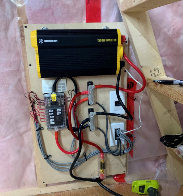

Progress is slow, but, the old' ship is shaping up. Connected the wires and gave a little home for everything this past weekend. Nice to have the old solar panel and batteries pumping out 12v led lights everywhere.

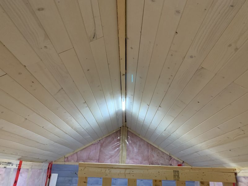

Managed to get the ceiling done, which I will say I probably should have had another set of hands to help lift things.

Where did you get the wood for the ceiling? It looks great. Did you apply finish yourself or did it come prefinished? My cabin is in Southern Ontario and I've been struggling to find what I want for T&G pine.
Great job!

Thanks!
Its 5/16 t&g from the Home Depot. A bit expensive at $23 for 6 boards (about 8 ft long).
URL
Then we did a 50/50 Ceiling paint water mixture. Brushed on and rubbed off after a minute or so. I do agree it turned out quite nice with not looking too white or too much like plain pine.

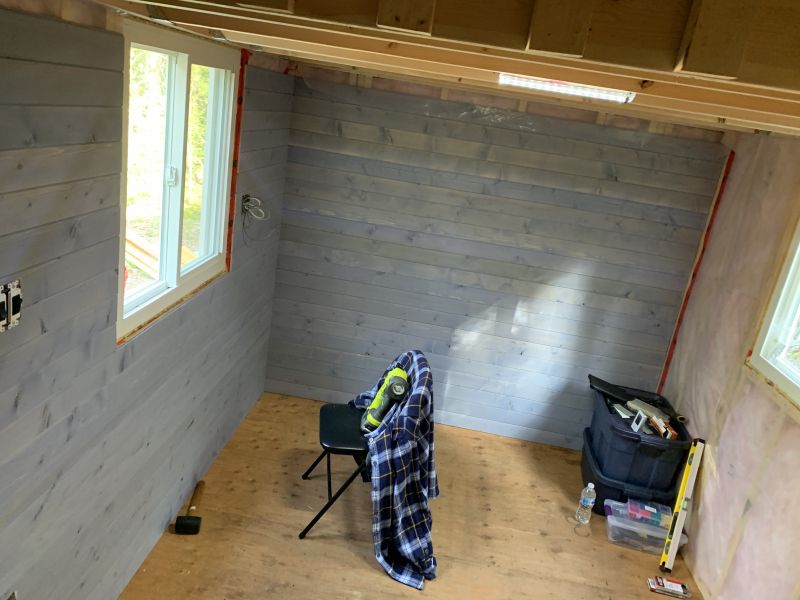

The walls we are using the same wood but doing a tinted stain, this time due to the numbers we rolled it on, brushed the T&G sides and then rubbed it off.
