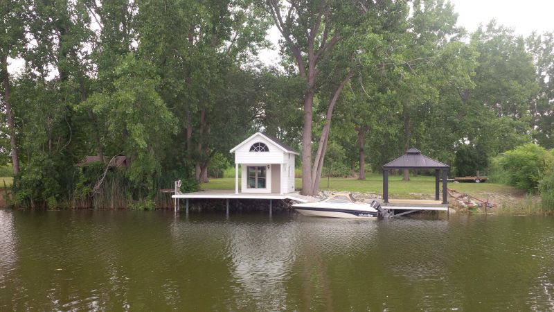

I don't have my copy of my drawings available to post at the moment. I used 10 - 4" x 6" x 3/16" x 27 ft long posts to set my building and dock out in the water. Seven posts are in the water and three of them are only 13 feet long and embedded into the slope of the shoreline. Nothing makes contact with the upper level of the lot so that the Town of Lakeshore has no say and what goes on with my dock system. I applied for and got a permit to protect the shoreline with rock for 65 feet; to pound pilings into the water on my own land and to build a shed that is less than 108 squ.ft. at the base. I added a 10 ft x 16 ft. under 6 ft high, living space above the lower structure to "store my boat". All of this was approved for the bargain amount of $ 250.00 for the permit from the LTVCA. I drew up some simple sketch of the lot size showing how much of my land was under the water, I then drew up a side profile of the property to show how the dock hangs out over the water and included the protected blanket and rock structure along the shoreline. I ended my request by telling them that I would use recycled pressure treated lumber on the gazebo deck. She liked everything, though it was the best presentation she had seen in a very long time.
The thing you need to know about the "H" is limited to the July 15th meeting. They will pass an amendment that will remove the septic option from lots and replace it with a new rule that states that all future projects must be connected to a main. They are after the Ontario Government for funds to run new pipes in Lakeshore and they are currently at Stage 4 of 5 regarding the application.
In closing, I would warn you that the Town of Lakeshore controls the "plain" of the land, nothing more, the LTVCA controls the shoreline and everything under it that is part of your lot. The Fisheries controls everything past your under water lot outward. So make certain you know where the boundaries of your lot are, everyone is given some water frontage but you need to find out how much YOU get! I also understand that the LTVCA is very slow in issuing permits these days, one family waited 11 months to get their dock permit and a building permit. Good luck and let me know if I can provide additional information. Have a look at our property as of yesterday. A shot from across the canal.
