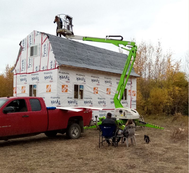

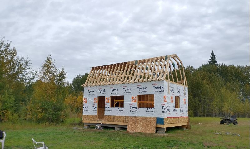

Since I can't seem to adjust the picture sizes in my last thread, I thought I would start a new thread of my progress instead.Things have been progressing slowly. Sigh, one person can only build so fast!
We had a picker truck out this weekend to finish off all the roof truss lifting and help with some of the sheathing on the uppers. This is one area I knew would be tough, but probably underestimated how tough. Its high up, very sloped and with nothing to hang onto. It makes very slow going to do it safely. A fear of heights would definitely not be good here.
Actually, its going slow enough that I'm considering bringing in a tow-able boom lift for a week. The weekly rate is only 3 times the daily rate, so that makes sense. With a boom lift, I should be able to finish both the sheathing and metal roof in a week (probably less).

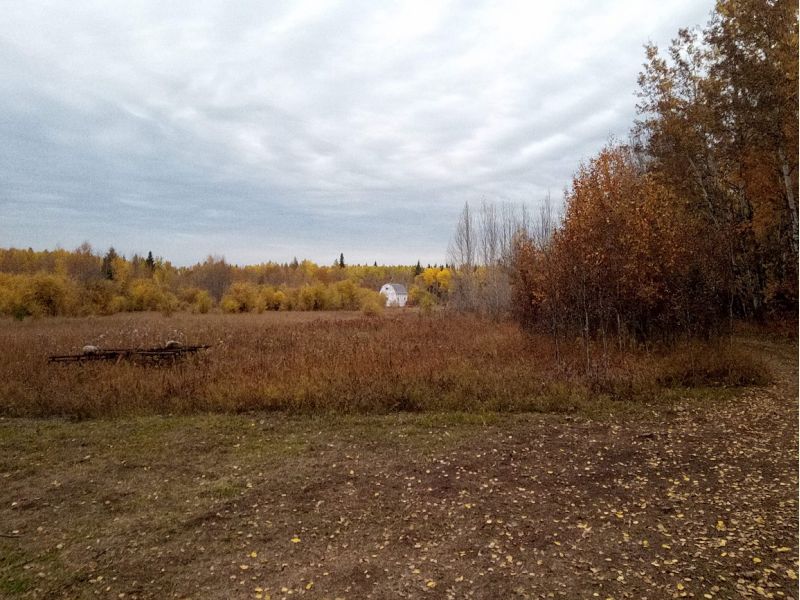

travellerw

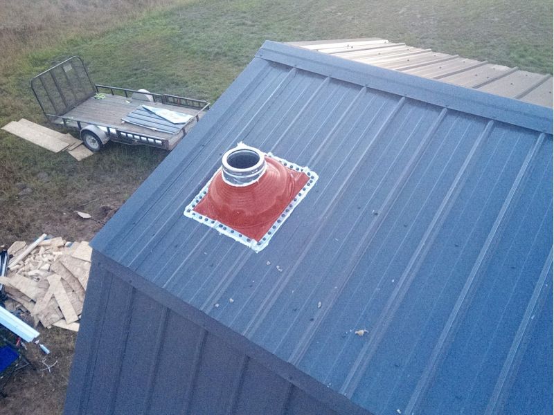

# Posted: 1 Oct 2021 10:31pm
Sigh.. I just can't get the bandwidth out here to post any substantial pics. (A small cell tower will be on the project list).
However, here is one teaser pic while I was just about to start the metal roof. (its crazy how the pic distorts things. It doesn't look very high, but if you consider the truck is almost 7ft tall, things come into perspective!)

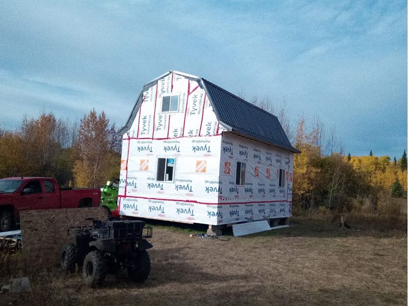

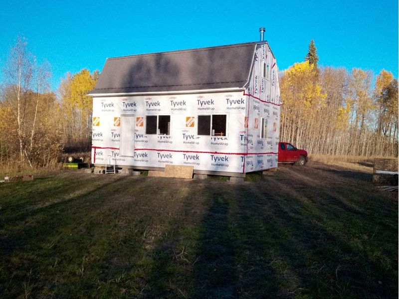

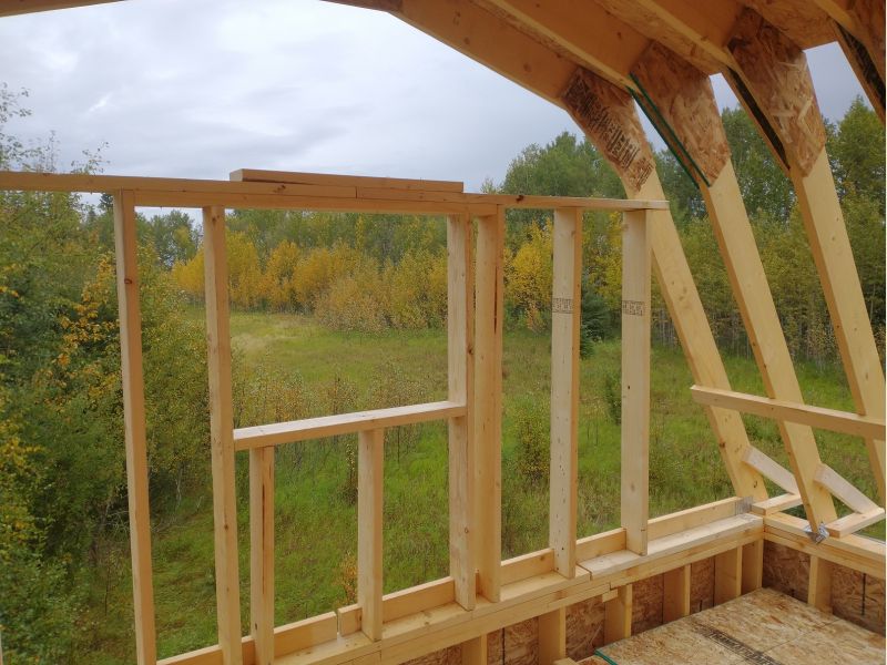

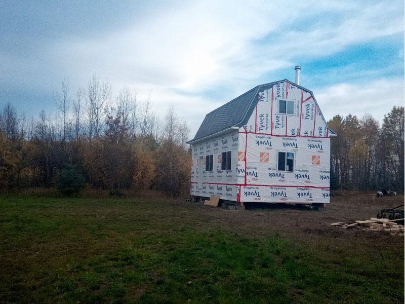

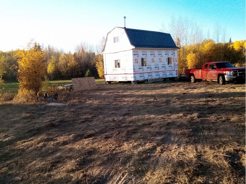

travellerw

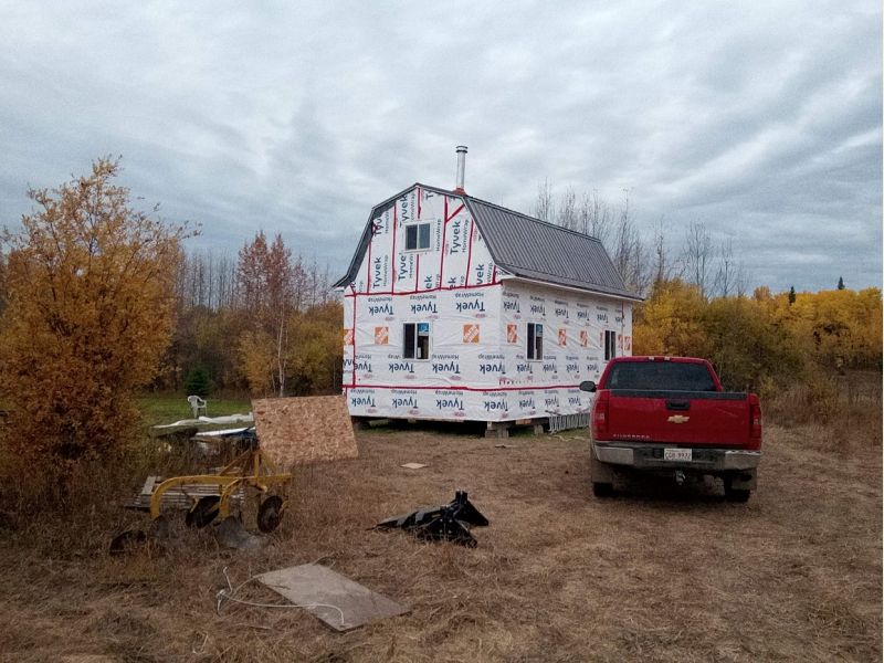

# Posted: 3 Oct 2021 02:30pm
Alright.. Here are the updated build photos.

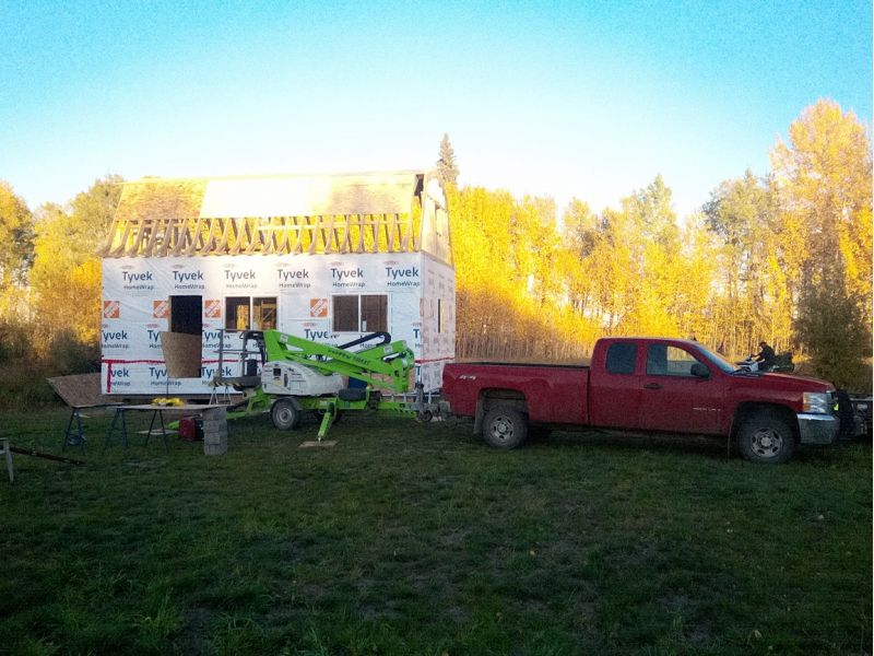

travellerw
# Posted: 3 Oct 2021 02:30pm - Edited by: travellerw
and more!

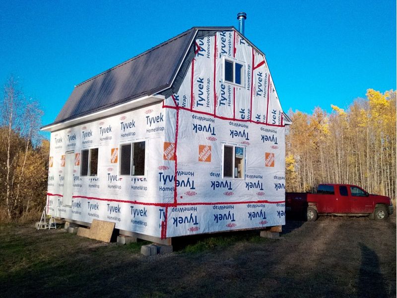

travellerw
# Posted: 3 Oct 2021 02:32pm
and one more!

# Posted: 5 Oct 2021 03:57pm
I bet it feels great to be dried in before winter!
One question - are you planning on boxing in the edge of the soffits under the gables? Looks like a bird nesting paradise to me..

# Posted: 6 Oct 2021 10:32am - Edited by: travellerw
Quoting: BRADISH
Not sure I understand the question. Everything is closed in. The ends of the soffits are sheathed as part of the end wall. All the soffits are even sealed with caulk to keep flies and bees from getting in through the "rib". I guess a mud nesting bird could make a nest under the soffit, but we don't have any of those up here. Plus I don't think the mud would stick to the tyvek.
Everything is 2x6 or 2x8 or 2x10. The entire roof is 2x8. I will use 3/4 foam to make 1 1/2" deep channels from the soffit to the roof vent, then R22 on top of that. I looked into premade baffles (foam or cardboard) and it was actually cheaper to make my own, I get a deeper vent channel, plus I get an extra R4 in the roof.

# Posted: 6 Oct 2021 11:46am
Quoting: travellerw
Ahh - upon closer inspection and zooming in I see now.
At initial glance it appeared that the soffit ends were not flush with the wall - almost looked to be 6-8" out in some photos.
