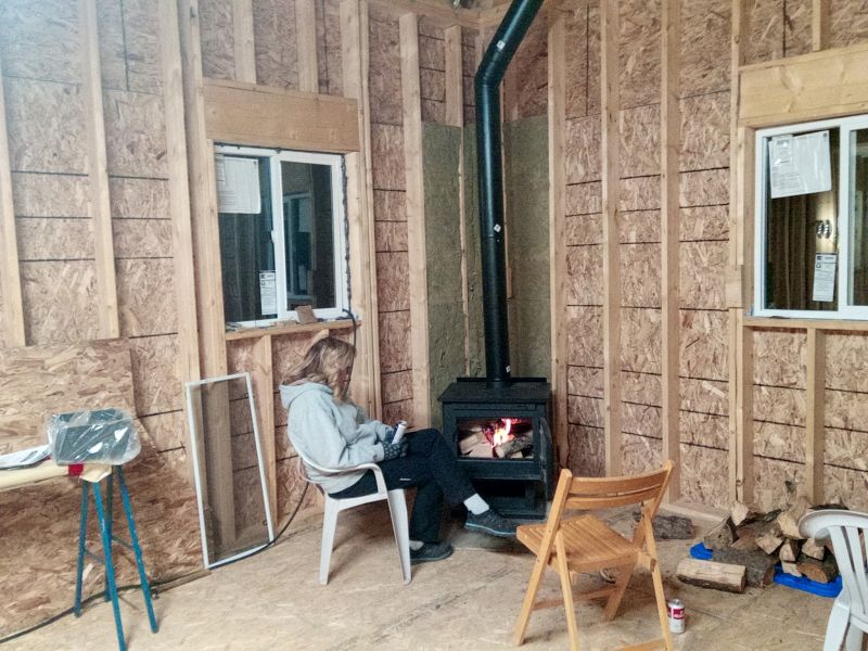

The insulation has begun... but we had our first fire in the stove and spent the weekend in the building. Pretty cool to think that just 2 months ago I handed my kids a shovel and said "Start digging, we are building a cabin". I'm pretty sure they thought I had lost my mind!
My youngest just shakes her head and says "I can't believe a house came from 8 holes in the ground!" LOL!

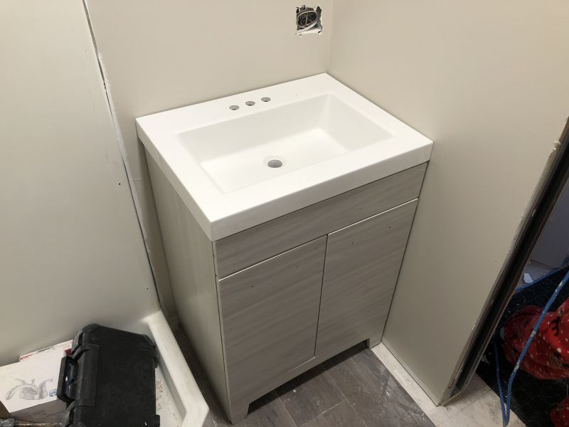

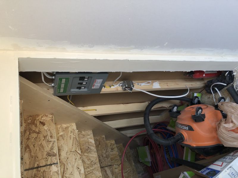

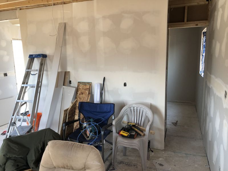

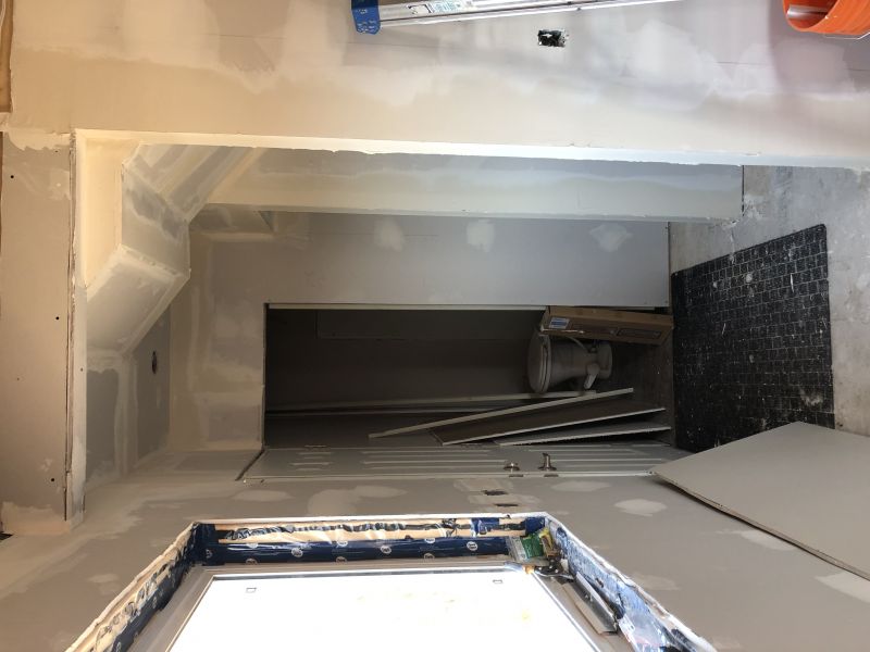

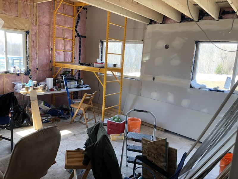

I haven't posted updated pics in a while.. A ton of work has been done since then. All the "rough-in" work is done and we started finishing. Both the bedroom and bathroom are now painted. The plan was to get those rooms finished first, then finish the rest. However, with spring here we will probably just bring the trailer out and start living in that.
Things are coming together now and we are seeing our decisions paying off. We really like the location of the bathroom as it will be easy to pop in from the fire to use the facilities without walking through the whole cabin. We also decided that the loft was too small and have extended it. This also helps with wall tie in, as there is now only 8ft of untied walls. With triple 2x6 header I may leave it that way or possible just add on piece of stainless wire.
Anyway, here are some photos.

# Posted: 24 Apr 2022 10:57pm
Looking good. Until I realized the second photo is sideways I thought that was some kind of wall heater.

Looks great!
How do you like those Baker scaffolding? I have never used them before. Can you move them easy enough stacked 2 high with no wheels?
travellerw
# Posted: 25 Apr 2022 10:29am
Quoting: Brettny
Looks great!
They actually do have wheels (just can't see them in the pics). They are great for the price. I think I paid $280 for the pair at Princess Auto (Canada's version of Harbor freight). Its a bit of a pain since we built the temporary platform in the middle of the open area. We have to take the top scaffold off to move it.
Ya.. I'm not sure why the website turns pics like that. Technically that is a heater.. Its my L10 hot water heater in storage on the floor of the bedroom. With paint cans stacked on top as I'm out of room other places.
