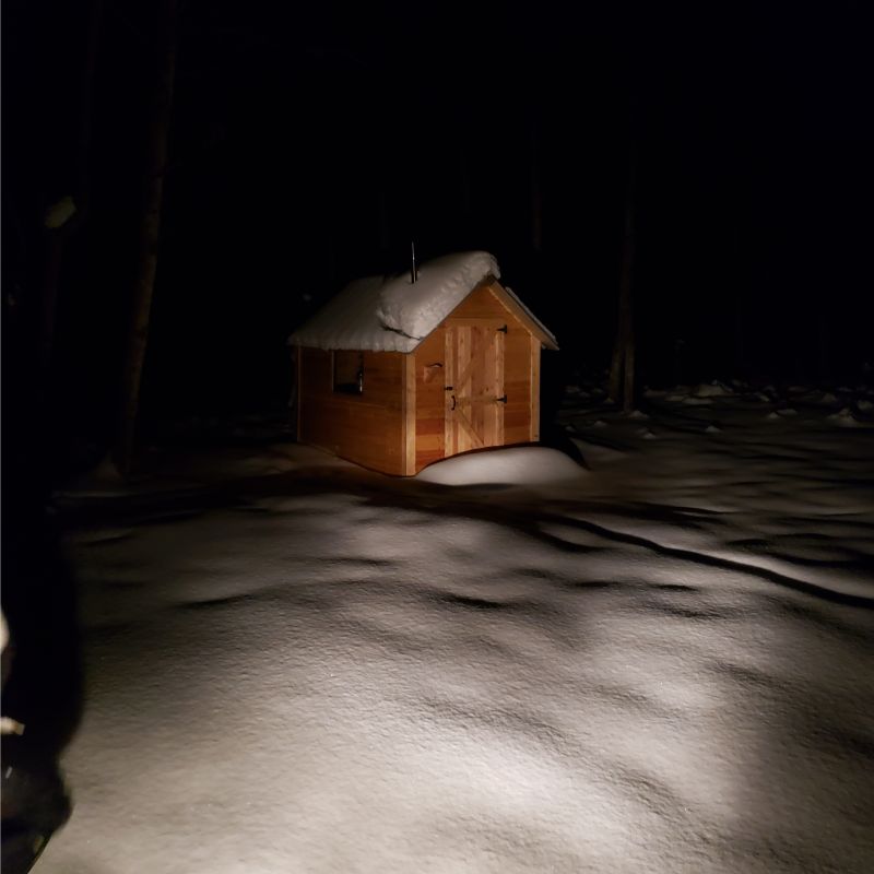

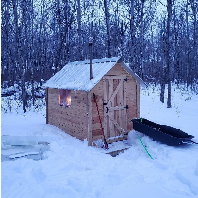

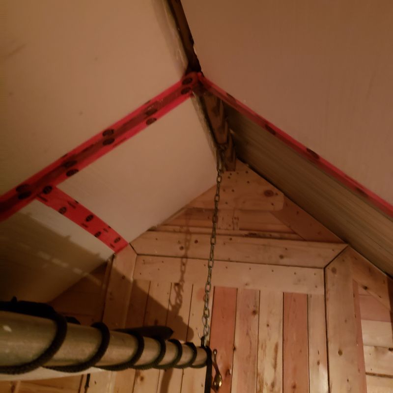

This past weekend my daughter and I headed up to the quarter for an overnight stay on our way to the family farm. The road north of my property was completely blown shut with snow. We stacked the Pelican sled full of styrofoam, tools and overnight supplies, and sledded two miles up the road and across the pasture just as darkness fell.
Once we reached the edge of the forest, I dumped the Pelican sled and we slowly plowed a trail into the cabin. The snow was well above my knees and solid powder right to the ground. The Tundra either bogged down or was constantly tipping over. I resigned myself to walk alongside it until we reached the cabin. Exhausting work! I dropped my daughter off and got the Gstove going, caught my breath and headed back for the Pelican. Way easier going once the trail in was broken in.

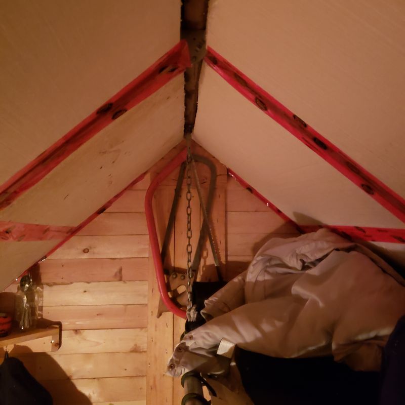

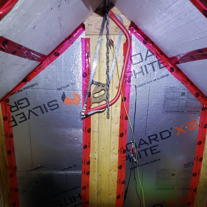

The cabin was pretty snowed in. We pulled everything out and started installing the roof styrofoam between the rafters. I taped up all the seams with tuck tape. There will be a few spots to fill with foam sealant before the ceiling boards go on.

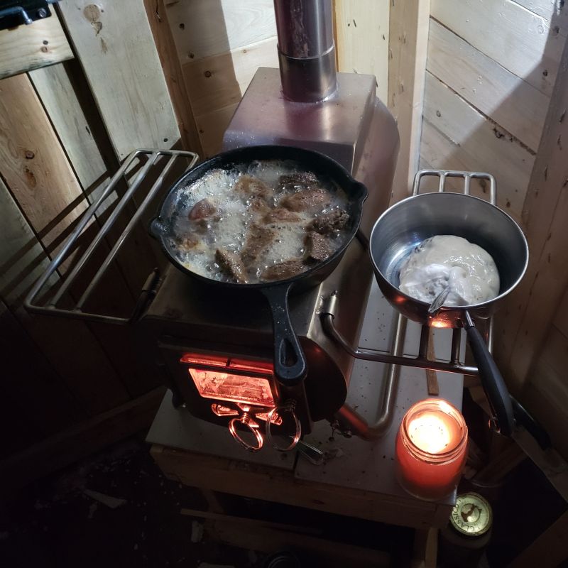

We stopped halfway and cooked some seasoned moose tenderloin in bacon grease, then mixed it into some mushroom soup for gravy. Absolutely outstanding meal. I attacked the rest of the ceiling, finishing up around 11pm.
The insulated roof made an immediate difference. Everything above the top bunk was incredibly warm. The lower half of the cabin is still fairly cool, so I'm going to rig a small 12VDC fan hooked to my car battery to circulate the air inside the cabin. It will have to do until I can pick up a firestove fan.
I didn't sleep so well, as I had to stoke the stove every two hours or so. Daughter was out cold all night long, waking only to mumble/talk in her sleep, haha... The coyotes were howling up a storm at one point, and the nighttime sky was radiant with stars. How quickly I forget how quiet and peaceful it is out there.
We woke around 6am and packed up to sled out. Quite the adventure getting in and out in the winter but I enjoyed every minute of it! Next weekend - snowshoeing adventure time!

Ceiling back
Ceiling back
Ceiling front
Ceiling front

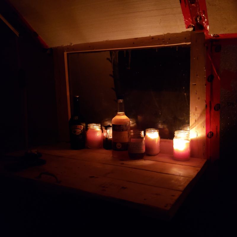

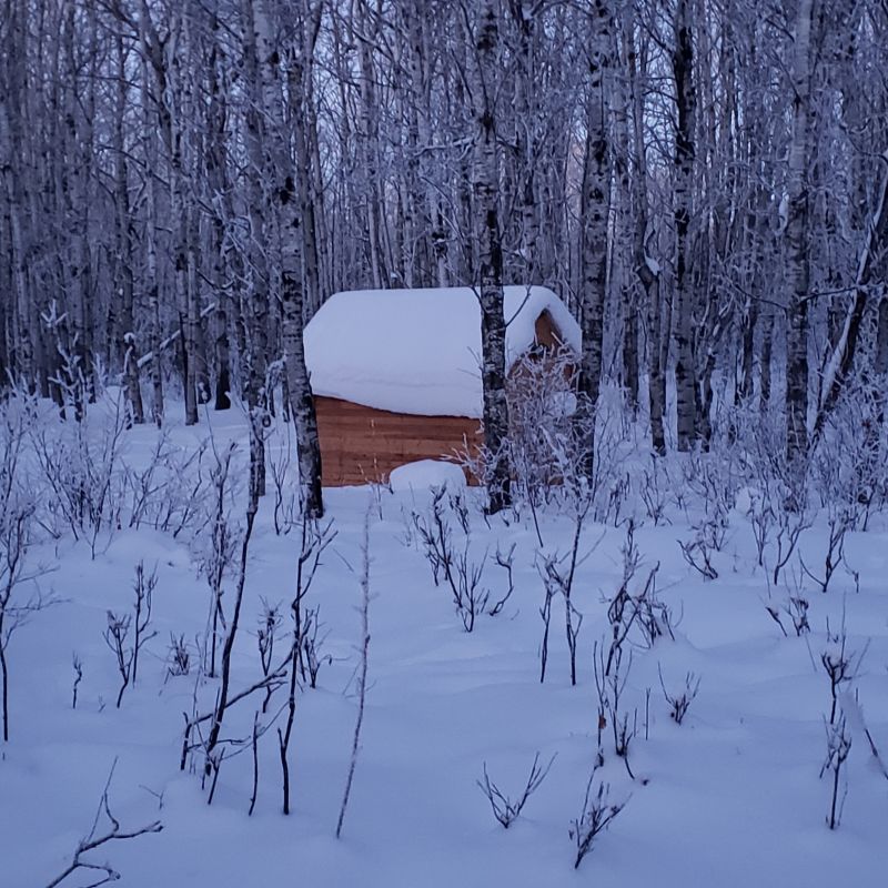

Window at night
Window at night
Winter cabin
Winter cabin

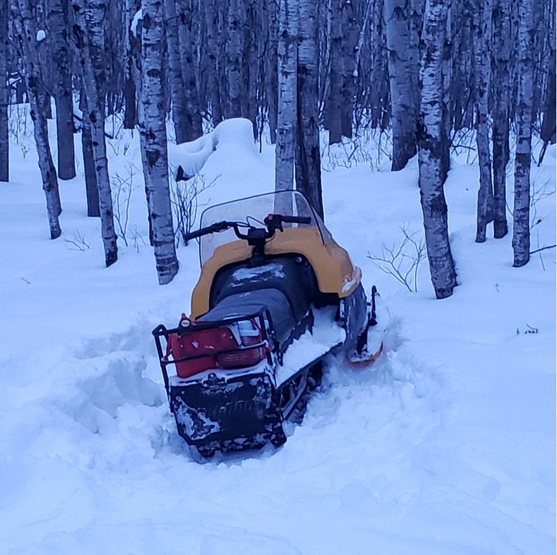

1985 Tundra
1985 Tundra

Surprised the Tundra didn't manage better. The FIL has a 92 and it seems to handle more than I ever think it will.

It certainly is a tippy little machine in deep powder. I'm starting to understand why they were nicknamed "Tumblers". I may be a little oversized for such a little sled (6', 190 lbs) - I'm probably not getting the best flotation out of it. Might have to look into getting a long track machine down the road.
Well, with me at 6'3" and 225 you are certainly in good company. Rather than just a long track, you might specifically look for a 'wide track' option. Not always the most plentiful, but there are certainly options out there. A lot of these options are known for their hauling capabilities, which may serve you well for your purposes getting things/people in & out of the cabin.

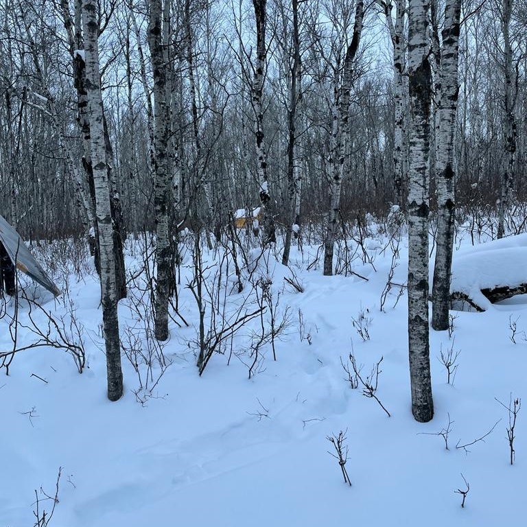

1st snowshoe into the cabin! A friend of mine bravely volunteered to shoe in with me to do some interior insulating. The temperatures were still in the -20c range with deep powdery snow. It was about a mile long hike in from the south pulling about 150lbs of gear on the Pelican sled. We took turns pulling the sled and dragging in what turned out to be extremely awkward 4x8 styrofoam sheets. I still can't decide which was worse.
Once we arrived we enjoyed a nice -20c glass of apple flavored whiskey while the stove heated up. I'd dragged in about 50 lbs of nice dry pallet wood scraps specifically for heating, as I didn't want to be scrounging for local firewood in that deep snow.

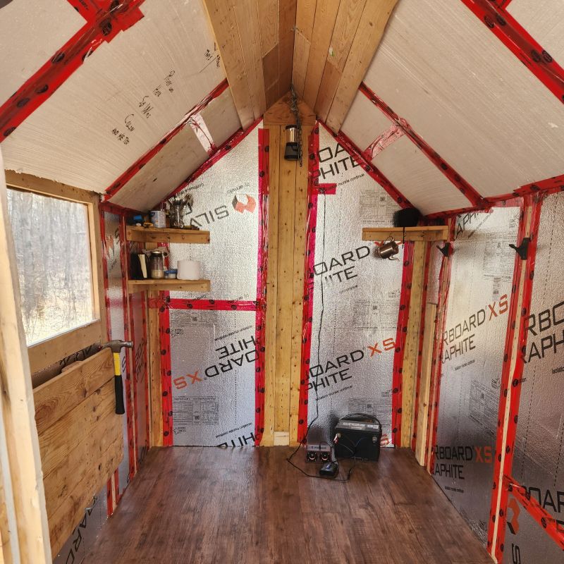

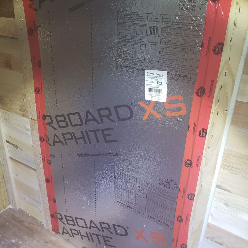

Once we'd emptied the cabin we set to work on the walls. The styrofoam sheets were awesome to work with - only 3/4" thick and easily cut with a box cutter. Once fitted into their respective recesses, I taped them in place with tuck tape which appears to make a nice airtight seal. I plan to come back in the spring and cover the sheets with interior pallet board. Make it look more like a cabin and less like a spaceship...
We insulated and taped every nook with exception of the firestove corner - I'll save that for the spring trip as we didn't want to work around that pipin' hot stove. I was cooking up a moose stew over the stove while we worked and we enjoyed an excellent hot winter meal around 8pm.

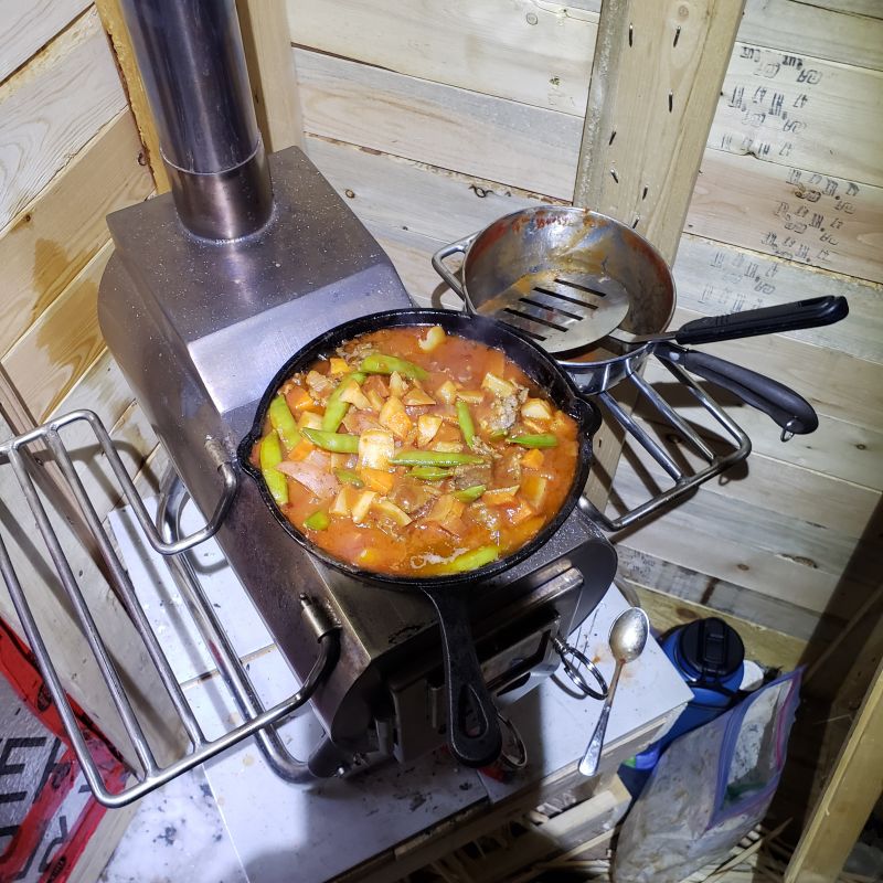

After supper we set up a board game on the folding table and tied into a nice bottle of Saskatchewan whiskey. By 1am we were ready to rack in.

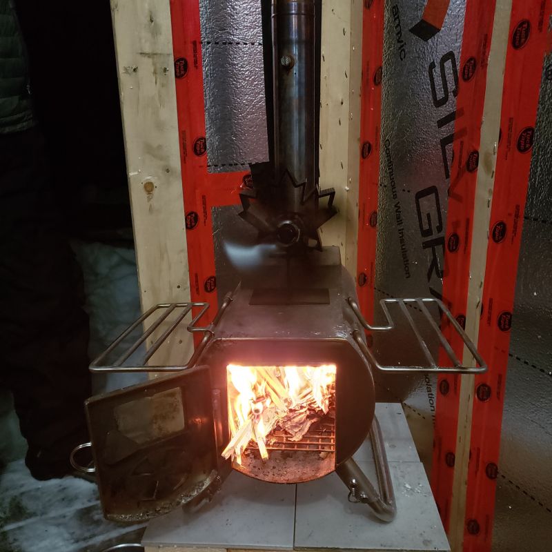

I rigged up my small 12VDC fan off the car battery and experimented with a few different placements to try to circulate the air.
By midnight it was around -30c outside.
I laid facing the stove with a convenient stockpile of pallet wood nearby, so I could stoke it without getting out of my cot. My friend took the top bunk. Apparently it was hot as a sauna in the peak, as he spent most of the night outside his sleeping bag. The floor space under my cot remained exceptionally cold.
We agreed the 12VDC fan was woefully underpowered for the task - it simply doesn't move the air in a high enough volume to evenly circulate the heat. I'm going to watch the Princess Auto flyers and see if their stovetop fans come on sale in the near future.

Fan
Fan

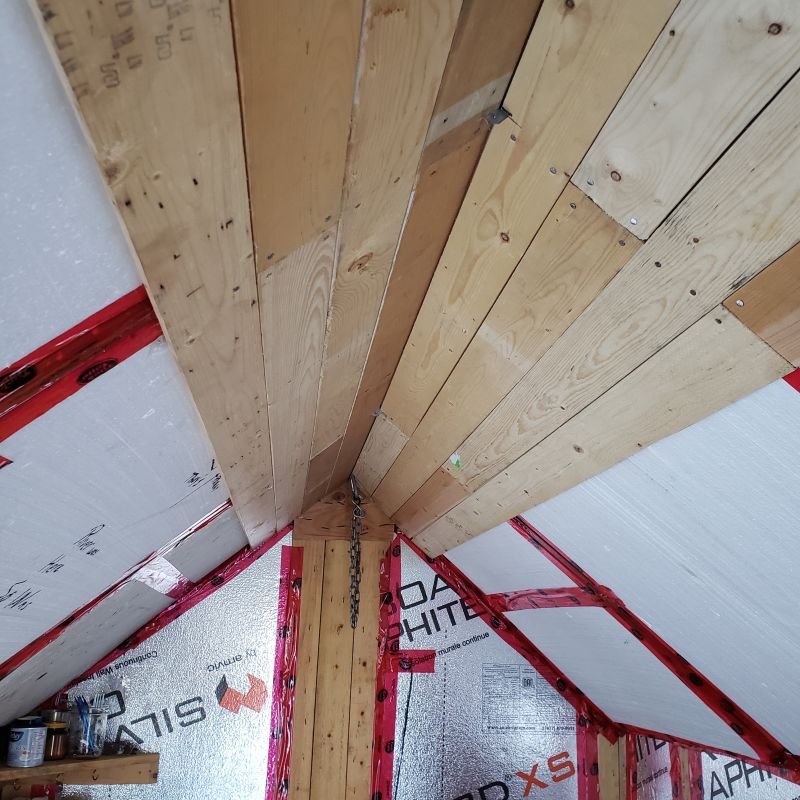

I trekked back to the trailer and hauled in half the wood. The mitre saw made the cuts super quick and I had the bulk of the ceiling done by lunch. I worked the rest of the afternoon siding the back wall, window wall, and around the stove. My third quad trip I encountered a bit of storm clouds and had a few sprinkles of rain to contend with. Fortunately I had a sheet of poly in my tool kit to cover my cutting station...
Crake
# Posted: 3 Jul 2023 10:58am - Edited by: Crake
May 2023 - continued

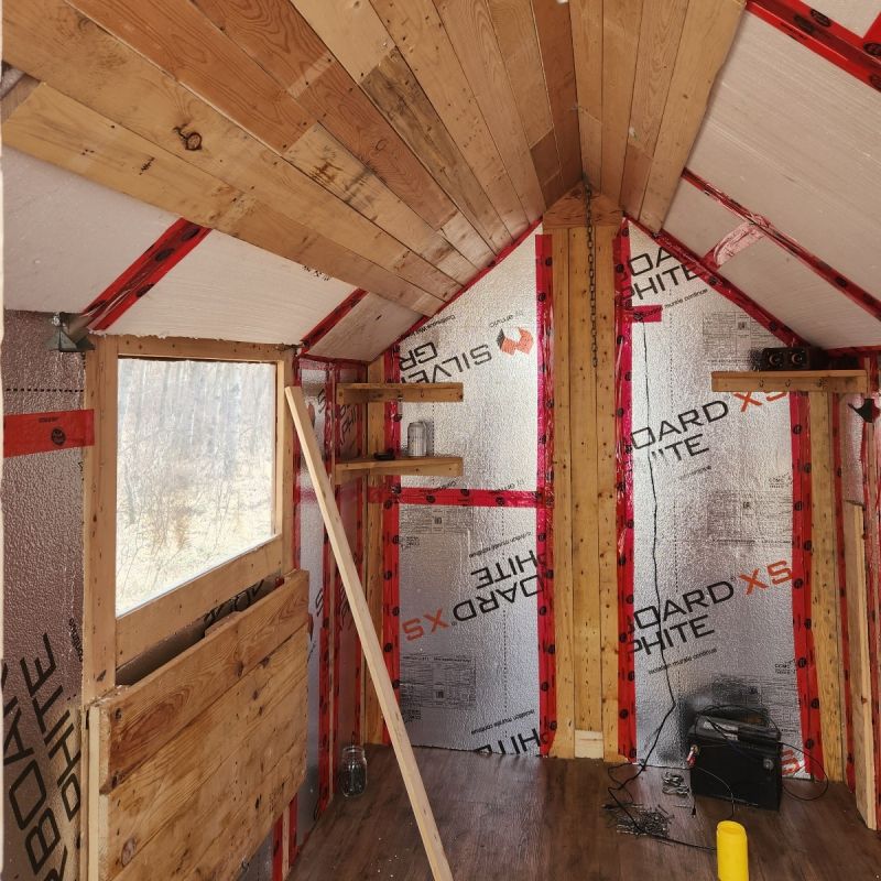

I used ship-lapped boards on the ceiling but didn't bother with the side walls. Heat rises so I'm more concerned with heat loss out the roof than the side walls. Besides, the styrofoam and tuck tape makes more than an airtight seal.
Clean sweep
Clean sweep
Ceiling work
Ceiling work
Window wall
Window wall
