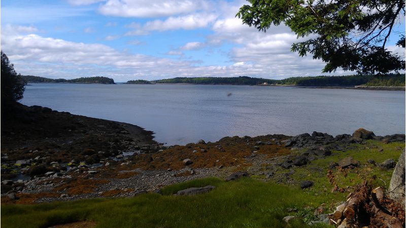

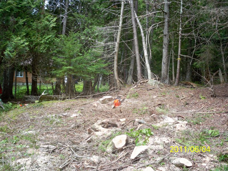

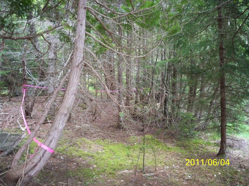

Well guys and gals here we go camp build 2011. Kind of a late start but the plan is to build a 16x24 cabin on the shore of the bay of fundy in new brunswick. abit smaller than what was planned but it is the same size as what were used to. Me and my uncle cleared just the foot print for the camp this weekend and i hope to go down through the week and clear some more. The pictures are of the lot before and after and the view in the future after some more cutting and thinning. i will keep the pictures coming and will be asking all kinds of questions along the way
The lot before clearing
Lot after clearing
Lot after clearing
The future view
The future view

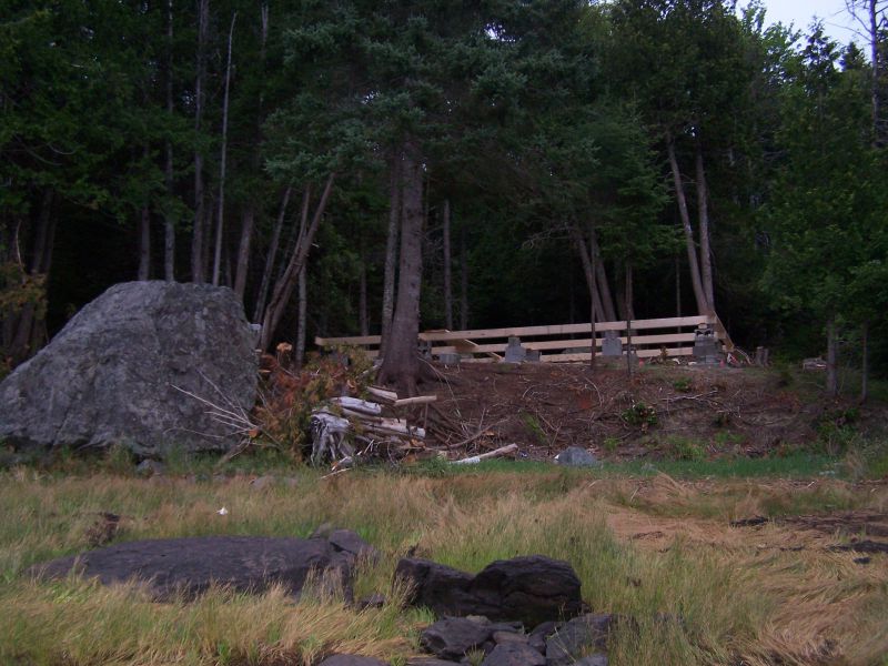

# Posted: 30 Jul 2011 10:43am

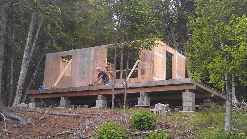

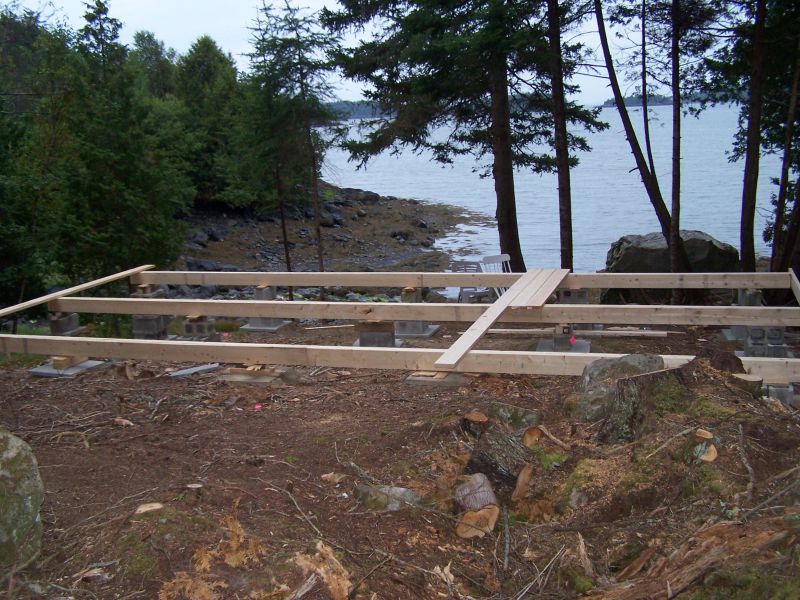

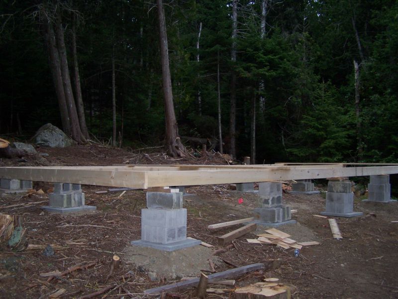

took this week off of work to build the pads piers and carrying beams. got it pretty well done, had the lumber for the floor joists delivered. I'm hopfully gonna build it this week. The pads were a killer to build and level, who would have thought that slight of a slope would be so hard to level. the carrying beams are 2x8x16 laminated 3 thick and the floor will be built out of 2x8x16 with 3/4" plywood.. here's some more pic's let me know what you think.... my friends and my uncle want me to build a deck on the rock and put a hot tub on it.... maybe in a few years.....
foundation 1
foundation 1
foundation 2
foundation 2
rock were a deck may go
volleypc
# Posted: 1 Aug 2011 10:35am
quoddy, It is none of my business, but the blocks you have laid on the side are likely to break. It will be easier to replace now. Good luck with your build.
exsailor
# Posted: 2 Aug 2011 03:53pm
I tend to agree with volleypc. The blocks need to have the cells up or they will not bear the weight you want to put on them. Think of the orientation they set in on stacked block foundation. That is the way they are structurally sound. It doesn't look like too much of a problem to fix it now. Definitely fix it before you build more on top of them. Looks like it will be a good cabin when your done.
quoddy camper
# Posted: 2 Aug 2011 10:19pm
Thanks guys, you are both right... I checked with a friend of mine who is a mason by trade.. He said they should be turned the way you said.. Guess i should have checked with him first. First the bad news, the floor is already built. The good news, the camp is not!!!!! It will make it alittle harder to turn them but not as hard as if the camp was totally built.. This is the reason i joined this forum, i would have left them that way and could potentially run into a disaster... and never knew what i did wrong. I will turn them this weekend and take some new pic's of the floor all done and painted. thanks again guys i appreciate it greatly...
exsailor
# Posted: 25 Oct 2011 02:21pm
QC,
Couldn't you use an automotive floor jack or screw jack to lift the floor at one block pier support at a time. Fix the block orientation, then move on to the next support pier. Since the Floor is built it should be rigid enough to take the stress. Of course you would have to unbolt any fasteners holding the floor to the support piers. It should be fairly easy once you get the first couple done and learn any tricks to the job. Good luck and hope it is as easy as I think it should be.

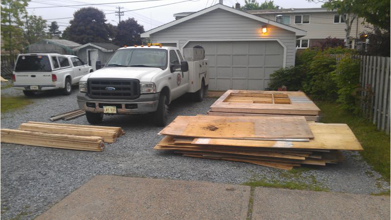

So Here's the plans for the weekend. Tonight set out wall panels and lumber pending pick up by ramp truck 9 am tomorrow morning. In the morning load panels and lumber on ramp truck take to site. No work as it is going to rain. Sunday go back down and take walls to cabin floor and start standing them.... CAN'T FRIGGEN WAIT!!!!! Hope everyone has a great weekend !!!!
quoddy camper
# Posted: 8 Jun 2012 06:29pm - Edited by: quoddy camper
Here's all the stuff ready and waiting for the ramp truck in the morning.
Look at my poor little Dakota straining under the load of all the shingles!!!!!
luther
# Posted: 8 Jun 2012 07:26pm
Good luck with the walls, looks like you prebuilt some. Smart. Should go up very fast.

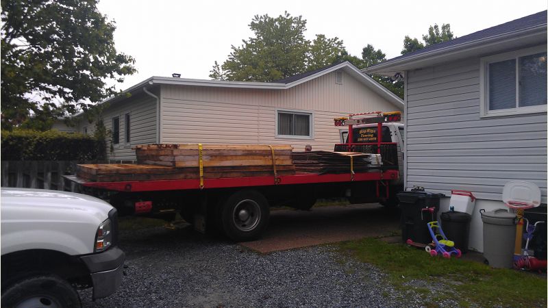

quoddy camper

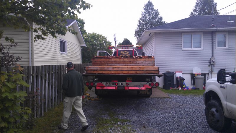

# Posted: 9 Jun 2012 11:14am

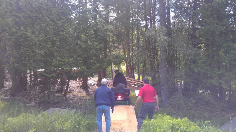

So here's the stuff all loaded on the truck ready to go to the camp..
load up my truck today and head down first thing in the morning to start standing walls

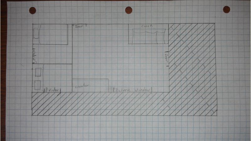

# Posted: 9 Jun 2012 11:18am
here's a rough floor plan the cabin is going to be 12x24 the floor overall is 16x32 so the excess is going to be a wrap around deck!!!!
luther
# Posted: 9 Jun 2012 05:24pm
Looks good, the wrap around deck will see lots of use I bet.

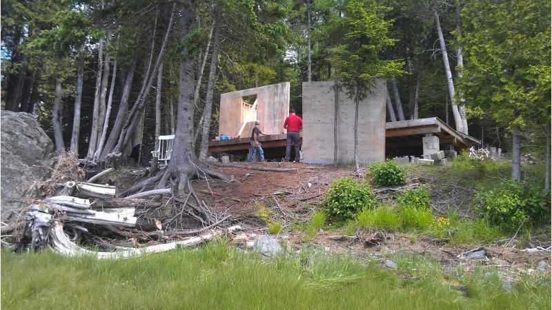

# Posted: 10 Jun 2012 04:13pm
Had a very productive day at the camp with the help of buddies

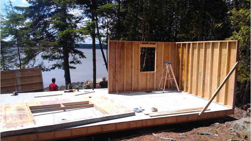

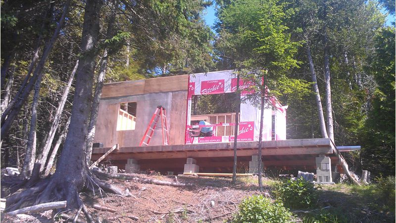

quoddy camper

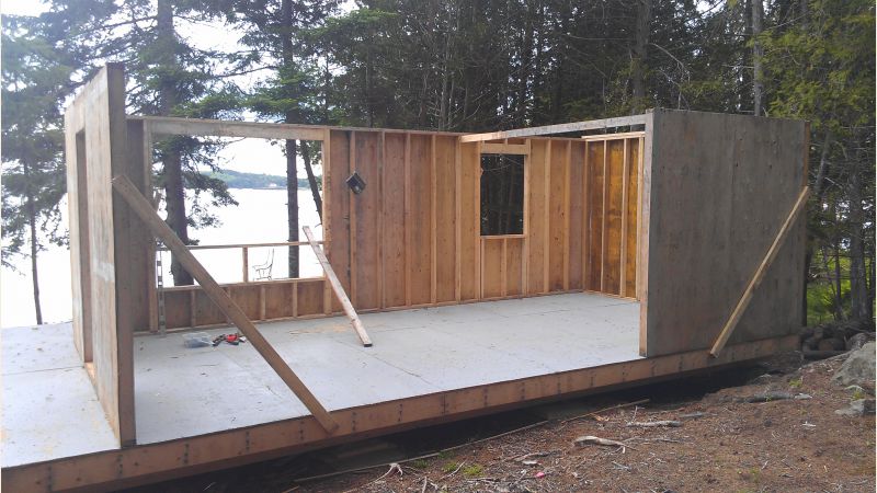

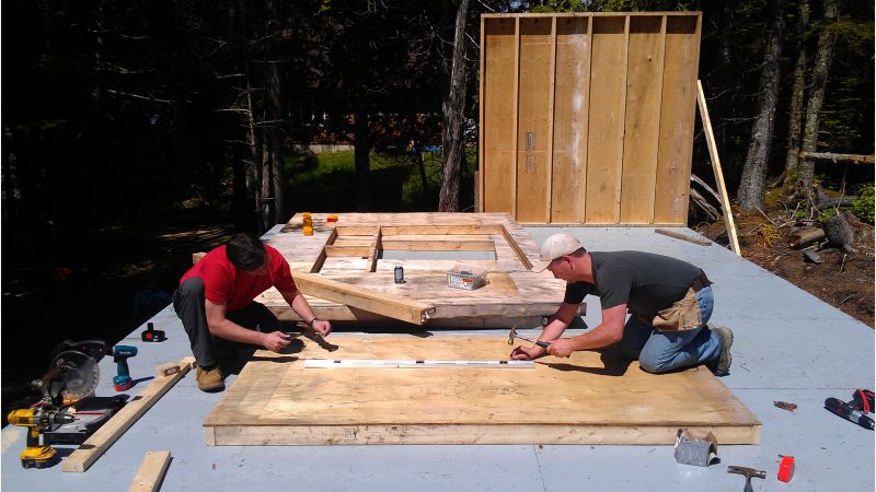

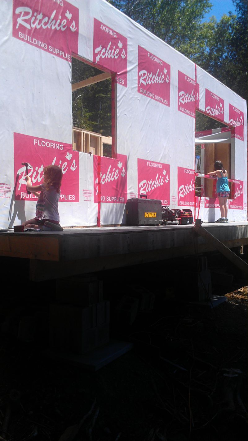

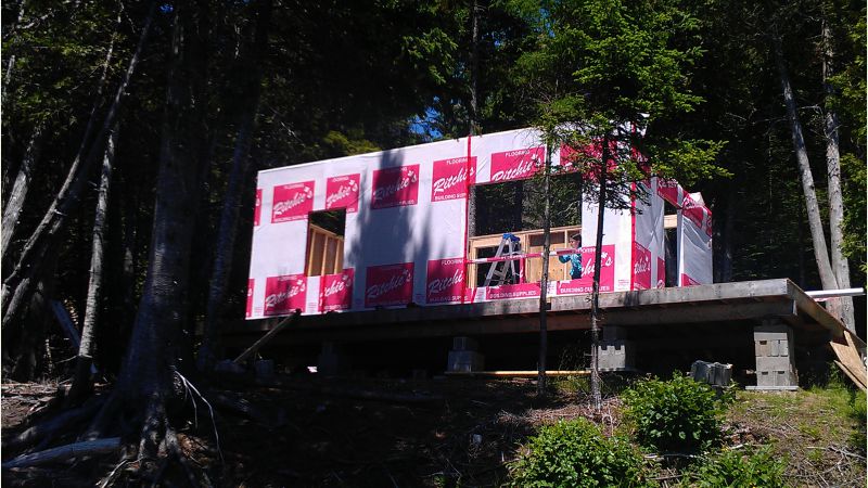

# Posted: 17 Jun 2012 05:25pm
got alot done this weekend, all the walls are done and the front and end walls are wrapped. Also got the front wall extended up to give my roof some slope.... hope everyone had a good weekend and all the dads had a great father's day. Next weekend the roof and doors and window's will go on if all goes well.....
starting to wrap
starting to wrap
cabin and thinking chair
the girls working on cabin
front and both end walls wraped

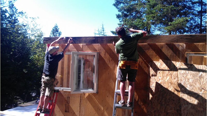

quoddy camper

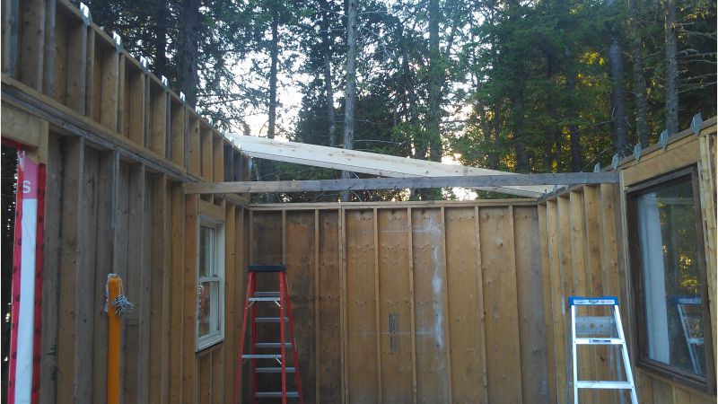

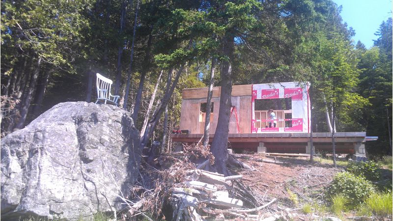

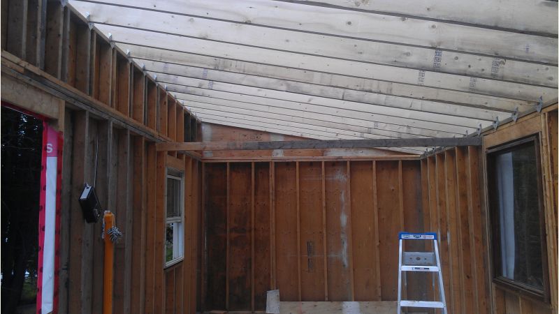

# Posted: 25 Jul 2012 05:20pm
Took last week off and got some more done to the cabin. just have to trim out the door and window's and put the soffit on and it will be offically weather tight
first 2 rafters test fit
All the rafters up ready to be evened up and nailed down
facia going on
facia going on
sheathing and drip edge on
