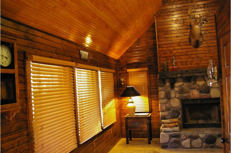

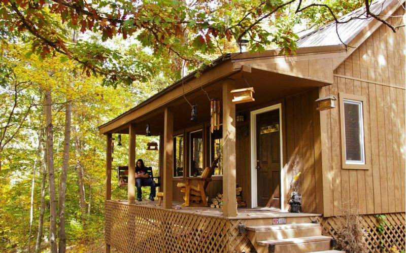

My youngest son and I decided to build a cabin on the farm to have a place to get away. With no plans, experience or skills, we began digging holes in the clay and before we knew it, our cabin was under roof. It's a 16'x24' with a 8/12 pitch roof and a 6' porch. My son wanted a fireplace and I wanted a woodstove in the kitchen; we now have both.
dfosson
# Posted: 9 Oct 2011 08:55pm
Here are a few pictures. It's still under construction but we're getting close to completing it I have a blog I keep up too. http://dave-mancamp.blogspot.com

Living room. Hanging ceiling before putting down wood flooring

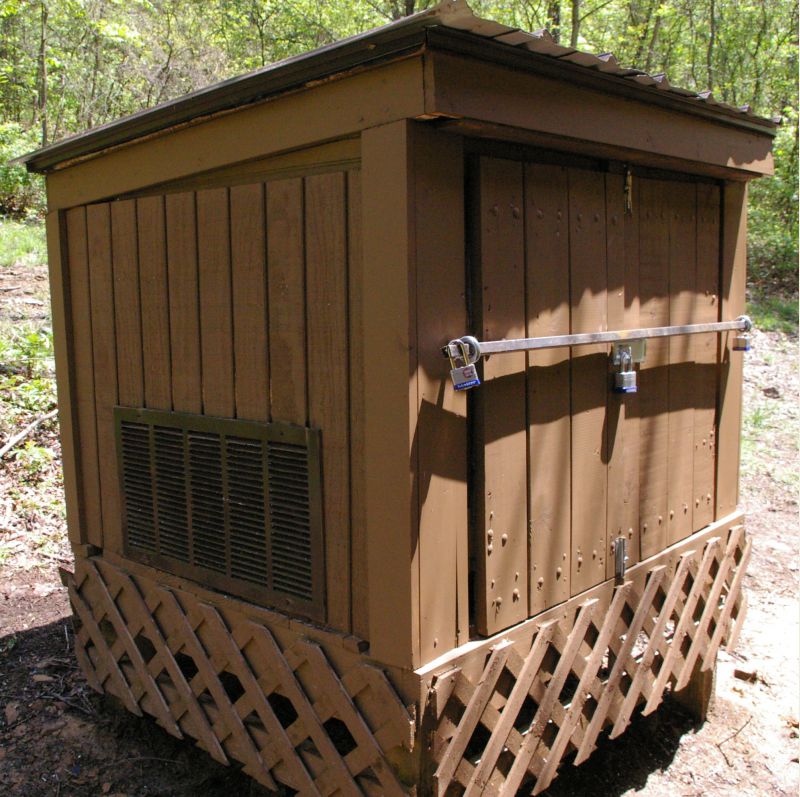

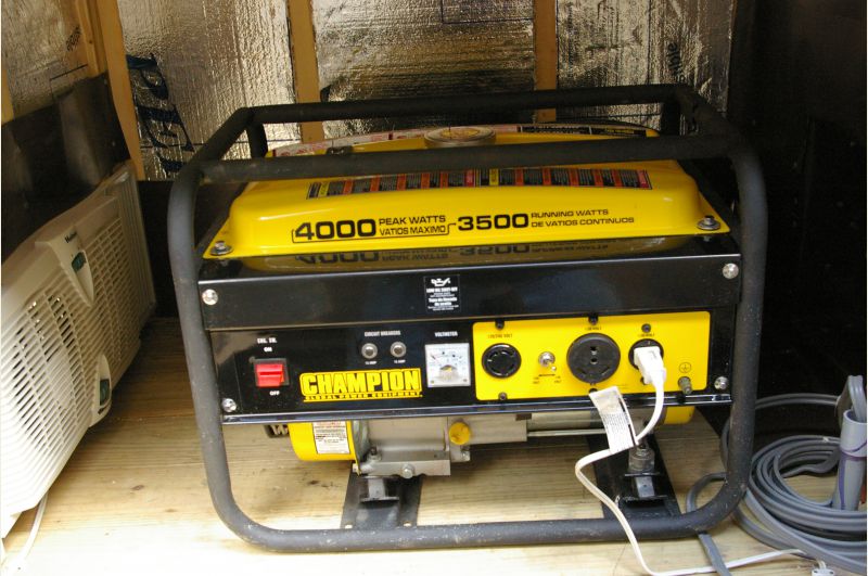

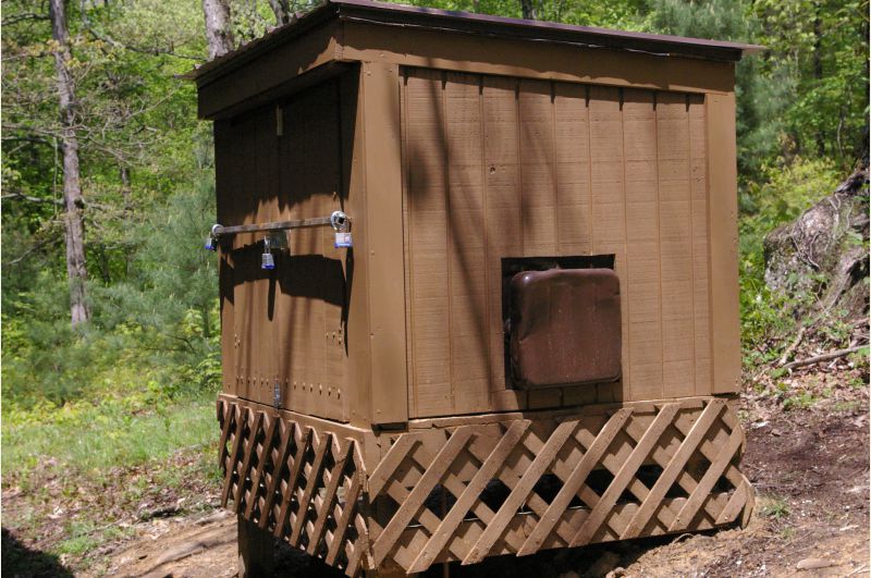

My cabin is off the grid in the forest. At this time power is supplied by a generator but soon I'll install batteries and go solar, too. The generator is a Champion 3500 watt. I built a shed for it behind the cabin and installed dual intake fans and installed an exhaust vent. A remote monitored thermocouple helps me keep track of the internal temperature. The building is insulated to muffle the sound which is well below 20 dB.

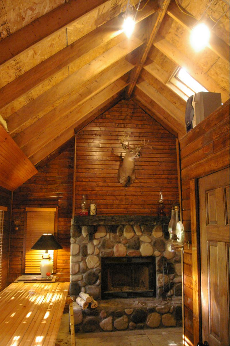

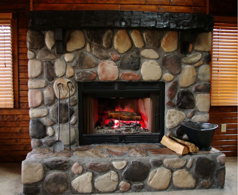

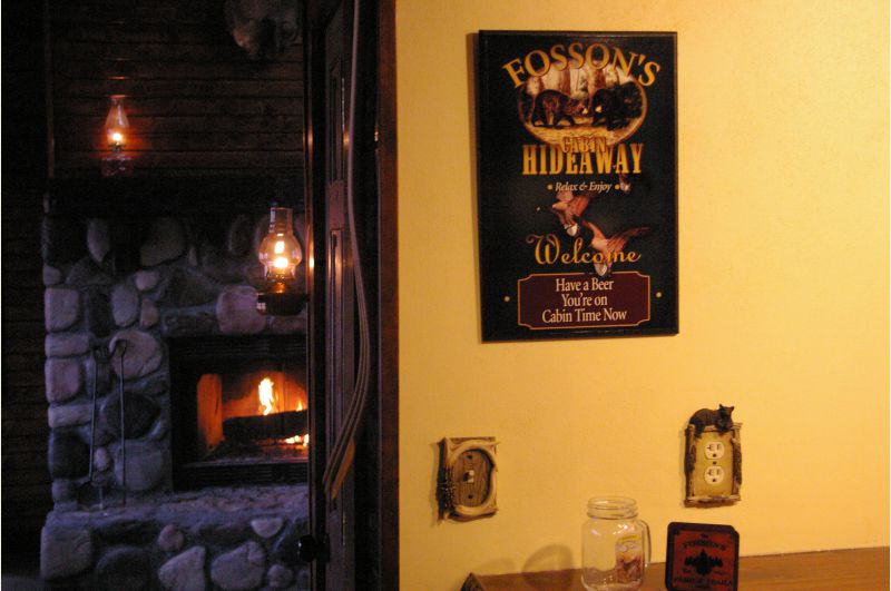

The fireplace is built with stone veneer from Menard's. I used a bath of liquid charcoal mortar color to give them different shades. I also used charcoal for the grout. The stones were sealed once completed. The mantel is a timber from a 175 year old barn that was stained espresso and then sealed. I found a guy selling timbers on line by the foot at the old home site and purchased 7' for $45.

# Posted: 10 Oct 2011 09:36am
Beautiful fireplace and cabin! I see Menards has all your $$$ too! HA!
Any tips for using the stone veneer-we haven't got to that yet but hopefully not too much longer. Thanks.

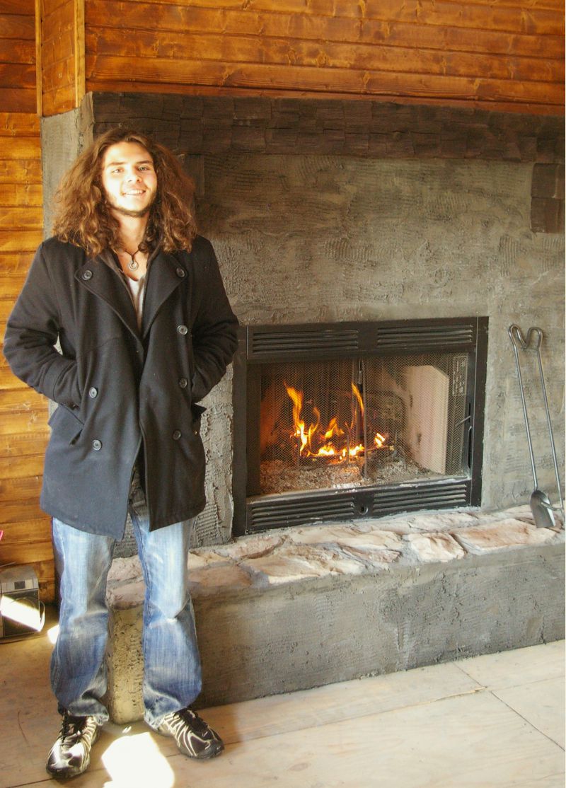

# Posted: 10 Oct 2011 10:09am

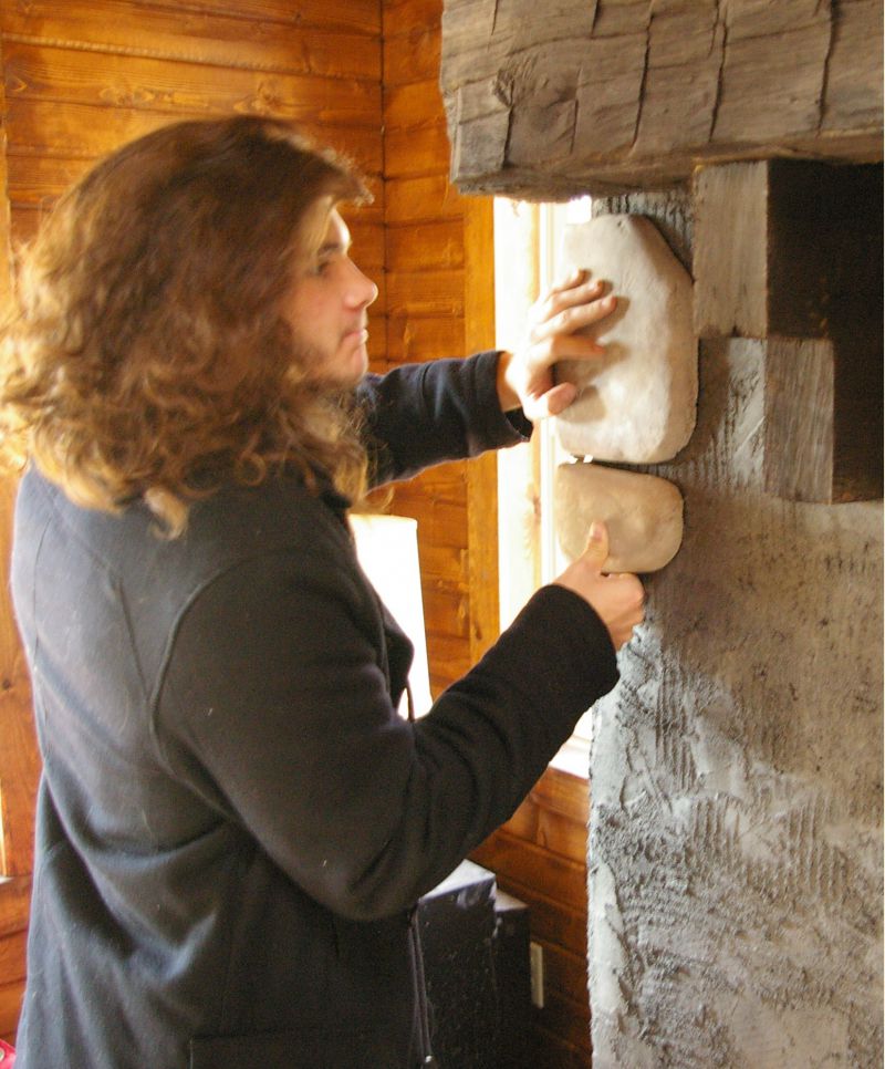

The fireplace was framed in 2x4 studs and covered with 1/2" plywood and OSB. The sheeting was covered with 30 weight roofing paper overlapped at seams. This was just stapled on. Menard's carries the galvanized mesh screen material (it has a name) that was cut and nailed over top of the paper with galvanized roofing nails (don't want rust weeping through grout). I covered the mesh with a thin (1/2-3/4") coat of mortar for a scratch coat. It was worked into the mesh and covered it. Brushed it before it cured to give it roughness. Once cured, a bucket of mortar, a spray bottle of water and a trowel is all you need. Wet the scratch coat and the back of the veneer with water, 'butter' the stone with a thin (1/2-3/4") even coat and press the stone into position. I used mortar specifically developed for veneer from Menard's. You only need to hold them in place for about a minute and they chemically bond. Start at the top and work down. Hope this helps!
Ready for paper, mesh screen and scratch coat
Nic checking out the fit of a corner stone
Nic with the scratch coat

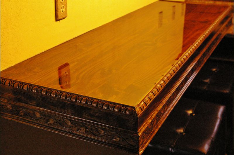

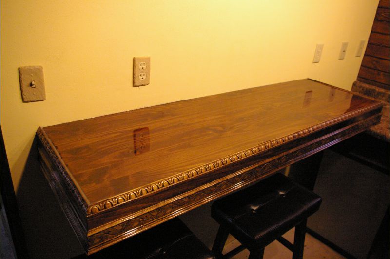

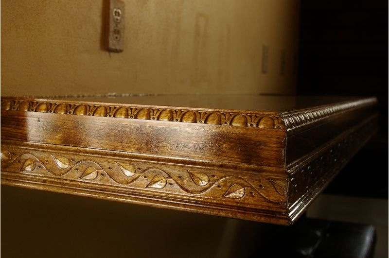

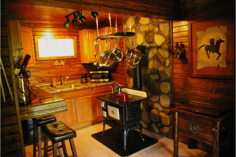

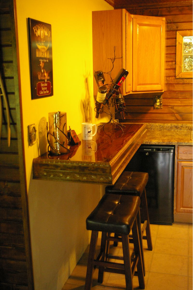

In the kitchen, I built an eating/drinking bar on one wall to save space. Before I sheet rocked the wall, I bolted 2x4 studs to the wall studs to then frame the bar with once the wall board was up. I used 1x6" finished aspen for the sides and aspen on the top. Using just basic chair rail and crown trim and a early american stain before applying polyseal and acrylic made it look old. Total cost $60.

Thanks-it does not sound difficult. How long would you say it took for the scratch coat to cure? Also we were going to do something similar to your charcoal bath to change the color/add to our stones. We picked them up at a reuse center but I want more dark grey and this batch had a lot of pinks left over. I am really excited to get to this project at our place but we are still working on outside stuff before winter. What did you do for your charcoal bath?

The scratch coat is a thin application and is water based so it should be dry in 24-48 hours. If your like me, that won't be a problem as I need a little down time between projects and retooling. I found the liquid mortar color in bottles at Lowes. I just guessed and used a throw away roaster pan to mix the water and coloring. I let them soak and brushed it on the surface with a soft paint brush. Once they were darkened, I just set them off on the floor to dry out. Once the stones are installed and grouted, it will take about a week to fully cure. Coating the whole stone work and grout with a brushed on clear stone sealant will permanantly seal the oxide to the stone so you don't get dust when you touch them. I bought the sealant at Menard's for about $12 quart and had enough to do the stone on the fireplace and kitchen.

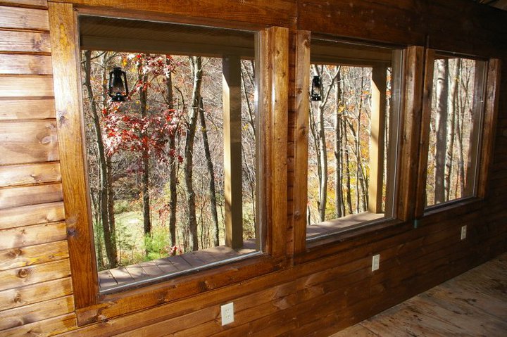

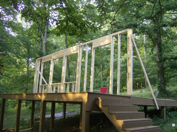

Thank you Hattie! Everything we try doing on the cabin is a first for us. Our cabin plan started when my next door neighbor changed out his front windows in his house. I asked what he was going to do with the 3 large windows he placed on the curb and he said they were going to the dump. I sat on the porch and sketched a cabin with these 3 windows in the front room and asked by son if he would like to build a cabin and everthing started coming together. We've paid an ignorance tax for not knowing what we're doing. Lots of overkill in construction. You could drive a semi on the foundation.

Thanks for the info about the mortar wash and scratch coat. Now I know that it will basically be one weekend to install mesh and scratch coat and let that cure,then another weekend to do the stones. I also thought you used some sort of sealer for it. Our stone will be in the kitchen so we wanted to seal as well. Good to know Menards has what we need. May have to take a road-trip to Lowes sometime soon-we don't have one in our town.
Is the process the same for outdoor applications? Thanks!

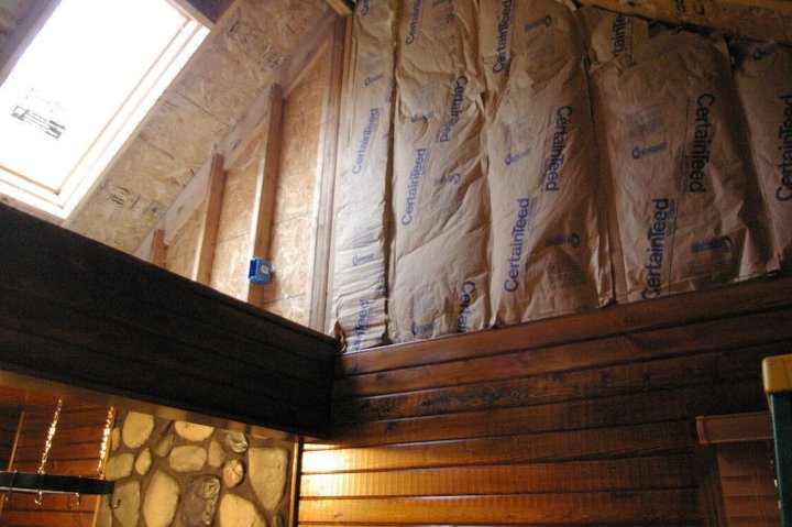

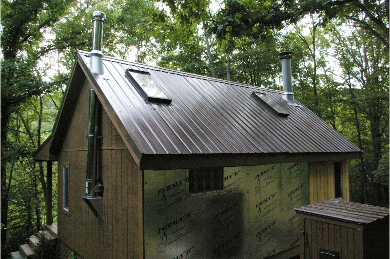

A few more pics. I was very worried about all the roof penetrations for skylights and chimneys. I was so paranoid that I waited about 6 months to start closing in the ceiling just so I could watch for any signs of water intrusion. I thank my brother Don who has a log home company in North Carolina and builds homes for a living for recommending "Through the Roof" sealant. First, I liked it because its clear and doesn't have that ugliness of most roof sealants. Second, I like the way it goes on and cures out. It is like motor honey (for those that know what that is). A foam brush applicator works welll with applying it to seams and joints. They say you can apply it to wet surfaces but that wasn't necessary. One thing I do know is that it works and looks good; you can't see it.
Backside of cabin being sided

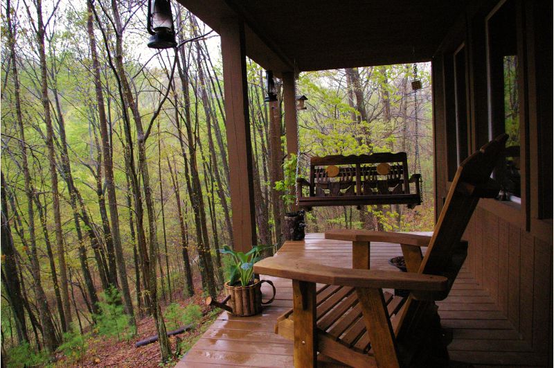

As we planned our cabin project, there was no doubt it would include a porch. I can't imagine building a cabin without one. There is so much pleasure in just going and sitting and observing nature and it's beauty.

What a great cabin! I love all of your decorative touches- and the fireplace is so inviting. What did you use to get the high gloss finish on the breakfast/eating bar? We'd like that on some counter tops and bought some liquid resin sealant that is supposed to look like that but we haven't tried it yet (need to stain them first.)
Thanks!
dfosson
# Posted: 12 Oct 2011 04:49pm
It is a liquid resin sealant that comes in 2 equal parts that you mix prior to application. I bought it from Menard's in the paint and stain department. Once you pour it on and spread it around, it flows until level. It took about a week to fully cure though.
# Posted: 12 Oct 2011 05:09pm
Do you remember how much it cost?
dfosson
# Posted: 12 Oct 2011 06:25pm
Enough to do the bar was under $20.

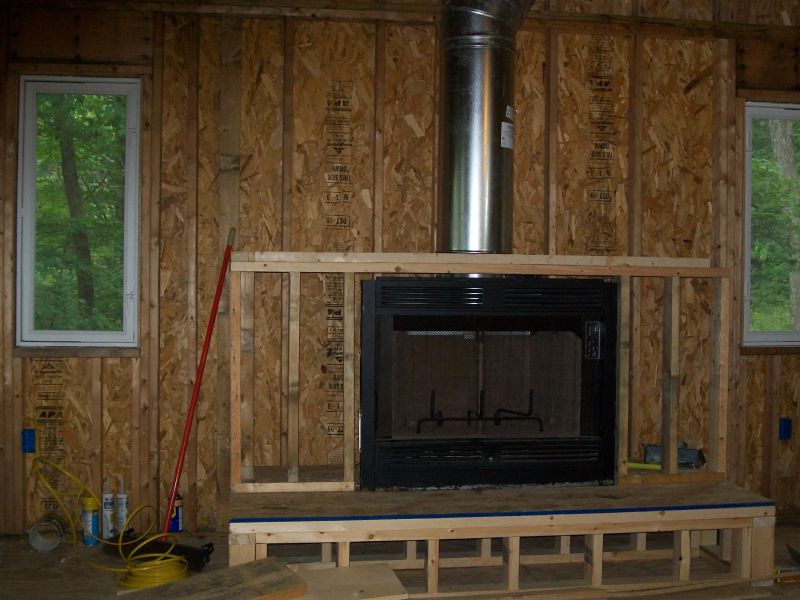

Found this picture of the fireplace being framed in.
