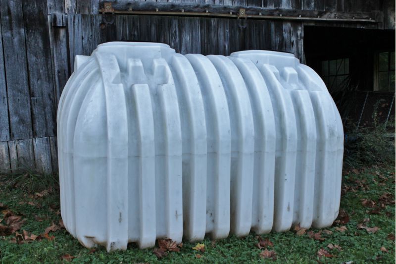

  So happy to pick up a 1200 gallon cistern to collect rain water off the cabin roof.

  Nice Cistern. Are you going to bury it? Let me know how you end up using/plumbing it. I'm still trying to figure how how to do mine.

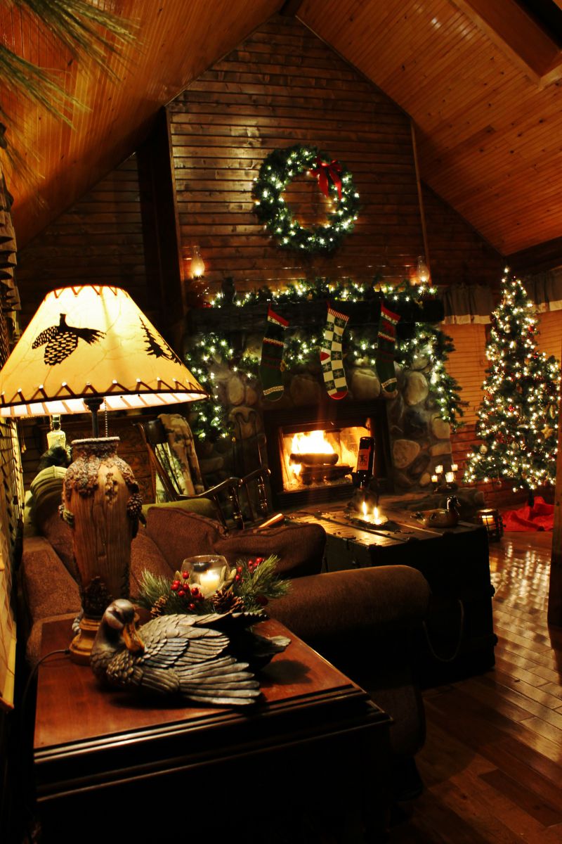

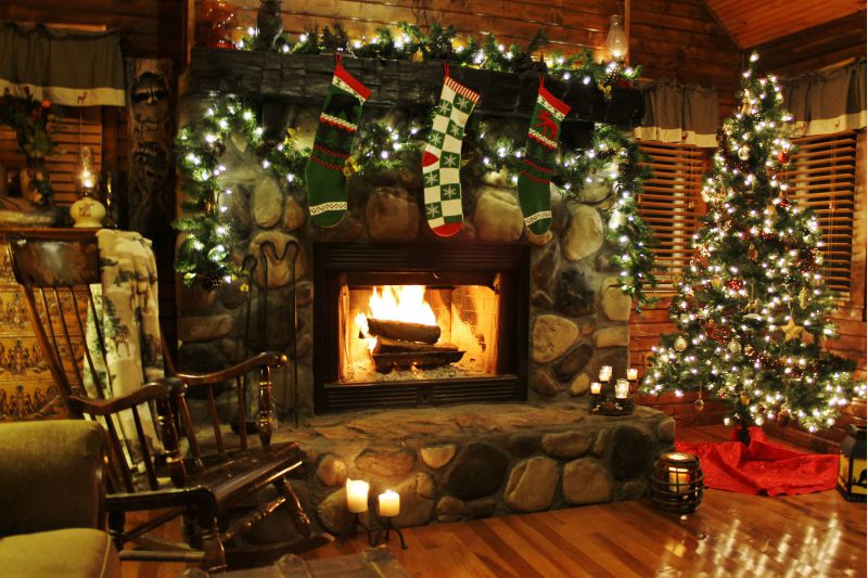

  Getting the cabin in the woods ready for the holidays. Hosting a few "Santa Hunts" for little children that hike with their parents into the woods and 'find' Santa at the cabin. Really like LED lights for off the grid lighting during the holidays. Seasons Greetings.  Table for two

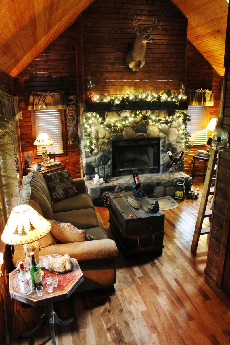

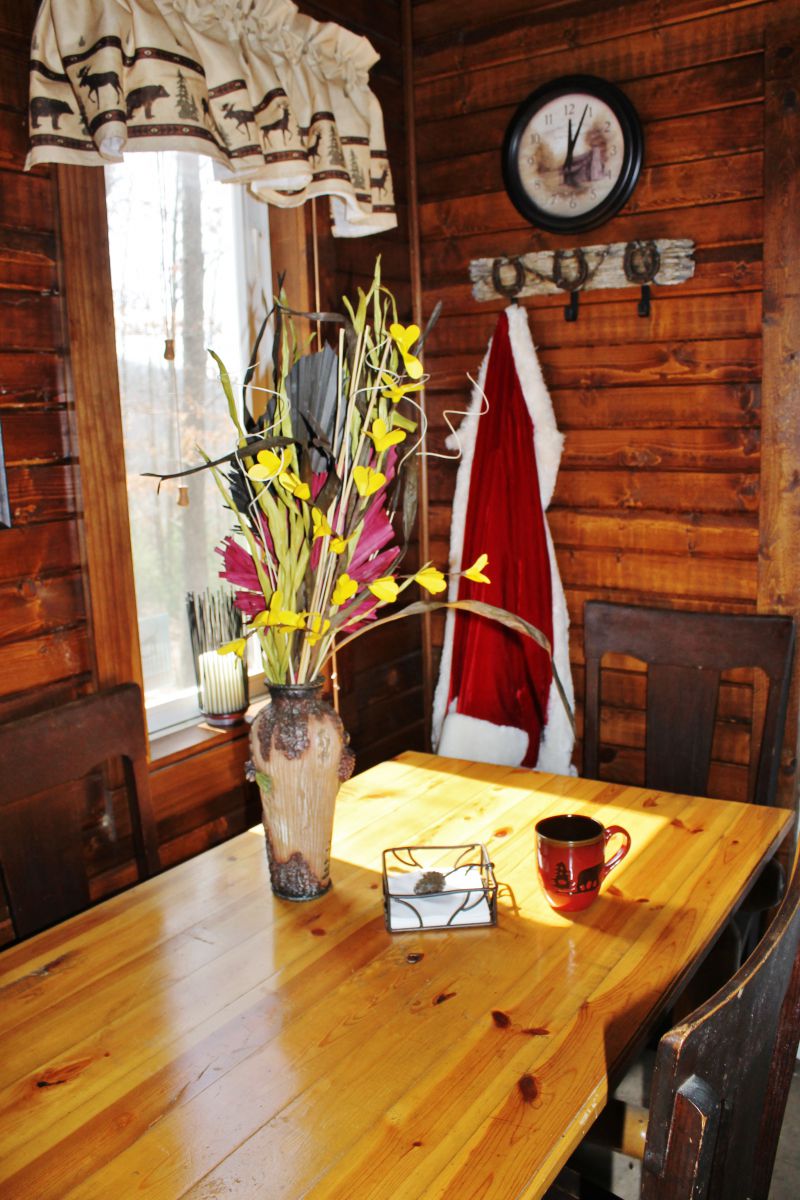

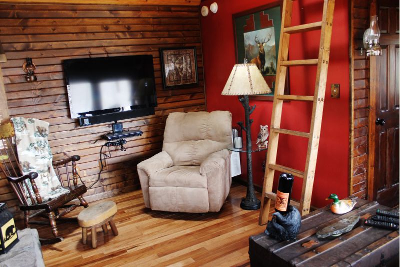

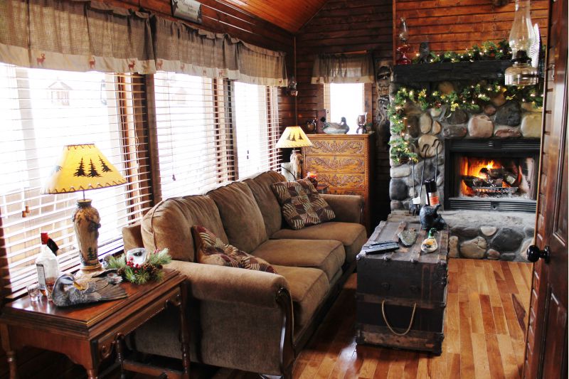

  Spring cleaning out of the way and ready for SUMMER around the corner. The feel of the sun, breeze and spring aroma in the woods makes having a cabin such a reward.  Spring's sun in through windows

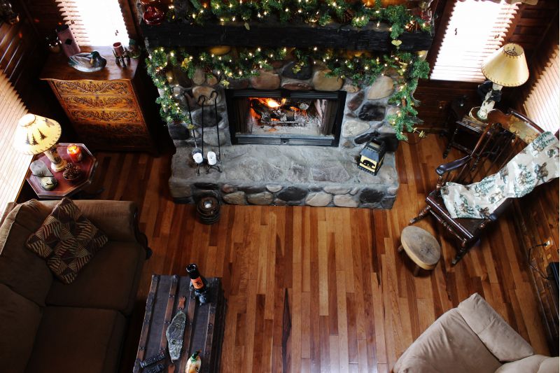

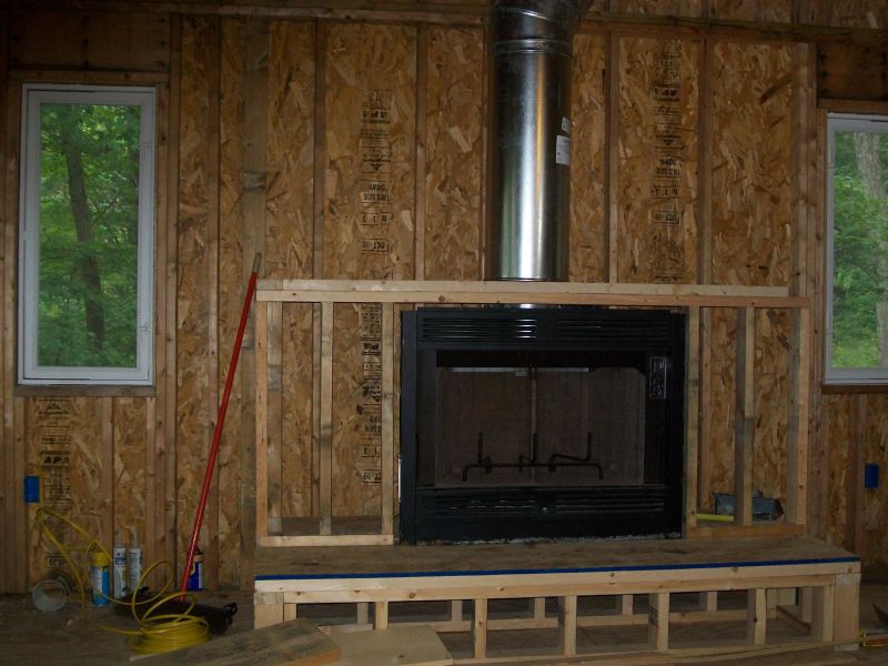

  dfosson - i really like the job you did on your fireplace! Was this a big job? I may do something similar, would you mind going over how you did it?
  thx much!
  Steve
dfosson
# Posted: 26 Apr 2014 09:42pm - Edited by: dfosson
  WeekEndHack, it was actually pretty simple. Bought a firebox that could be within 2" of combustable wall; framed up and covered a platform with OSB to set it on. Put insulated locking chimney pipe up; one 30 degree joint to miss the ridge beam. Framed and boxed it in. bolted the mantel base to the framing and then boxed it in with OSB. Covered it with 30 lb roofing paper, metal mesh for scratch coat of mortar. Used stone veneer but coated them with a slurry of mortar coloring oxide (brushed it on and let it dry). Buttered the stones with mortar and stuck them on the scratch coat. Colored some mortar for joints and filled the joints with a mortar bag and smoothed with fingers. Once cured, sealed it with semi gloss clear stone sealant. Took an old hand hewed barn beam and stained and sealed it with semi gloss poly. Cost about $600. Got the fire box off Craig's List for $200.  Fire place finished

  Just curious what you used for a ridge beam and how did you support it?  I am building a 16x28 and would like a similar open ceiling space but I am stalled in the design trying to come up with a ridge board vs. ridge beam to support the rafters.
