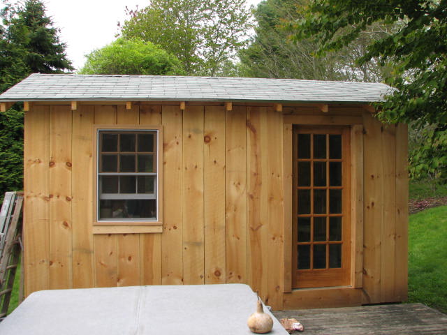

Here are some pix of my wife's studio. It was done with no engineered wood; all the wood was from the local mill. It was cheaper than the Big Box junk and the effect was much nicer. Roof being put up with 1x10 rough
|  Interior
|  exterior
