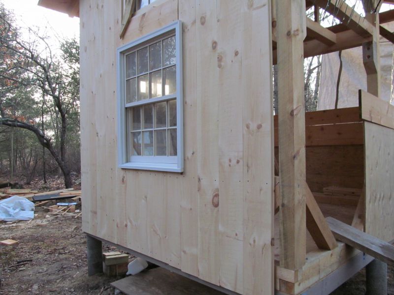

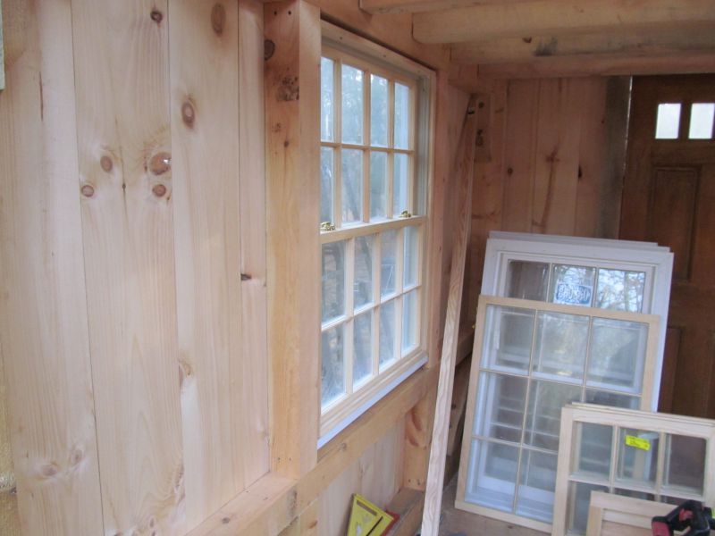

As an alternative to OSB I am using ship lap pine board. They look great and smell nice.  Interior
|  Exterior ship lap

That looks great! I did my interior gables with pine. We 'shiplapped' the boards with the table saw. One thing (I was told) about pine, the heat of planing makes a surface glaze from the sap, and you have to let it weather for awhile or it won't take a stain (or blotchy). Or I think you can sand it just prior to staining.
I'm hoping to build a bunkhouse (for guests), and I'll do it with all boards too. I'll use board/batten style, probably fir or cedar. If any USB it will be entirely hidden (!) but that's just my style.
