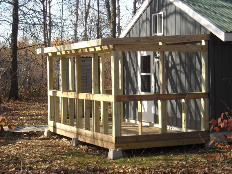

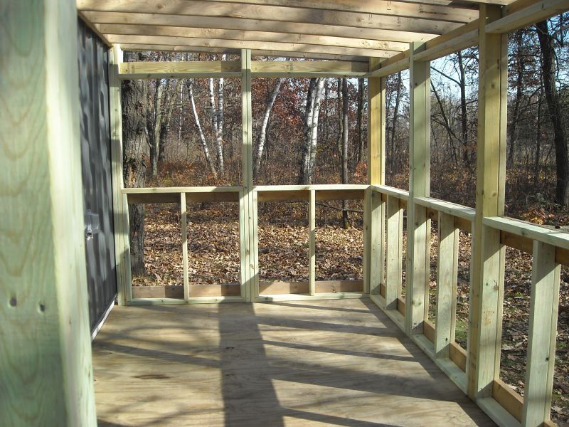

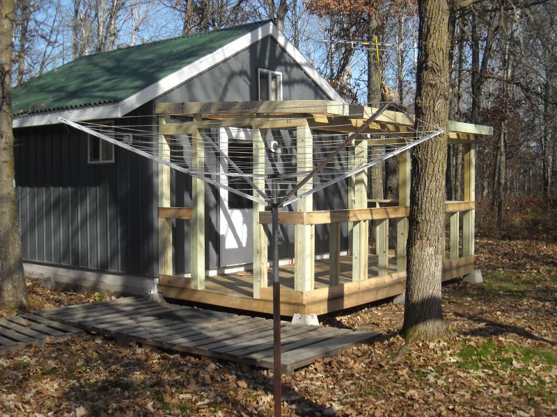

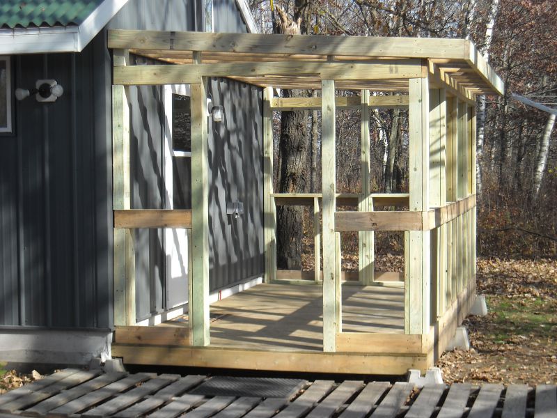

# Posted: 22 Dec 2012 01:40pm
Here are some pics of the 8x16 porch after it was framed. I have since sheeted it, added a roof and windows.
Frame of porch 8x16
Frame of porch 8x16
Frame of porch 8x16
Frame of porch 8x16
Frame of porch 8x16
Frame of porch 8x16
Inside of porch
Inside of porch
Josh
# Posted: 22 Dec 2012 01:45pm
The roof rafters of the porch were from the crate that the metal siding for the cabin came in. They were 18' 2x6 boards i cut down to size for the rafters. Just kind of a way of reusing something and making it into something else.
