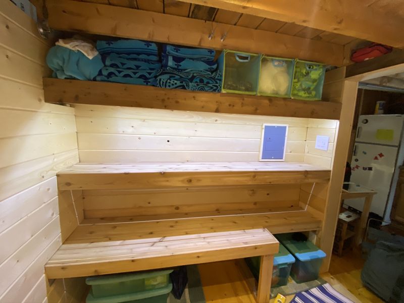

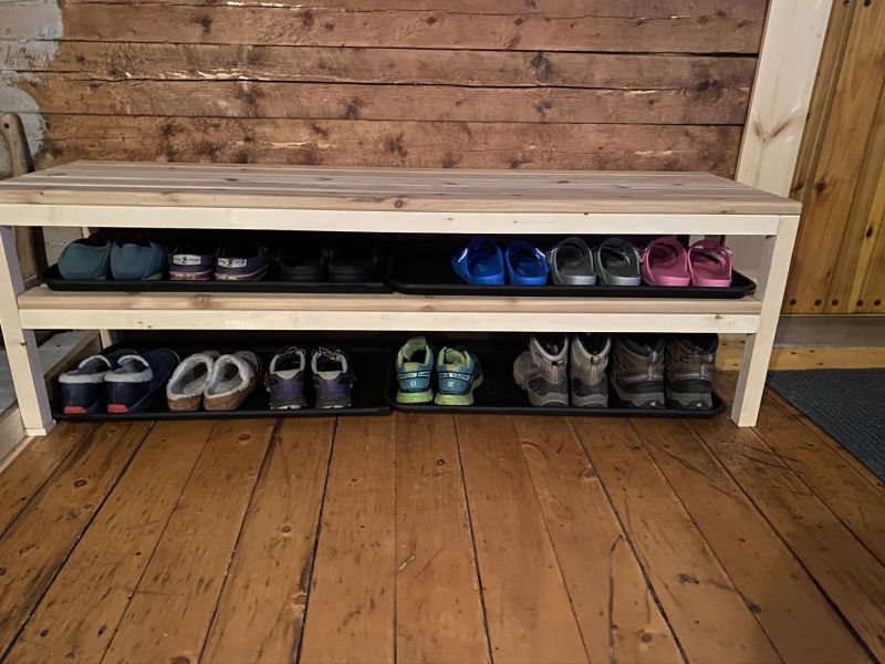

Well I’m having problems attaching from flikr.![725DE187A745427C8.jpeg 725DE187A745427C8.jpeg](https://www.small-cabin.com/forum/shared_files/uploaded/2154/136515_1.jpg) 725DE187A745427C8.jpeg
| ![0D86BA3FF87742B08.jpeg 0D86BA3FF87742B08.jpeg](https://www.small-cabin.com/forum/shared_files/uploaded/2154/136515_2.jpg) 0D86BA3FF87742B08.jpeg
