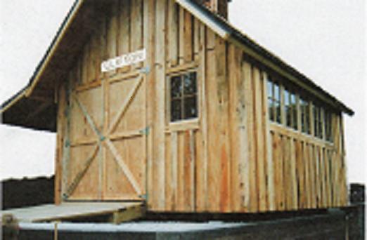

Weather permitting we will be standing the walls this weekend. We are now thinking about rough cut board and batten siding for the outside. Should we use sheeting under the rough cut boards? Any suggestions???
# Posted: 31 Jul 2012 16:45
I do. Wind bracing is the benifeit or stiffness, also it keeps bugs out. Even smooth 1/2'' plywood works. Here's one I did.
