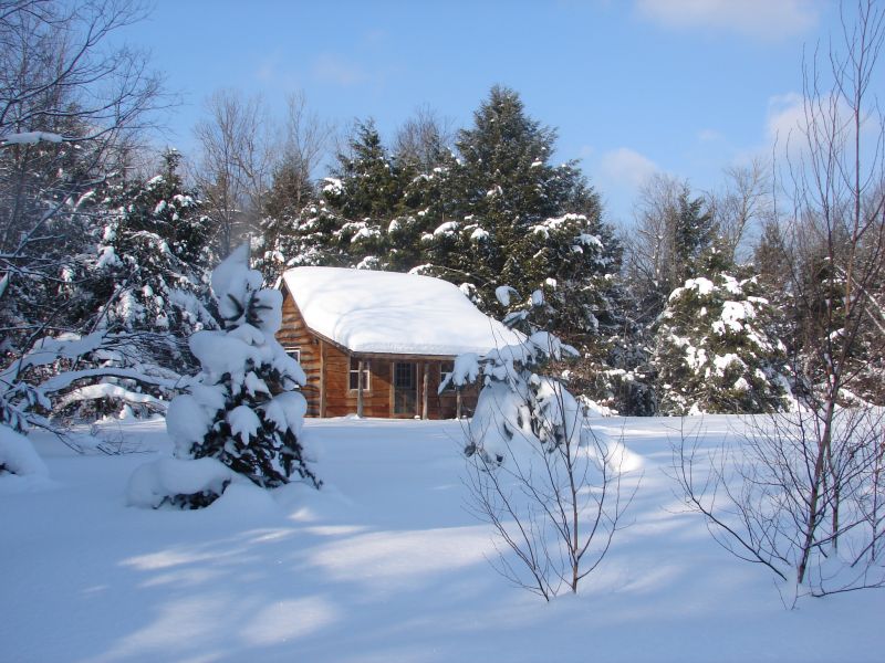

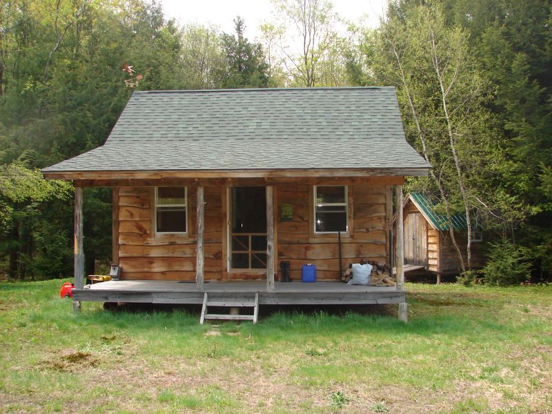

I'm new to this site and its just great! I bought 17 acres with a 16x20 finished cabin and storage shed in upstate NY earlier this year. I wanted to share some pix.
I don't have running water but there is a dug well on site. The cabin is wired for generator. I don't want to run pipes but would like to have a steady source of water, and was thinking of an old fashioned hand pump. Does anyone have any ideas or ever installed a pump like this?
Thanks!![cabin in snow cabin in snow](https://www.small-cabin.com/forum/shared_files/uploaded/226/1230_1.jpg) cabin in snow

That is a very nice cabin! Winter picture is especially beautiful. Thanks for sharing.

Really love your cabin. My wife and I are building a 16x20 this summer. No loft and a bathroom so getting everything in is a tight fit.
Lots of questions: Do you have a sketch of your floor plan? Do you have a loft? Are you pleased with your Century stove?
I would love to finish with wood on the outside but we are in range fire country and will have to use cement siding and metal roof.

# Posted: 6 Jan 2011 22:18
What a beauty! What is your snow load? We're near Claryville and will begin building in the Spring, do you know how we find out what our pitch should be?
# Posted: 6 Jan 2011 22:50
Your county should be able to advise on expected snow loads, or what load to build for. That info can also be gleaned from snow charts in the IBC and IRC code books for most parts of the country.
Then the rafters can be sized using tables or the AWC calculator. That snow load can be entered into the AWC calc.
If the rafters are properly sized for the expected load you can pick whatever pitch you like. Not everyone wants the snow to slide off. Sometimes that can be dangerous and builders will even go to the trouble to install devices to prevent snow sliding off. As long as the roof is built to take the load it is okay. There are examples of that all over Austria and Switzerland for example.
If a cathedral ceiling is involved the rafters will likely be oversized anyhow to permit the use of thicker roof insulation.
