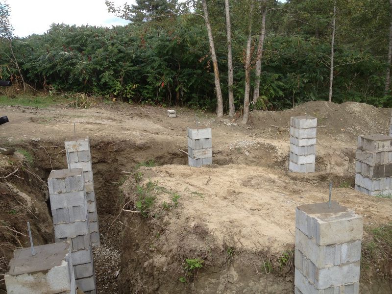

Well I finally get to post my own cabin building (at least partially built) story after reading all the other great postings. We have been camping (pop up trailer) on some old family land for almost 3 years most summer weekends and the odd week or two. The kids have a great time at the lake and we wanted to move up to a cabin but have been dealing with silly legal issues for all this time. It looked like it was finally sorted out so, plans in hand, I booked off the complete month of August and started to get ready. Naturally things did not go as planned and the permit was delayed by nothing more than a surveyors report that had not been filed. It I ironic considering how much trouble many have in getting permits while here it costs $50 and takes about 10 minutes. The only serious rules involves septic (using out house and grey water pit so we cannot have pressurized water) and distance from waterfront. I had decided to outsource the foundation to a local crew but, when the permit finally came in, the rain hit so, by the time the foundation was ready it was already 15 August.
So my 72 year old father-in-law and I started building! We went from this

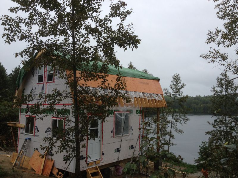

[img=https://picasaweb.google.com/lh/photo/GaKHG3HDgEwtCZCLWYdvKEadDhpNKS2UEIrK3DRP4A A?feat=directlink]End of Week Two plus[/img]
in 16 days including bad weather on one day off).

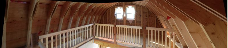

Main Loft
Main Loft

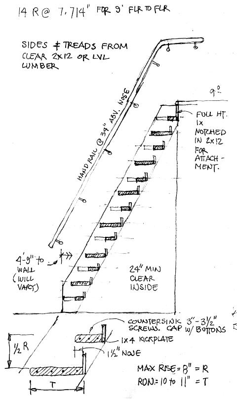

Rayyy, a while back I think you mentioned plans for an alternating tread ladder but was not able to find your "build site". Do you still have plans. I'm struggling with ladder or stair configurations for the two lofts. I think my wife and I will just use a vertical ladder but was considering an alternating tread design for the kids.
Sustainusfarm
# Posted: 5 Sep 2012 10:46pm - Edited by: Sustainusfarm
Raz, Here are a couple alternating stair designs... I hope to build one of these at my place...one of these may be Rayys??

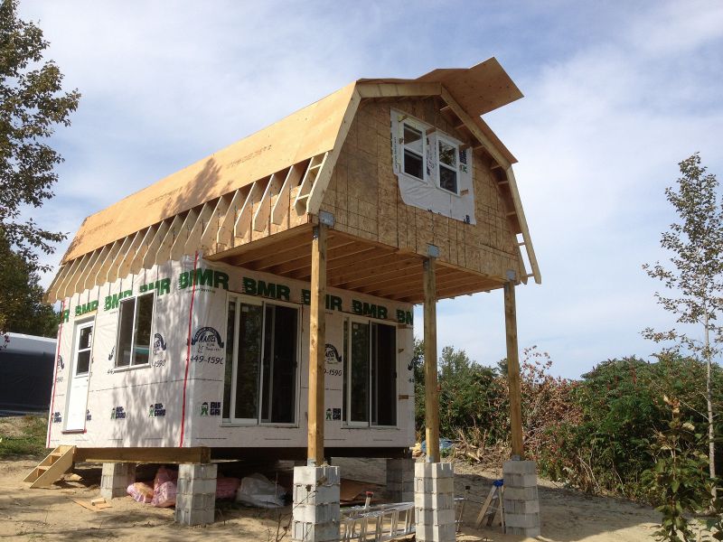

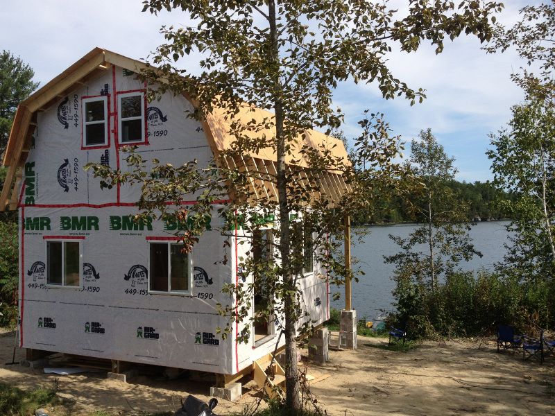

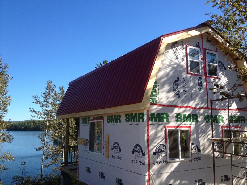

Being at was at my regular job, I had brought in a crew to put the steel on the roof. We had lots of bad weather and thunderstorms throughout the week so they did not get much done. I went up on Friday afternoon to prepare for a forecast of heavy rain by putting a tarp partially over the roof and then coming up with other ways to keep out the water. Not sure the exact amount but somewhere like 40 mm (1.5 inches) of rain fell on Saturday but inside stayed fairly dry to I was able to get started on the wiring. Naturally my wife has since added some design requests that will change things a bit! This weekend we hope to start on the deck.
Storm Ready
Storm Ready

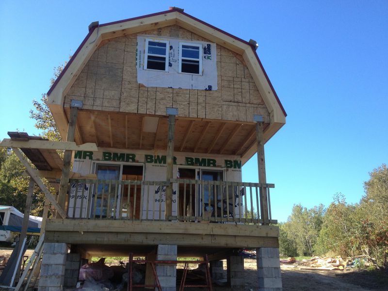

We left the kids with the grand-parents and my wife and I went up to the cabin late Friday night. The roof was supposed to be complete but the workers had been facing some bad weather. We arrived in the dark - pulled out the lanterns looked around. It seemed like the roof was complete but the scaffolding was still up. Inside we found water coming through in at least two places - not good. Blew up the air mattress and had the first ever sleep in our cabin. In the morning it was clear that the roof was not yet complete so, hopefully, explained the leaks. This was later confirmed by the workmen - hopefully it will be finished today!. More to follow in next post ..
Roof Near Completion

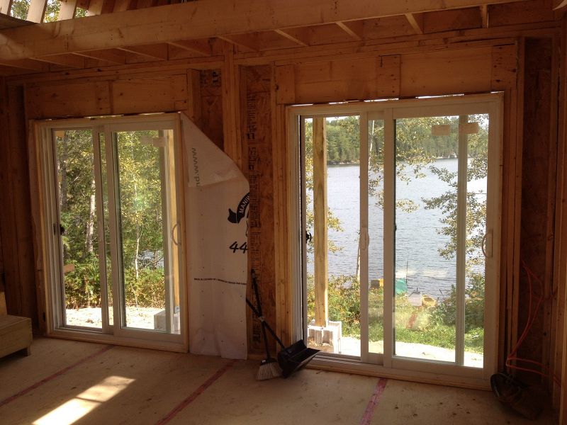

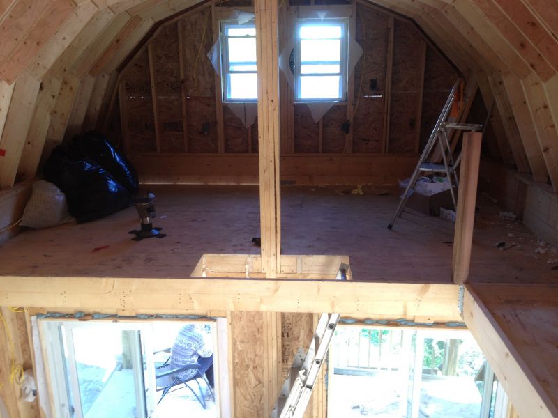

When I designed the cabin I ignored details like "where will the loft stairs go". One thing I was not happy about was the placement of the two patio doors. I centred them on each side but wish that I had pushed them towards the center to make a more complete glass view. However, my wife then asked if we could cut a hatch in the loft and use the space between to run a ladder - brilliant!. Later I'll be building an alternate tread ladder/stair). We then needed to figure out where to put the kids loft ladder. Any ladder in a small space takes up valuable room. My wife then said "what about a catwalk?". Brilliant! So this weekend I framed in a deck (no decking yet (used some extra plywood to allow us to 'get the feel' for it). I then built a catwalk between the lofts and started on guardrails. Notice that my wife has these brilliant ideas and then I do the work while she enjoys the view from the deck!.
Hatch into main loft

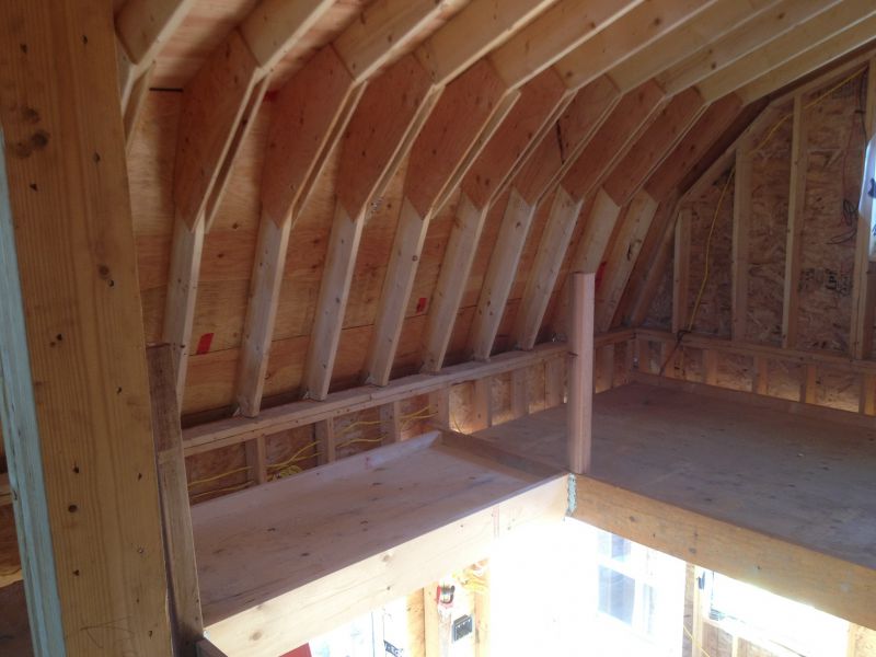

Catwalk
Catwalk

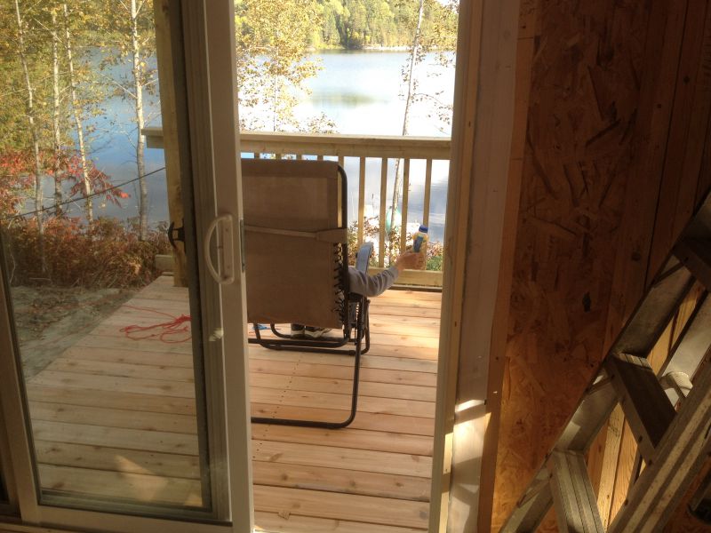

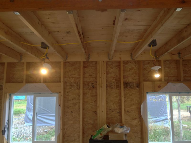

Spent the weekend at the cabin with just my 9 year old son. We put the cedar decking on the deck, enjoyed the view, canoed and then started to set up the wiring for the lights (the setup in the photo is just a test hookup as I needed to move the components from my Popup and put them in the cabin). Friday night Saturday morning was cold (down to just about freezing) with no insulation. I had purchased a large kerosene heater to try and it put out an amazing amount of heat. I would not use it unattended nor when sleeping although I do have a CO detector but it was great starting it up in the morning to take the chill off.
My son imitating his mother
Sunset on the way
Sunset on the way
We have lights!
We have lights!
