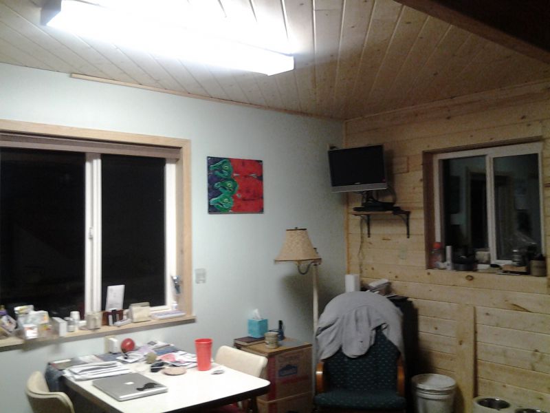

This is downstairs progress from this week.
downstairs t&g
downstairs t&g
diagonal ceiling, sheetrock wall

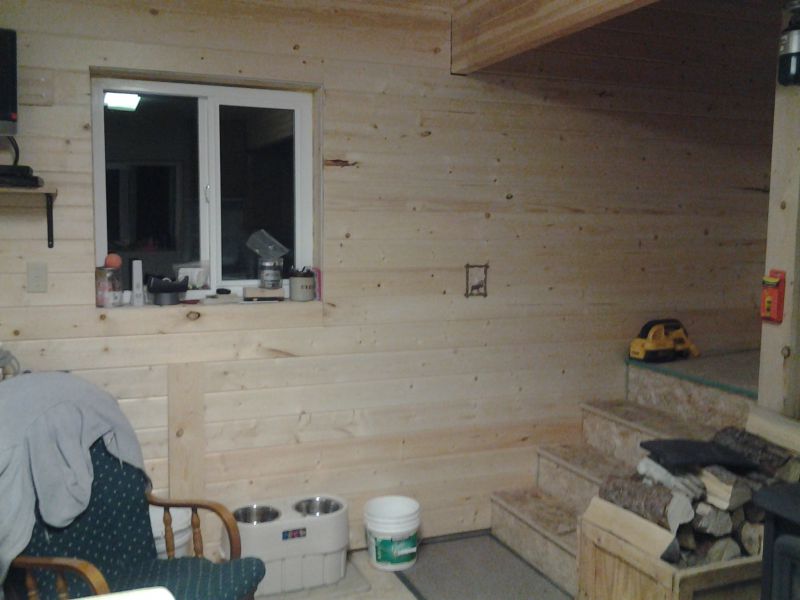

what to do behind the woodstove?

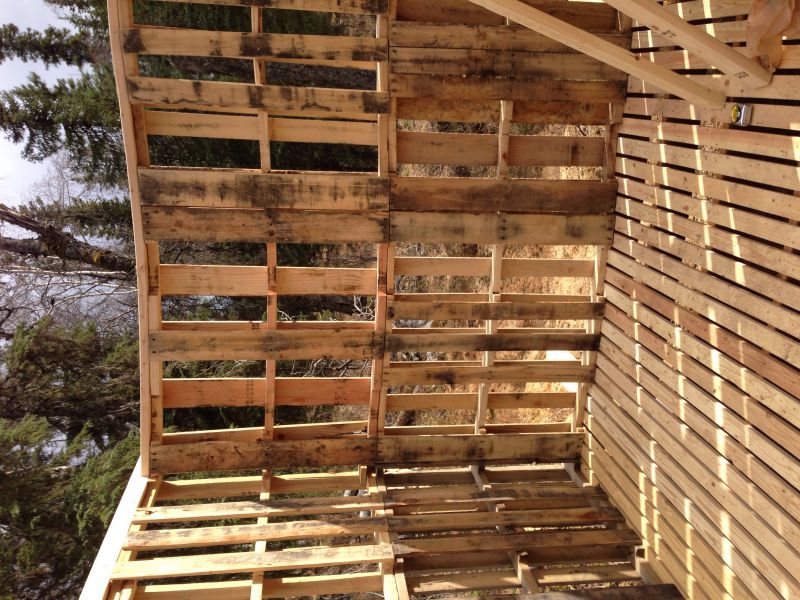

Summer fire came 2 miles away (we had firetrucks lined up on our dirt road for a nailbiter. Did LOTS of emergency firewise with one man and a chainsaw. Got rock in around front of cabin (will put up pics when completed). Woodshed built, it is huge and also houses a summer only washing machine and clothesline. LOVE that. Will post pics soon. Wrong computer right now. Winter coming, so lots of "unseen" work that makes life better in the 10 below times.

Pallet woodshed
Pallet woodshed
