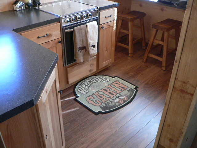

The RV ovens look great, especially in a smaller cabin.
Got mine used for $100. It has a cover for the top to conceal the burners and it give me more storage space too.

Those cabinets are just beautiful. Did you build them yourself? If you did how did you do the frame to support the oven/stove? Wish my stove had one of those covers.

Quoting: camogirl Those cabinets are just beautiful. Did you build them yourself? If you did how did you do the frame to support the oven/stove? Wish my stove had one of those covers.
Thanks camogirl (you like to hunt?) They are custom built. Retailed for about $6500. I have friends in the business, the total cost was about $2300. This includes the overhead cabinets too. All blu motion, made to look 100 yrs old, ie worm holes drilled into it and dings and dents installed. (you can see the holes and dings in the below photo)
The oven is supported on the counter top only. All RV stoves are done this way. Leave a specified gap between the counters on each side of it. The cabinet builder gave me some filler strips. This was to fill the gap on each side of the range (I glued and pinned it with brad nailer) and the under stove drawer also have a filler above it to fit up to the bottom of the stove. Then I notched the counter top (I built the counter myself, much easier than one thinks)
The counters are made from particle board (its the smoothest/flattest) and you want to install wood glue over the exposed end grain where the cut out is. If you dont, water can get under the stove from wiping the counters and swell up the particle board. This seals it from water. Same for the back area against the wall, even if you have a back-splash in place. To the far right of the overhanging cabinet is another filler strip to move the cabinet away from the wall about 1.5 inches or the cabinet being flush would now allow the door near the wall to open properly. Also pinned and glued to the cabinet itself. Install was a breeze, but I had a perfectly plumb and level floor/walls.

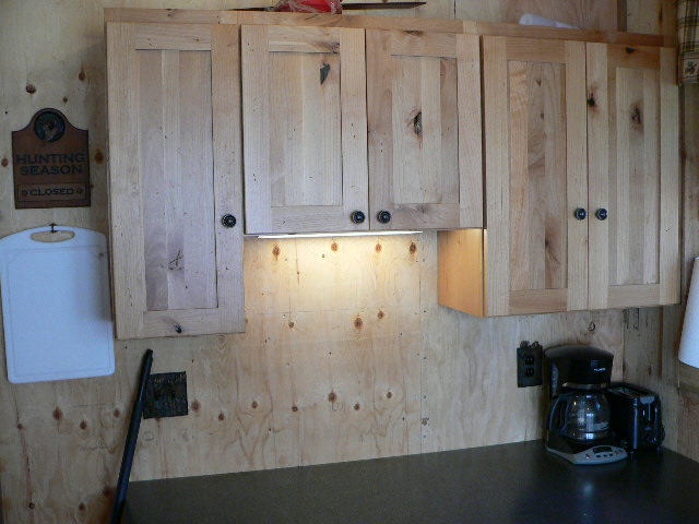

Here is a photo of another angle, the area where the under cabinet light is will eventually be a sink.

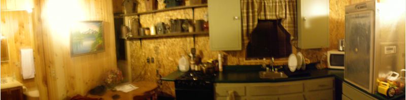

Here is my kitchen.I have an RV stove and frig.It's not finished yet but functional.

rayyy Your kitchen is looking good also. Can't wait until spring to start our cabin. Started a folder with pictures, floor plans and ideas.
