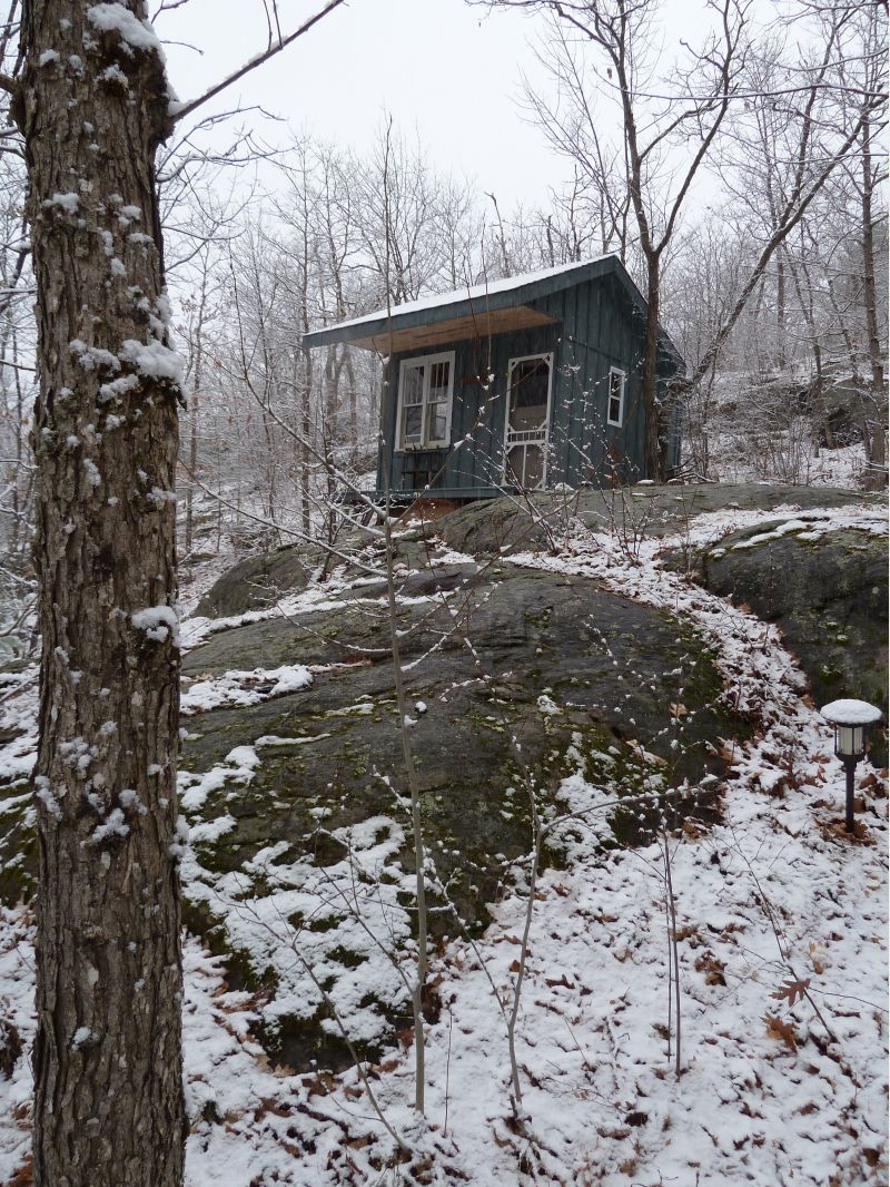

Hello All
Like many others on this forum we have been inspired by all the great stories told here and want to pay back with our own.
We purchased a lake front lot 1 year ago and we are in the process of designing our cottage. While that process happens we have been enjoying the lake in our bunkie, a 100sf cabin.
We are water access, off grid and loving it!

Nothing like building on bedrock, eh? Breathtaking scenery.

Thanks Montanagirl and Nirky
We built the bunkie on deck blocks resting on the bedrock, no risk of frost!! With the larger cottage we are considering bolting steel supports and building the floor system on them. This would avoid any need to bring in concrete.
Has anyone built on bedrock?

We have also built on bedrock using 18 piers to support the structure. However, we were able to hire much of the preparation. Exposing the bedrock (4-18 inches of rocky soil) and drilling anchor pins (3 each pier). The concrete was hand mixed and poured into 10" sonic tubes.
Yes it was alot of work.

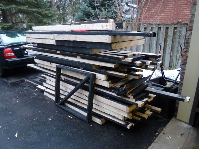

Some good news. we found a bunch of free 2X4s from a local theater that was taking down its sets. looks like enough to build a storage shed by the water. Im going to build it in our driveway and then take it apart for reassembly on site. Cant wait till spring!

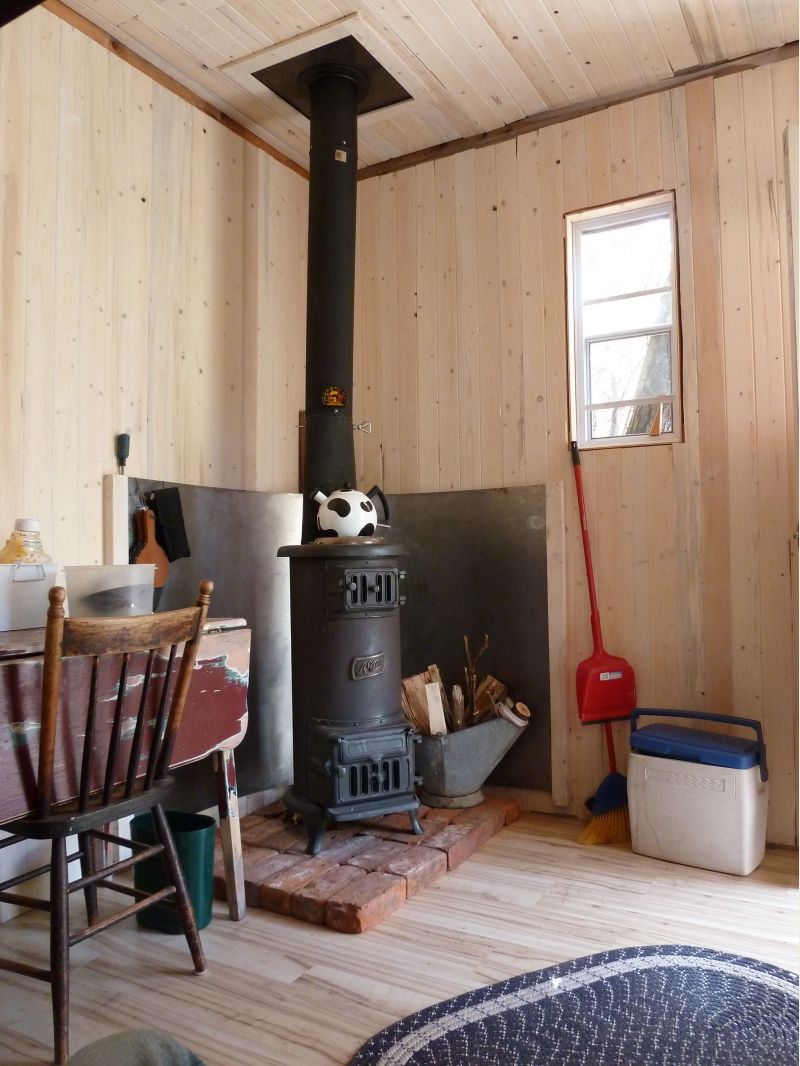

Beautiful location and lake. Love the bunkie and the brick hearth for the stove. Are the bricks set in anything or just loose? Might steal that idea for under the stove at our place in MN.
Ontario lakeside
# Posted: 25 Feb 2013 06:12am
Hey Jaransont3
Thanks, the bricks are loose. I intend to install a wooden curb to hold them in place.
jaransont3
# Posted: 25 Feb 2013 07:44am
Thanks for the added info.
Is the floor under the bricks just wood or something flame resistant? Just asking because one concern I would have with the loose brick is a hot ember falling down between them and not knowing about or even getting to it of you do know about.
I might leave the copper sheet I have under the stove now and put the bricks on to of it. Or maybe just set them with mortar and seal it.
I like the idea of a wooden frame for them. A little friendlier surface to stub your toe on than the bricks.
Ontario lakeside
# Posted: 25 Feb 2013 08:03am
We do have a sheet of galvanized steel under the bricks. I may morter them in when i do the edging.
jaransont3
# Posted: 25 Feb 2013 08:08am
Ahh. Good. Great minds think alike.

hello.love your cabin and land.so beautiful.
love your wood stove.can u tell me what the back of the stove is?
we are getting ready to install a woodstove and looking for ideas.thank u.
Ontario lakeside
# Posted: 11 May 2014 11:24pm
Hey cabingal3
Thanks for the kind words. I used a sheet of 3mm thick hot rolled steel behind our stove. It is bent into the corner and held between two wooden cleats. I also put spacers to hold the steel 1/2" from the wall. This reflects the heat into the room and keeps the wood paneling cool. Simple and cheap. I think the steel was about $30
Ontario lakeside
# Posted: 11 May 2014 11:25pm
I forgot to mention. I waxed the steel with automotive wax to prevent rusting.
thank u Ontario lakeside.good to know.
